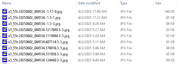

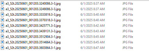

The naming syntax was odd to me, with each file name having a suffix of -1.jpg or -3.jpg:
I'm not quite sure what would cause that. I've opened several of these files and verified that the images are all unique and the time stamp overlay on the image matches the file name.

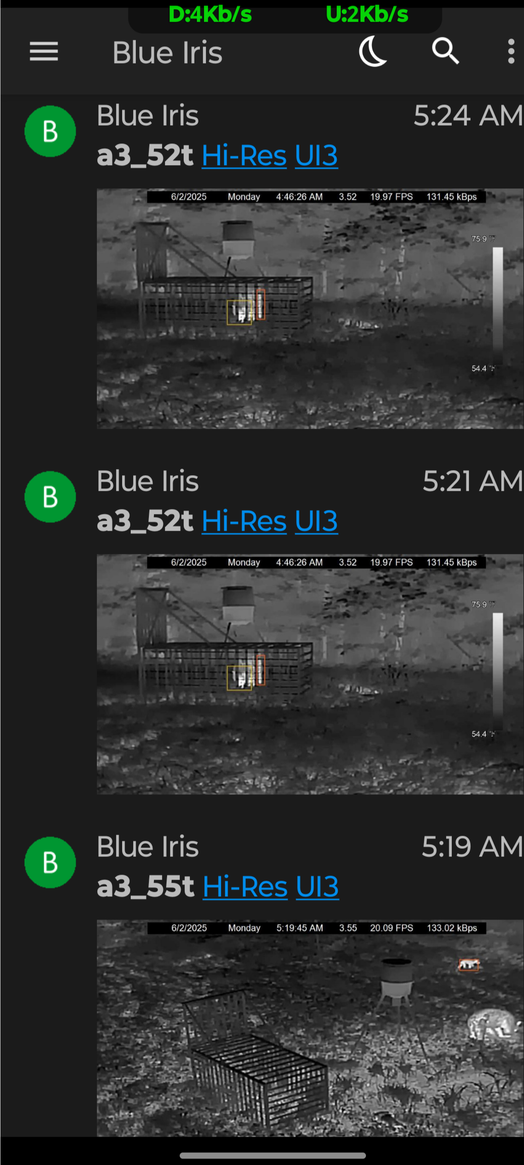

I was hopeful, but alas, it's still doing the same thing....

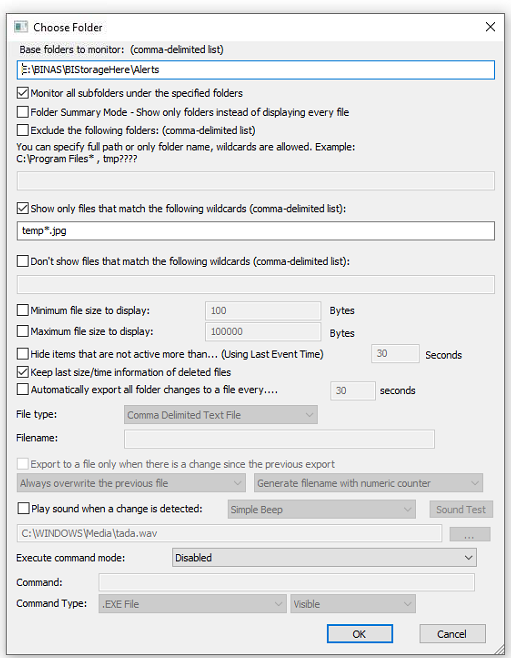

I found a way to monitor this in real time - using NirSoft utility FolderChangesView - see this link for the details.
If I monitor the directory for the given camera when I do a "trigger now", I can immediately see the new file appear in that directory - but it's not a temp. It's the full .jpg file that remains unchanged well after the trigger has resolved.
The top file is the one it created. What's interesting is that the file nomenclature shows *-0.jpg on some, *-1.jpg on another, and *-3.jpg on yet another. I wonder if that suffix is in place of the "temp" name. Either way, the file names do not change - even after a refresh.

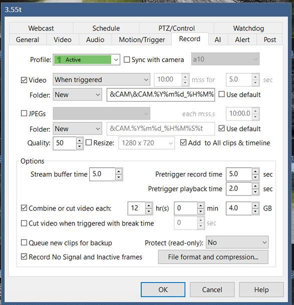

Interestingly, my record tab shows "use default" for the jpg path, yet each image is in it's own camera folder. My video clip path is not default, and I explicitly have &CAM\&CAM.%Y%m%d_%H%M%S. Without the double &CAM, it will put all clips in one directory. So "use default" for jpgs must pull from the custom folder I'm using for video...
