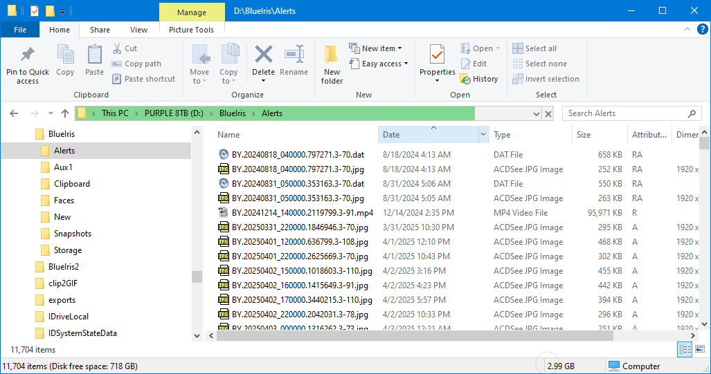

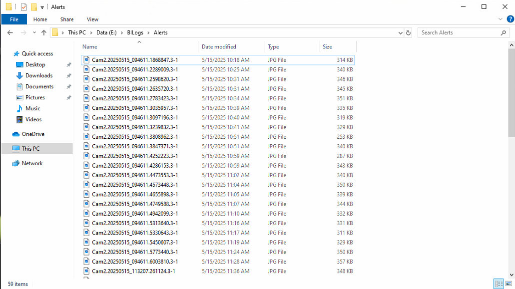

Are you sure about the attachment path? Most users don't use Drive C for clips and alerts storage. Is the path missing any space characters?
Better yet, attach a Windows File Explorer screenshot like this:
Are you sure about the attachment path? Most users don't use Drive C. Is it missing any space characters?

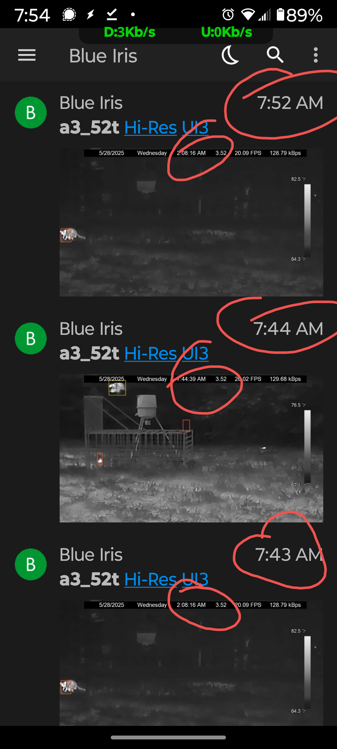

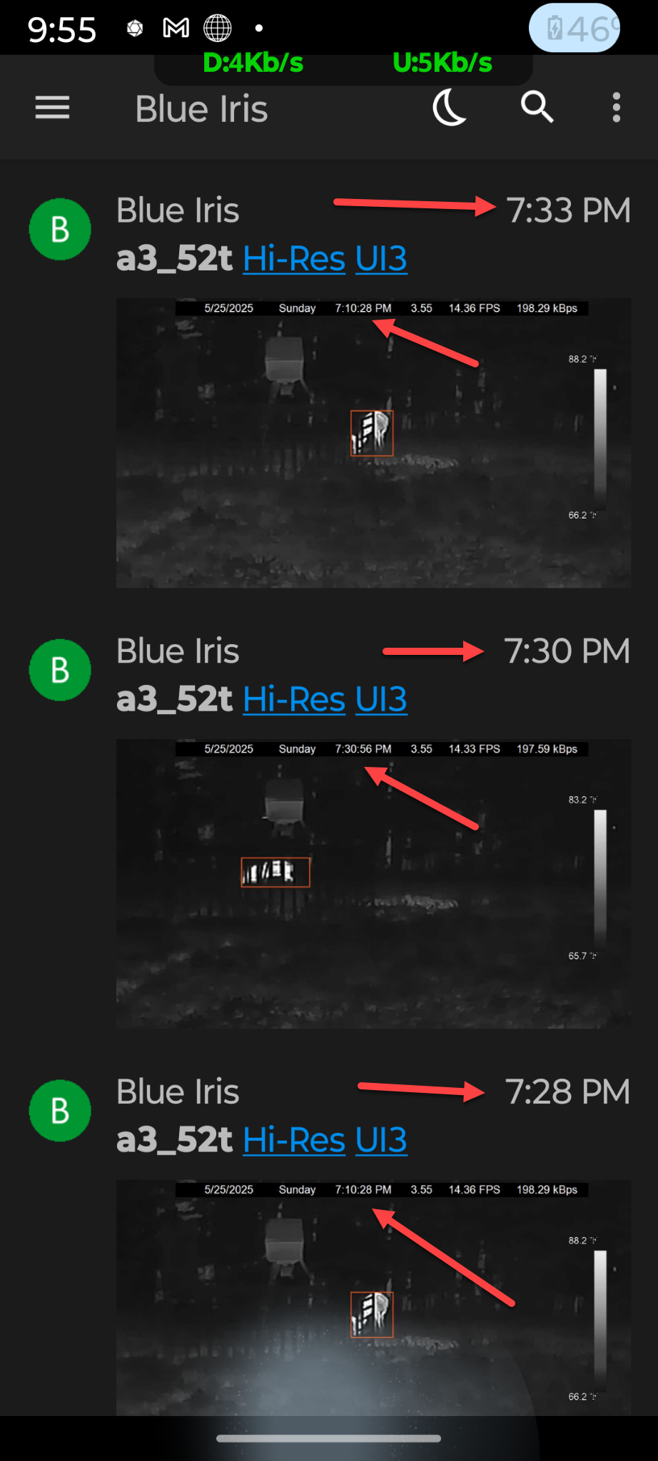

Everything has been working great recently... I get consistent images through pushover using the script. However, over the last few days, i've noticed that the images being sent are not the ones for the triggering event. Instead I'm getting the same static image from hours earlier. What is odd, is that they are not consistent. I might get 3 or 4 images from minutes (or hours) prior, then one or two that are from a current trigger, then the next will be 3 or 4 hours old again.
For example, in the screenshot above, you can see three Pushover time-stamped alerts; 7:28, 7:30, and 7:33. The images, however, reflect 7:10, 7:30, and 7:10, respectively. Something is causing the pushover script to grab images other than the ones that were generated with the actual triggering event.
The result is that most of the images are stale and inaccurate. Has anyone else experienced this? I'm at a loss as to what is causing it. It'd be one thing is they were all the same image, but it seems to get its bearings for a bit, and then revert to the old image.

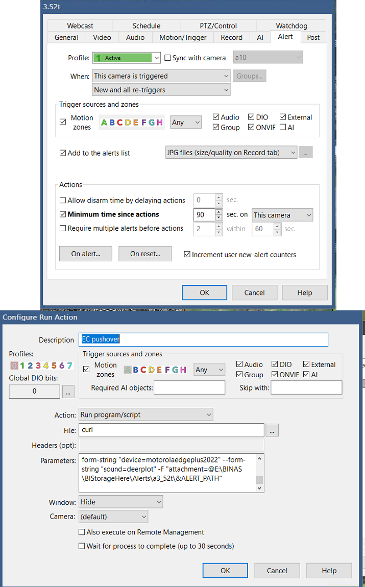

Is there a chance he is sending these from the Trigger tab instead of the Alert tab action set?
Thanks for the effort. No, these are being sent from the alert tab, just as described in your write up...
In fact, I didn't know you could push notifications/emails from the trigger tab.

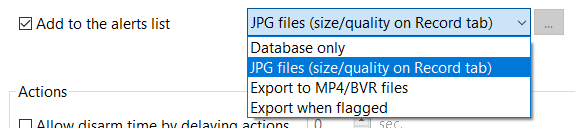

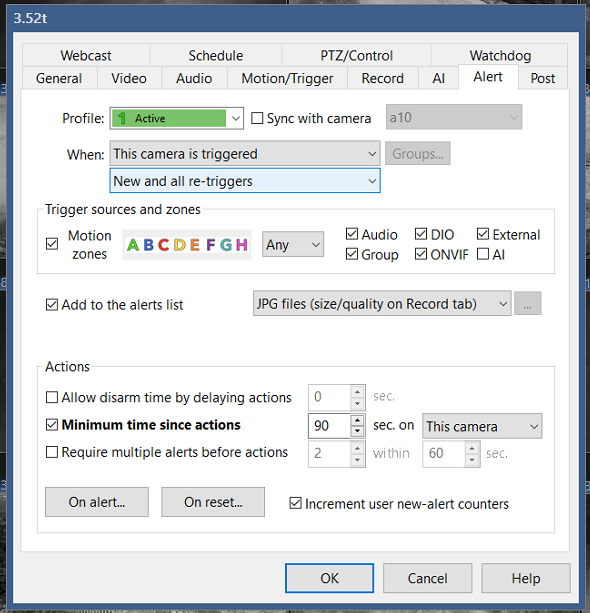

So the question is, are you saving JPGs or AI markup files? If not, Blue Iris creates temp JPGs for use by notifications. These are the TEMP files that Ken is referencing. For details, see here and here and here.
To find out if the TEMP file is being created/used, you can use my msg.exe trick.
Interesting. I ran the msg.exe trick and got the following:
You asked whether I was saving JPG or AI markup files.... I'm not using AI at all, and I've selected to use jpg under the alert tab. If I choose "database" PO won't succeed.
I hate that I need all this hand holding, but can you explain to how to avoid the temp issue if that's what's causing my stale images?
As you are not using AI, then you are doing the right thing on the Alert tab,
Make sure the Alerts folder is allocated at least the minimum in the Settings > Storage tab. Maybe it needs more space? Or blow it out (after stopping the service) and restart.
