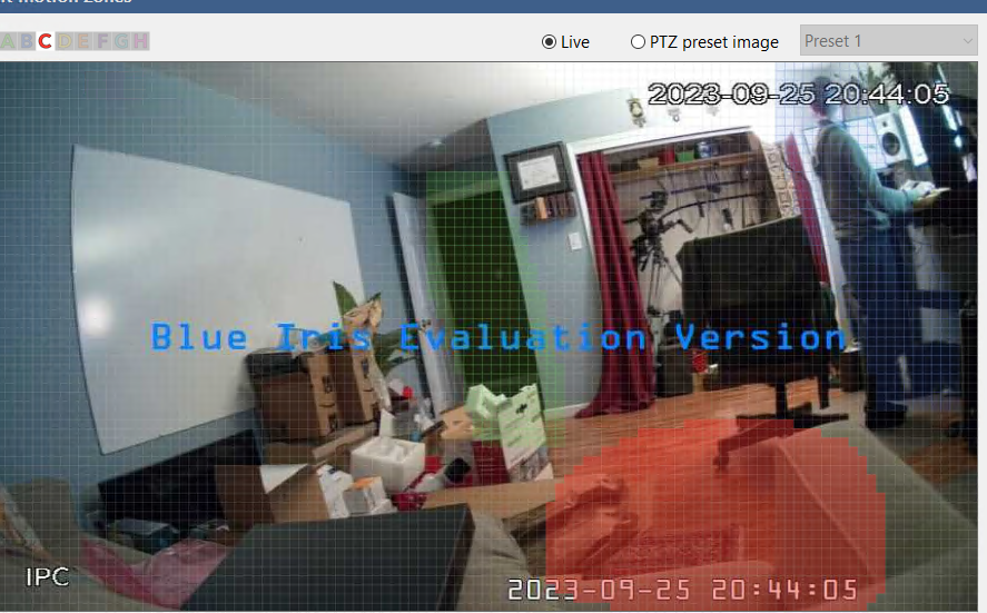

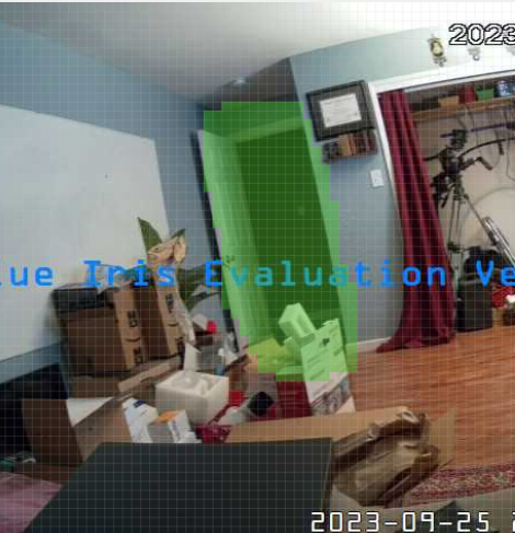

How do you set multiple area of detection within one spotter camera?
I only know this:
And when I try that, the preset to zone binding doesn't stick (here, I set ptz preset image to preset 3 on zone C)
