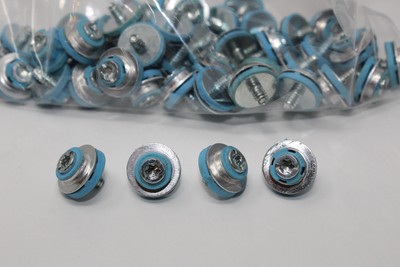

I recently added a 4TB 3.5inch drive to an Elitedesk 800 G4. The biggest pain was that no HDD screws were included inside the case.
The mounting cage required proprietary isolation/spacer style screws to mount the drive. I had to scrounge for something suitable in my spare parts box to make do.
I would suggest you get the proper isolation mounting screws for the HDD. They are inexpensive and can be sourced on ebay from lots of sellers.
Not sure if not having the proper screws leads to premature HDD failure due to vibration, but it's not worth the risk for me.
I bought two sets of four screws from the seller below. They now only have one set left. Says "used" but they were in new condition.
Other posts on this forum showed the source below in China for a lower cost but the lead time appears to be longer. Good luck!
Thanks for posting these links. I may want some of these for my ProDesk that will be arriving at the end of the week. As it appears from the videos I posted here, shows needing what looks like the same screw for 3 5" drives.
I understand from the EliteDesk thread by Fenderman that the M.2 screws are somewhat proprietary too
EDIT NOTE FYI: I ordered these from eBay but they are not correct for my ProDesk's tray, not only are the ones I received not the correct thread size they don't allow the drive to fit the tray when installed. I just ended up using the screws from my shucked 8tb EasyStore. I've always just screwed hard drives in directly so don't really see a problem with that. I think it is possible they sent me screws for a 2.5" drive. But I have just decided to forgo using this proprietary mounting screw for the time being.

Windguy, thanks for the tips on the screws. I've built dozens of PC's and the majority do not have rubber insulation for vibration so that shouldn't be an issue. I'm not sure however if the purpose of those is to insulate against vibration or rather to electrically isolate the drive from the chassis. Doesn't make sense to me.
Understand. My experience has always been to attach a hard drive to the cage using screws that go through the cage or a tray from the side. This HDD cage on this Elitedesk is very different and kind of a neat design. I can see how an IT person would find it easy and fast to maintain. Is the proper screw required? I have no idea but the cost for the set of proper screws was so low it wasn't worth my time to analyze it too much. I figured some engineer(s) at HP spent months doing that and this was the design they came up with. Probably over-engineered but it works for me. Good luck!
Aren’t these types of fittings used simply as the drive installation is tool less, except that you do need a screwdriver to install the grommets onto the drive. All took less PCs have some form bespoke fitting, yes very annoying but done so that they put the words ergonomic onto their fact sheet.
