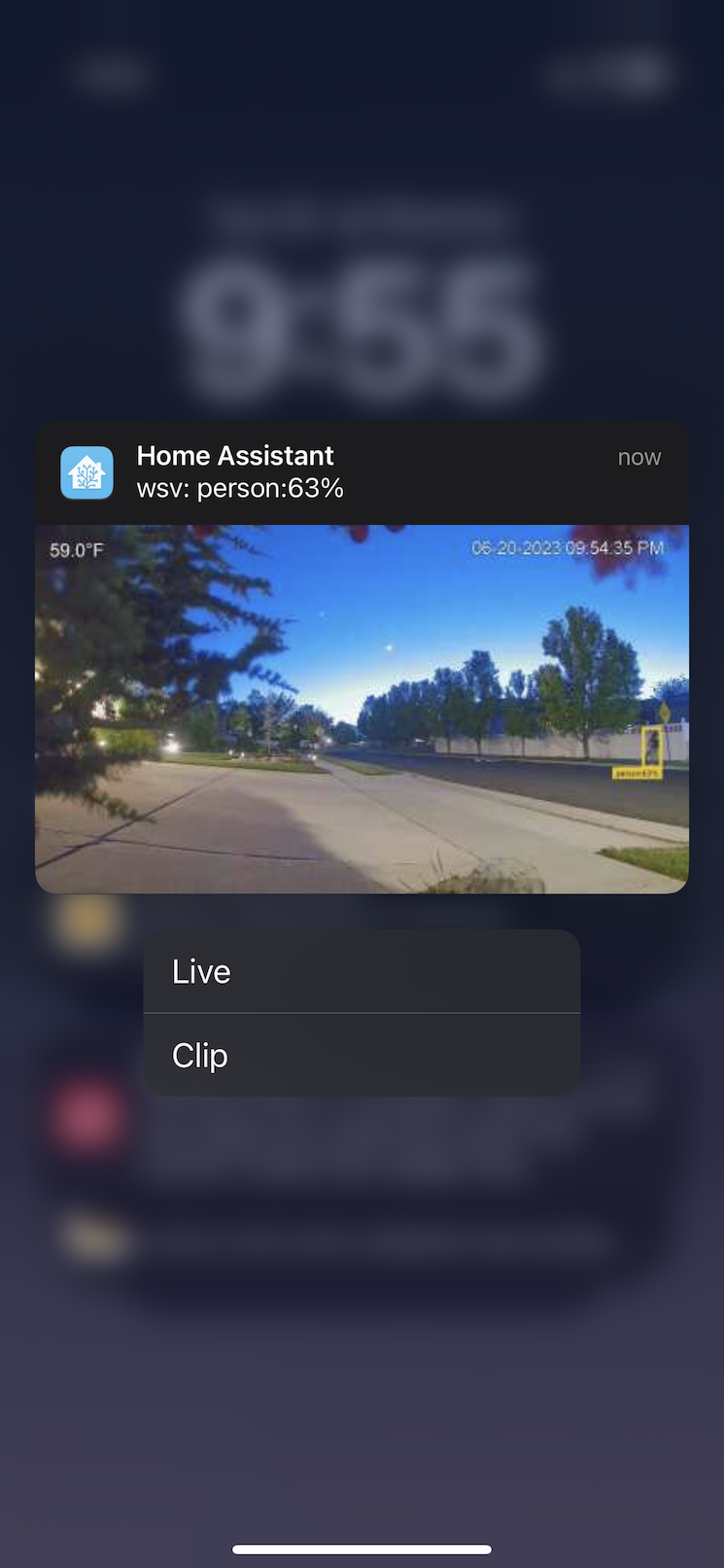

Not sure if you're into home automation, but with Home Assistant you can get notifications that are local. When the notification pops up on your phone you have the option of selecting a live view of the camera or viewing the UI3 alert clip.

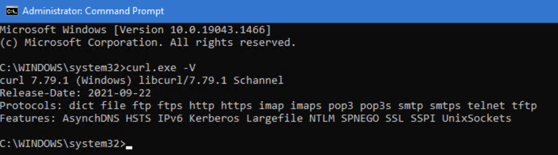

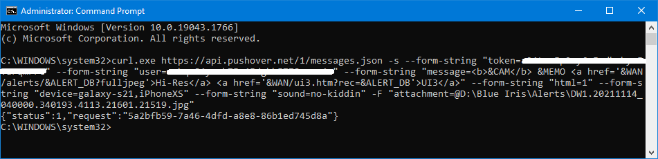

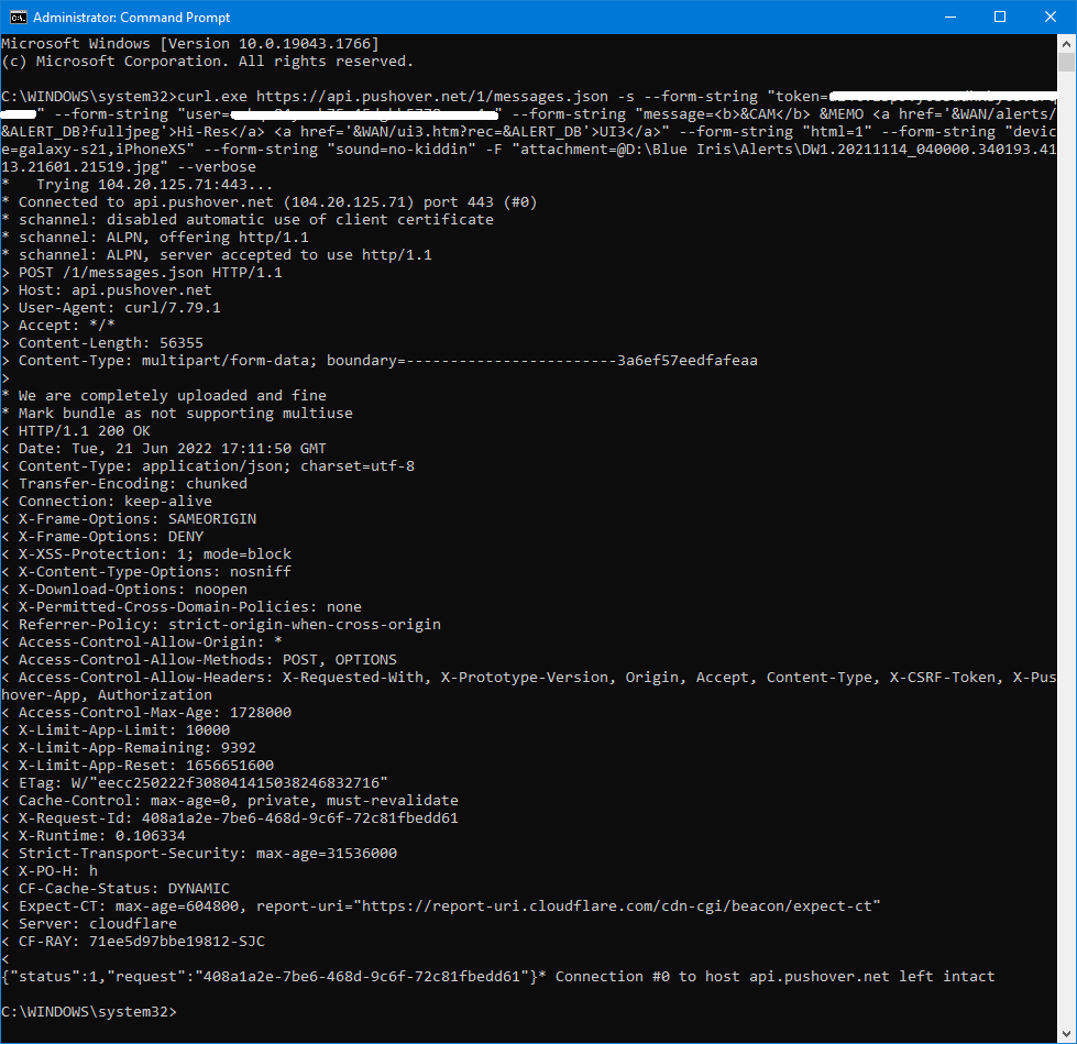

I've figured out how to send Pushover notifications with pictures and hyperlinks from Blue Iris Actions without using external scripts.
This approach uses curl and the Pushover API, and provides functionality similar to that recently described for Telegram <link>.

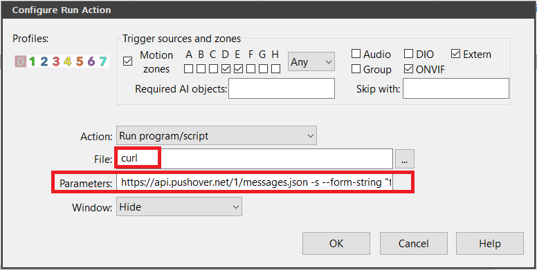

Blue Iris Action setup:
via Camera settings > Alerts tab > 'On alert...' action set
Example 1...

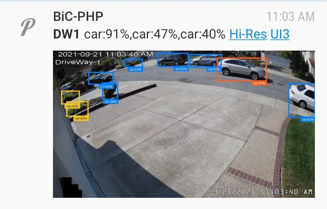

Notification as received in the Pushover App.
Note that this example includes 2 hyperlinks in the message body.
IMPORTANT: The hyperlinks are active only AFTER you touch the notification.
Notification as touched.
  • The 1st hyperlink 'Hi-Res' shows the full-size markup that you can pinch/zoom to read the tiny AI labels.
  • The 2nd hyperlink 'UI3' streams the alert on your device.
Here is the code that you need to enter into the 'Parameters' field for Example 1.
Code:
https://api.pushover.net/1/messages.json -s --form-string "token=YOUR_APP_TOKEN_HERE" --form-string "user=YOUR_USER_KEY_HERE" --form-string "message=<b>&CAM</b> &MEMO <a href='&WAN/alerts/&ALERT_DB?fulljpeg'>Hi-Res</a> <a href='&WAN/ui3.htm?rec=&ALERT_DB'>UI3</a>" --form-string "html=1" --form-string "device=YOUR_PUSHOVER_DEVICE_NAME(S)_HERE" --form-string "sound=YOUR_PUSHOVER_SOUND_HERE" -F "attachment=@D:\BlueIris\Alerts\&ALERT_PATH"
Required & optional edits:
  • You must replace the placeholders YOUR_APP_TOKEN_HERE and YOUR_USER_KEY_HERE.
  • You must edit the 'attachment' string to reflect the actual path to your Blue Iris 'Alerts' folder.
  • Placeholders YOUR_PUSHOVER_DEVICE_NAME(S)_HERE and YOUR_PUSHOVER_SOUND_HERE are optional. Leave as is, or edit them as desired. For the former, you can specify multiple devices using a comma delimiter. Keep in mind that these are devices names as shown in your Pushover account.

To include a UI3 link to stream the alert:
--form-string "url_title=Stream Alert via UI3" --form-string "url=&WAN/ui3.htm?rec=&ALERT_DB&maximize=1"

Testing using the Windows Command Prompt
To verify that curl.exe is installed on your system, type curl.exe -V in a cmd.exe window.
To test your API command syntax before using it in a Blue Iris 'Run a program' action, try sending it directly in a cmd.exe window.
curl.exe https://api.pushover.net/1/messages.json YOUR_ARGUMENTS_HERE
Example:
EDIT (6/21/2022): You can also add add argument --verbose to examine details.

EDIT (1/29/2023) Do not use the Action Set ‘Test’ button (lightning bolt) to test your Pushover ‘Run a Program’ actions. Use real triggers instead, e.g., actually walk in front of the camera... To learn more, read the Help PDF, specifically the section ‘Testing the Action Set’ in the ’Alerts and Actions’ chapter. See also this thread <link>.
Using Blue Iris actions requires that you are not running the Blue Iris service using a LocalSystem account.
To learn more, read the Help PDF, specifically the first section in the Administration chapter.
If you are already running the Blue Service service using a user account, then try these 'tricks':
1. Make sure the macros are resolving when requested from the service <link>, and/or
2. Capture the actual Pushover API command in a *.txt file for inspection <link>.
