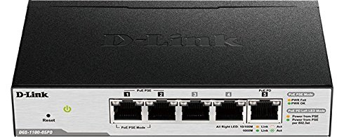

This extender is well-built for the cold, but make sure is not exposed to the elements even a slight bit. I'm surprised major camera manufacturers aren't marketing this. There is one by D-Link, but only supports 2 devices not 4 like this one does. Edit: there is also a similar model by Netgear (I'd avoid these two models at all cost)

Do you have a link to the D-Link one ? I only need 2-ports but didnt know there was one.
Nvm i found it i think. D-Link DPE-302GE. They dont sell it in my country. Pretty expensive also.

@Myllerman, although I posted about D-Link, I only recommend this 1-to-4 PoE Extender, the Netgear and D-Link and Passthrough PoE Switches (which only contain two PoE ports) "suck" big-time. Some may be asking why, the following table (note that both Netgear and D-Link are very similar providing up to 18 watts altogether on both ports when powered from a PoE at PoE switch or injector) explains---
These cameras are all Class 0 devices, meaning that both ports cannot power two cameras at the same time. It's only one or the other.
If anyone is looking to carry four cameras along a single Cat5/6 cable (without having to deploy / run four separate ethernet cables) are strongly encouraged to buy just this 1-to-4 PoE Extender. It does the job very well. Cheers
