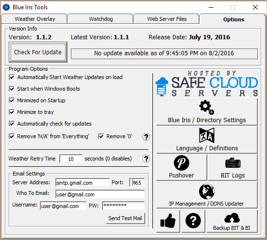

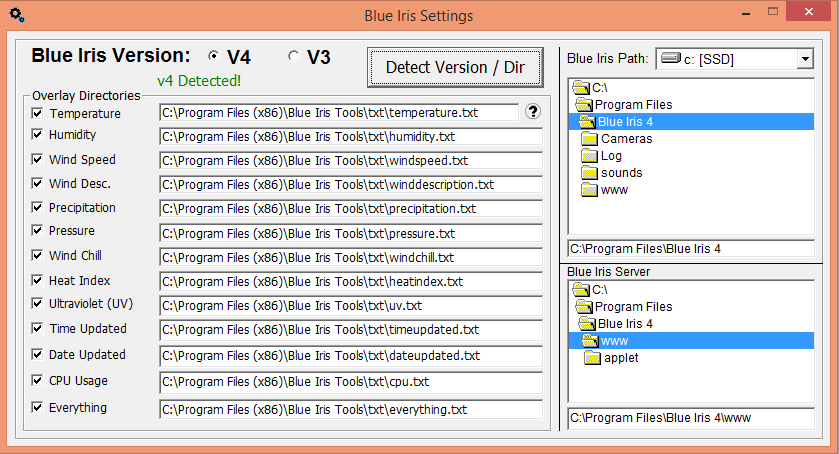

I'm very happy to introduce Blue Iris Tools to everyone. Blue Iris Tools was created to act as a companion to Blue Iris and has a bunch of features built in to help maximize your Blue Iris experience.
Some of the core features of Blue Iris Tools are:

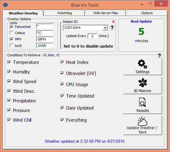

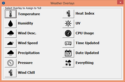

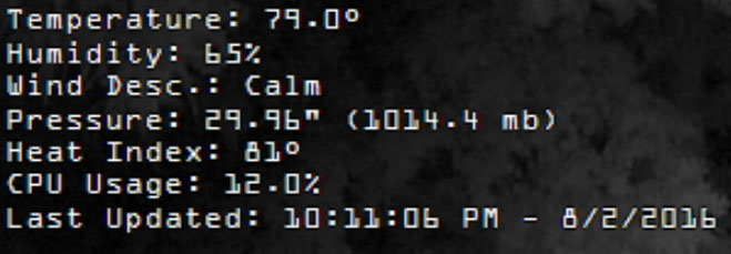

  • Weather Overlays
    • Easily add the local weather to your camera feeds,

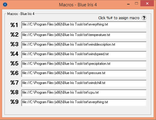

    • Easily create Macros for Blue Iris right from BI Tools,
    • Ability to assign all weather conditions to 1 Macro!
    • Retrieve & overlay weather from multiple locations

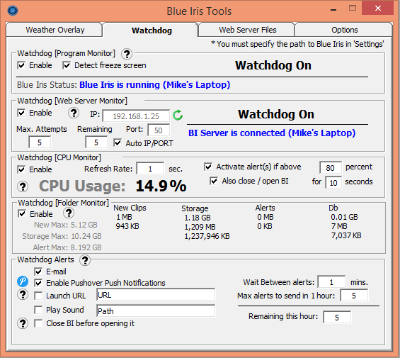

  • Watchdog
    • If Blue Iris crashes or closes, BI Tools will re-open it
    • Monitor Blue Iris (whether running 'normal' or as a service)
    • Monitor Blue Iris' web server. If BIT cannot connect, activate alerts
    • CPU monitor + CPU Overlay
    • BI folders monitor
    • IP Address monitor (notify if change)
    • Notifications - Get notified if BI crashes via e-mail, push notifications via Pushover (download BIT icon here), by playing a sound, pinging / launching a URL.

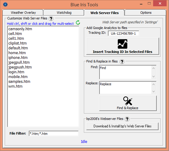

  • Web Server File Management
    • Insert Google Analytics into web server files easily,
    • Search & Replace in web server files - manually or automatically

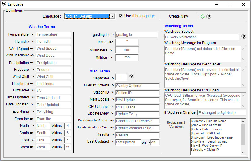

  • Language
    • Create and import custom language phrases and definitions. Language files are available in the 2nd post of this thread. If you created your own, please share it!
    • Click here to download or share language files

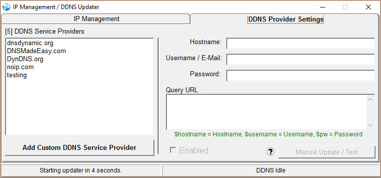

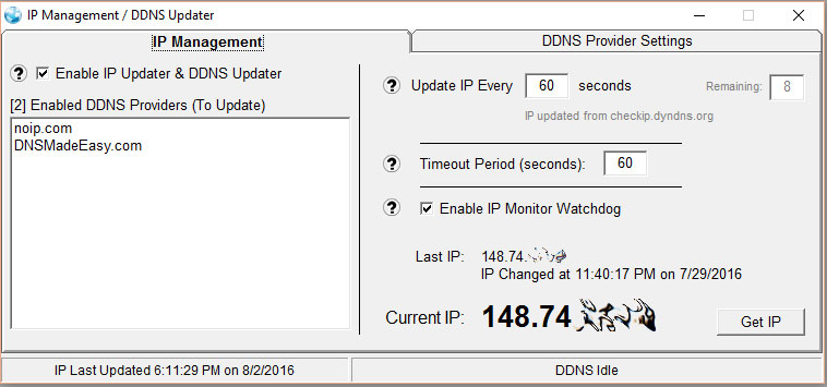

  • DDNS Updater & IP Management
    • Automatically update DDNS providers when your IP address changes
    • Integrated with IPCT DDNS. Our free DDNS solution.

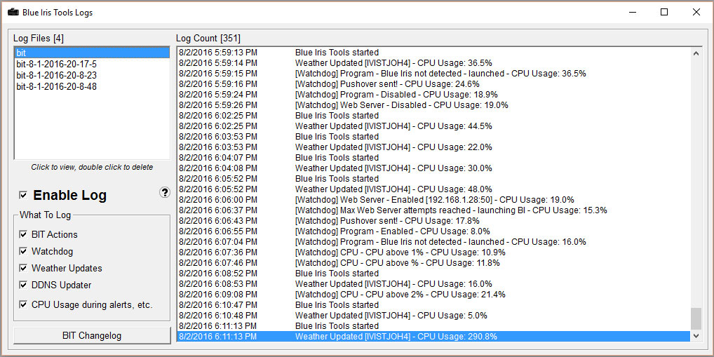

  • Log
    • Log all BIT related actions (BIT open / close, etc.)
    • Watchdog (Anytime the Watchdog is triggered - if BI is closed, etc.)
    • Weather Updates (anytime the weather is updated)
    • DDNS Updater (when your IP changes, etc.)
    • CPU Usage (log CPU usage during alerts, etc.)
    • Overlay IP address on camera

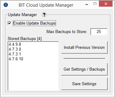

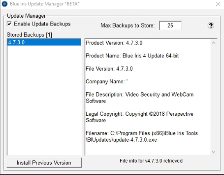

  • BI Update Manager
    • Keep previous versions of Blue Iris
    • Easily restore previous BI versions

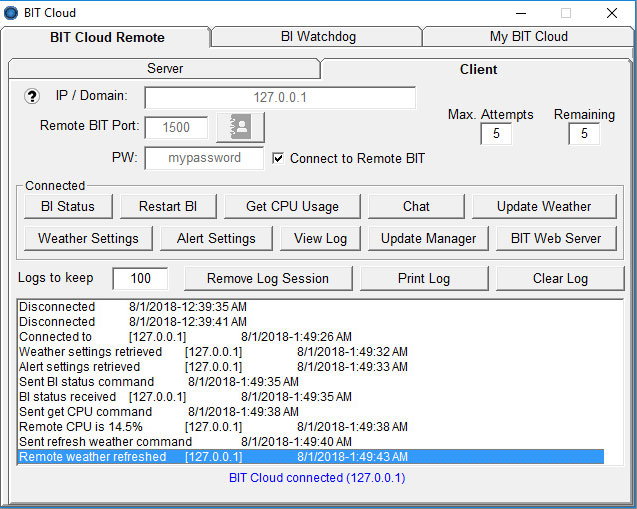

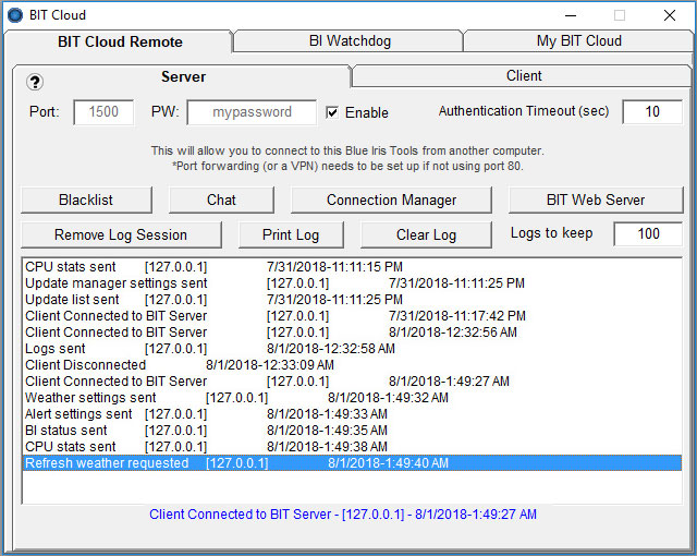

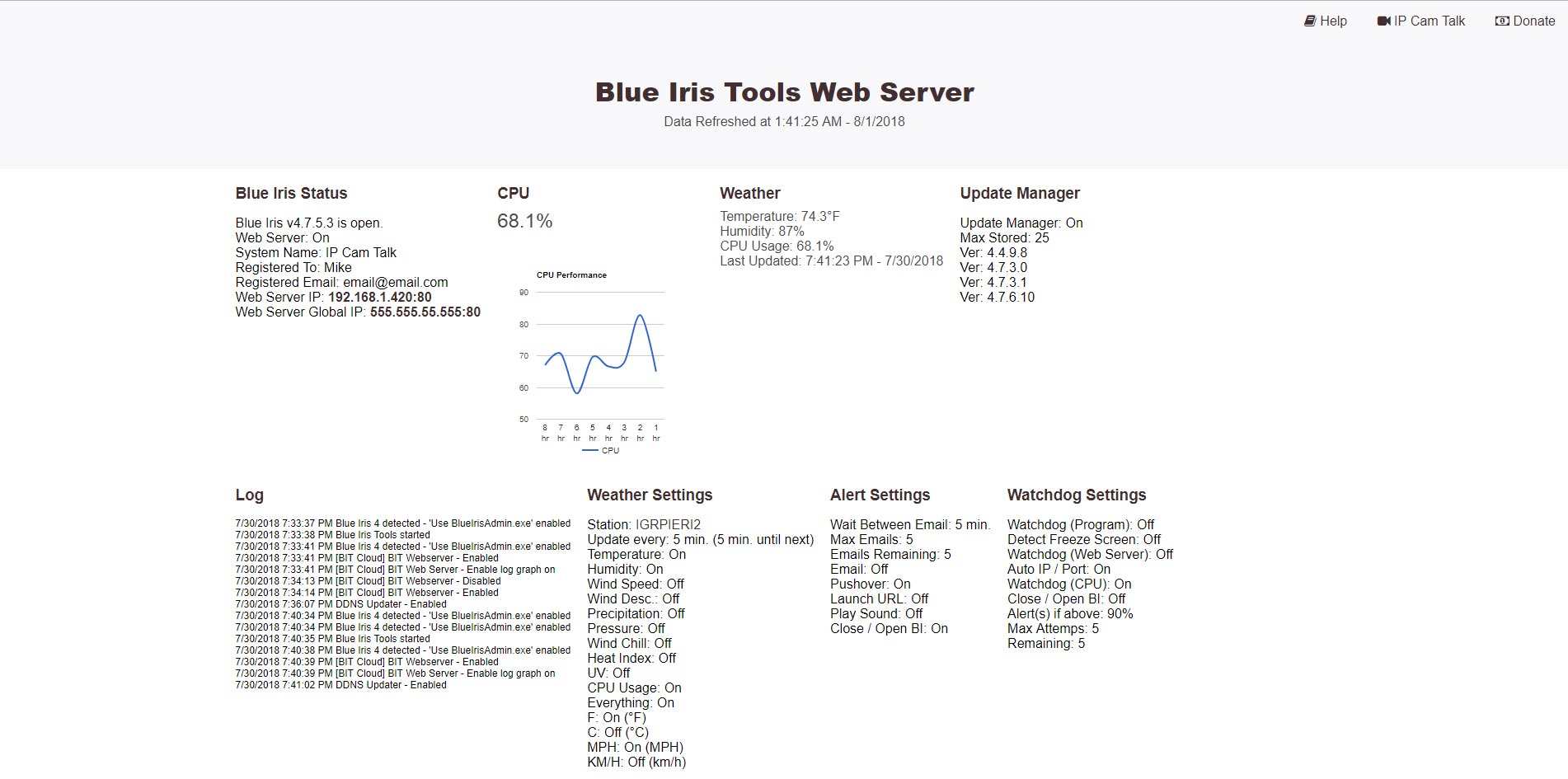

  • BIT Cloud
    • BIT Cloud Remote - Connect to BIT from another remote BIT to view / manage settings and control BIT / BI, etc.
    • BIT Cloud Web Server - A personal website for you to connect to from any browser on any device to check your BIT / BI, including stats, weather, log, cpu, settings, etc.

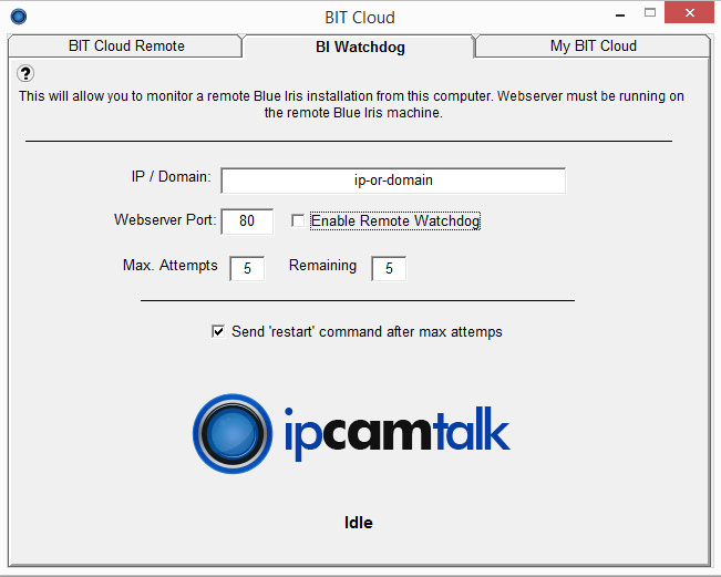

    • BIT Cloud Watchdog - Remotely monitor a BI or BIT install - with watchdog alerts.

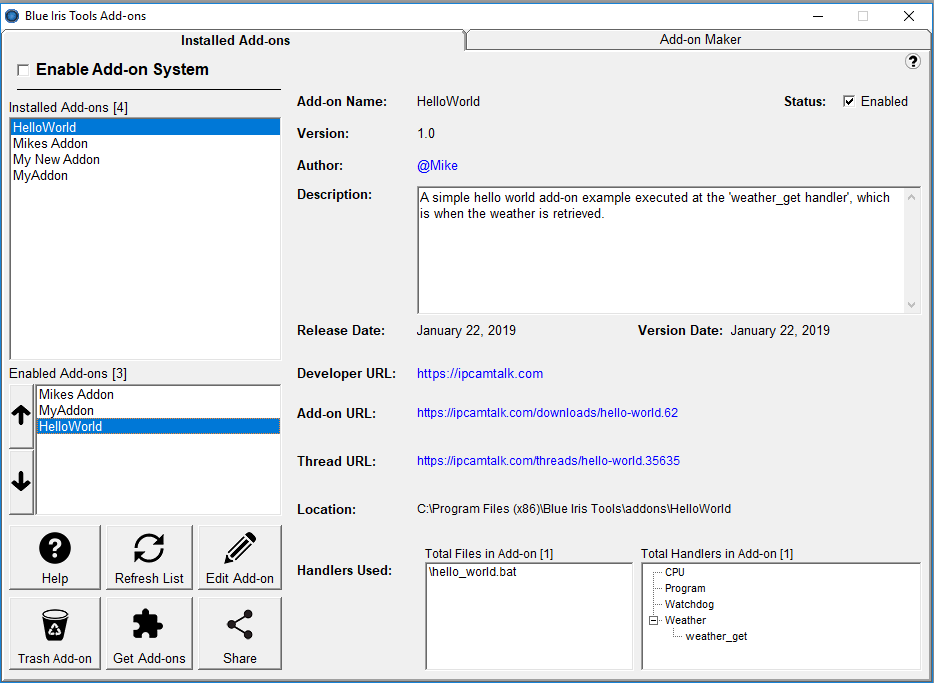

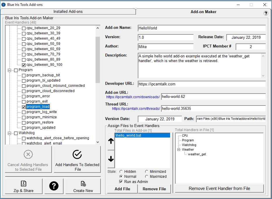

  • Add-ons
    • Create your own or install from the community for more control of BI and BIT
    • BIT Event Handlers installed for interaction with BIT & BI
    • View add-ons wiki here
  • Key Manager
    • Easily retrieve your license key from your machine
    • Store other license keys
  • Batch Config Tool (BI4)
    • Update multiple camera's settings at once
BI Tools uses WUnderground to gather the weather. You can find your nearest station here. I plan on adding more weather providers in the future.

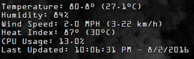

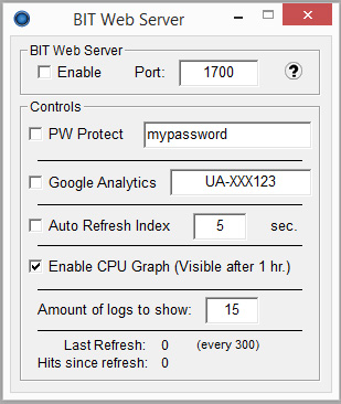

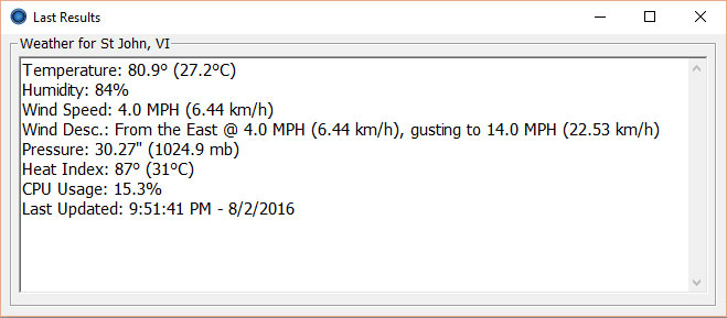

Here are some screenshots of Blue Iris Tools.
View attachment 38291View attachment 38286View attachment 38303View attachment 38294View attachment 38290View attachment 38302View attachment 38304View attachment 38305View attachment 38348 View attachment 38350View attachment 38299View attachment 38298View attachment 38301View attachment 38285View attachment 38306View attachment 38295View attachment 38296View attachment 38297View attachment 38300View attachment 38292View attachment 38293

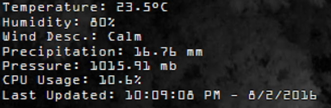

Here are a few examples of the weather on your video feeds. You can select which conditions to show, what units to display and more.
View attachment 38287 View attachment 38288 View attachment 38289
I have put together athread to act as a 'help file' or a place that provides details and explanations on how to use the software, what each feature and setting does, etc. If you cannot find the answers you are looking for in the help file then you may ask for support in this thread. Please view the add-ons wiki for information on how to use the add-ons system.
A big thanks to the beta team for helping get BIT where it is! Blue Iris Tools was built by me and is offered for free to everyone. I ask that you don't redistribute the software, rather direct people here to download it. I am not a programmer by trade, I just wanted to put together this software to help out the Blue Iris community. I expect bugs to crop up throughout the early releases but I plan on building and maintaining BI Tools long term, so if you do find bugs or have issues don't worry, whatever it is I will take care of. Just let me know. Please don't hesitate to leave your suggestions or feedback as well. I want to build and expand BI Tools as much as possible and have a lot of really good ideas that will make their way into future releases.
I plan on updating this thread when I release updates and will use it as a centralized location to discuss BI Tools. Please visit this thread for the help file and see the 2nd post in this thread for language files.

If you (the program) can write that value into a text file, then create a macro in BIT to display it.
More info here in Blue Iris Tool Help => Weather Overlay

I then went into Bits, updated one of the macro values to point at my newly created file and placed in the camera overlay and ... viola. success!
