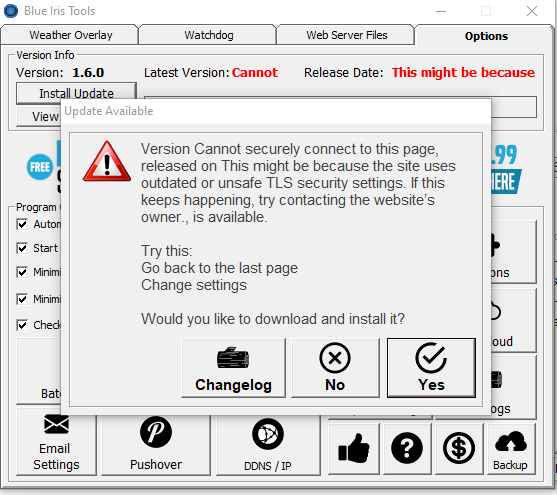

Constantly getting this coming up when I start up bi tools on my windows 10 computer
Go and download it, then it prompts me to do it again and again.
