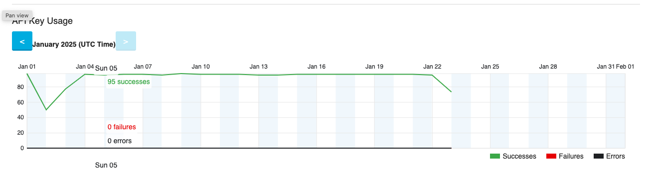

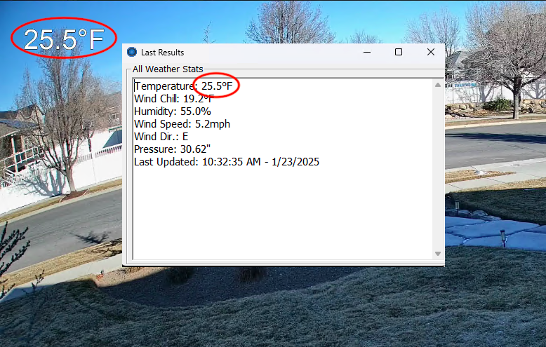

Mine is still working. Do you have a valid API key from Weather Underground?
Reactions: Skinny1

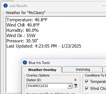

I had several API's in my drop down that used to work. I had been using the same one for a long time. I believe they are valid, as I can access all of them from Wunderground directly. Zip code I'm trying to verify for is 98446, if you feel like checking it out and letting me know. Thank you. -Todd
I just grabbed a random weather station id in that zip code and it appears to be working.
It must be something with my system then that isn't allowing Blue Iris Tools to connect to the internet anymore. Must be blocking it. Thank you for checking that. I appreciate it.
