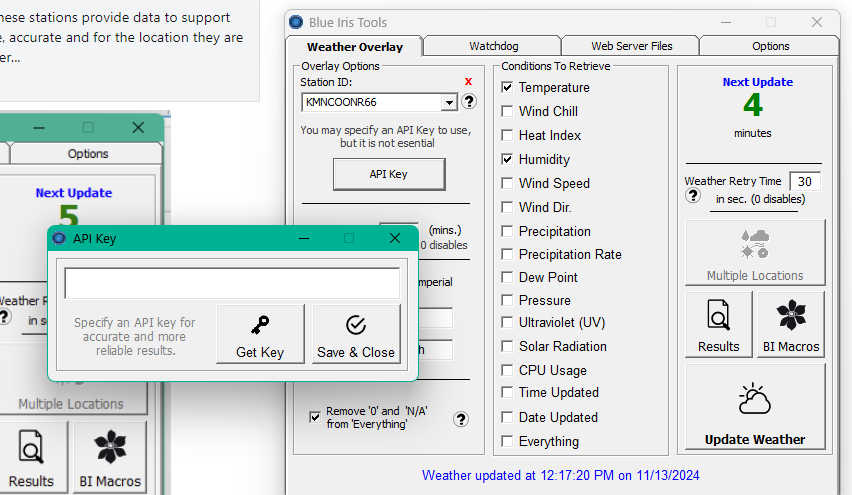

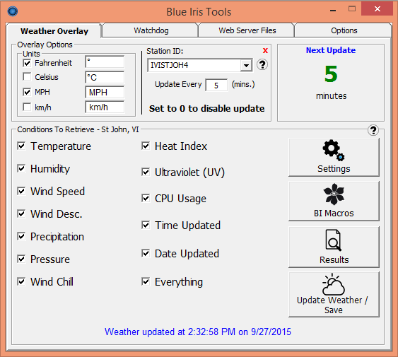

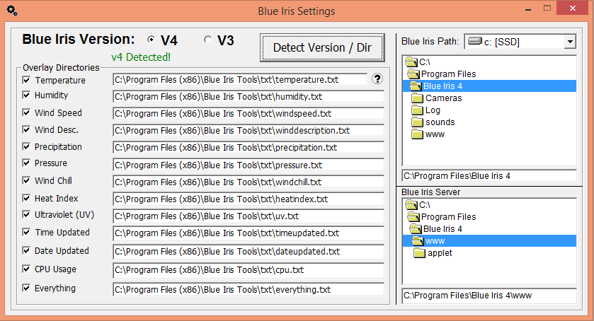

actually correction (sorry), i first installed B iris, i chose import/restore settings... everything looked as was. (and function(ed)s as should - it does show Temp/Hum.. but no value.. which i assume is due to BIT not being able to connect,. then installed BIT... re did options/station Id from prior/working screencaps. And now i'm here 2day
possible something messed up from B iris import settings?

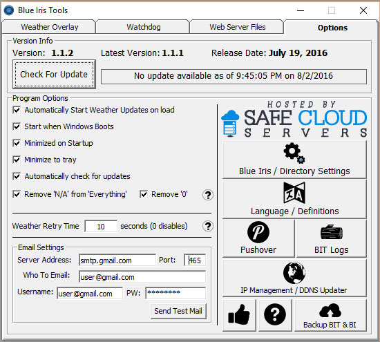

I'm very happy to introduce Blue Iris Tools to everyone. Blue Iris Tools was created to act as a companion to Blue Iris and has a bunch of features built in to help maximize your Blue Iris experience.
Some of the core features of Blue Iris Tools are:

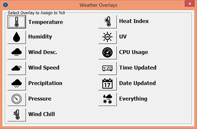

  • Weather Overlays
    • Easily add the local weather to your camera feeds,

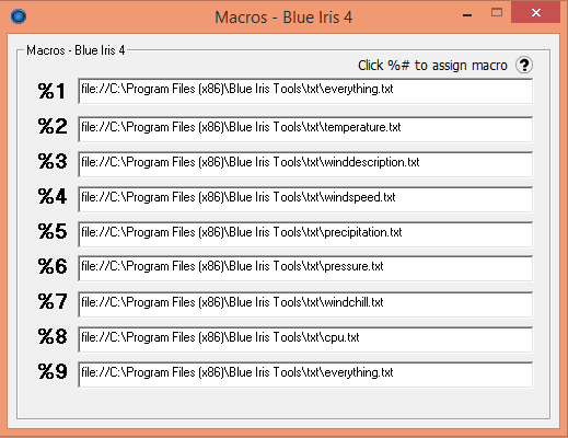

    • Easily create Macros for Blue Iris right from BI Tools,
    • Ability to assign all weather conditions to 1 Macro!
    • Retrieve & overlay weather from multiple locations

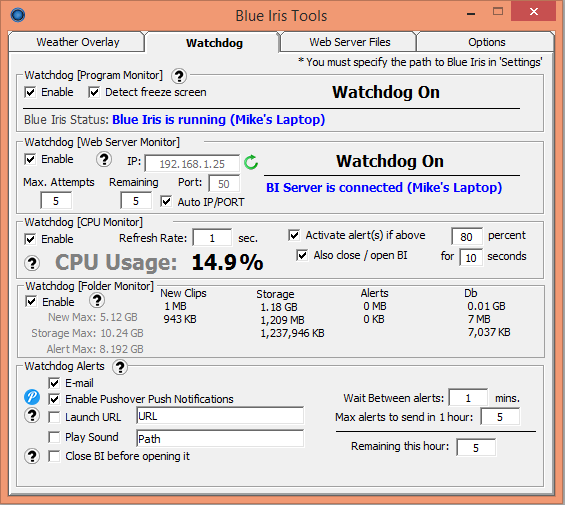

  • Watchdog
    • If Blue Iris crashes or closes, BI Tools will re-open it
    • Monitor Blue Iris (whether running 'normal' or as a service)
    • Monitor Blue Iris' web server. If BIT cannot connect, activate alerts
    • CPU monitor + CPU Overlay
    • BI folders monitor
    • IP Address monitor (notify if change)
    • Notifications - Get notified if BI crashes via e-mail, push notifications via Pushover (download BIT icon here), by playing a sound, pinging / launching a URL.

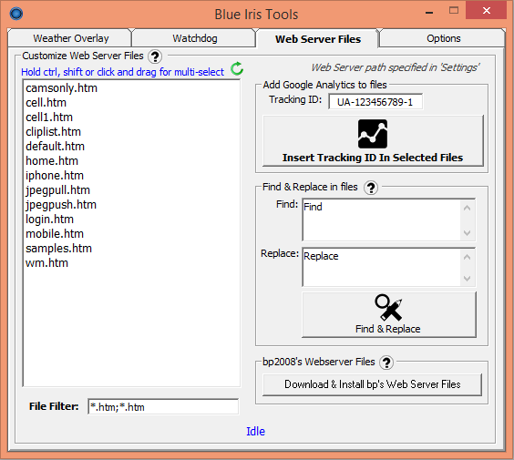

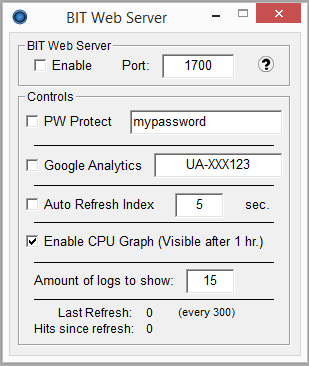

  • Web Server File Management
    • Insert Google Analytics into web server files easily,
    • Search & Replace in web server files - manually or automatically

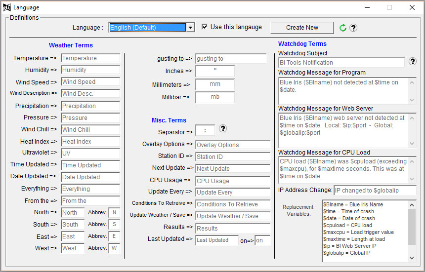

  • Language
    • Create and import custom language phrases and definitions. Language files are available in the 2nd post of this thread. If you created your own, please share it!
    • Click here to download or share language files

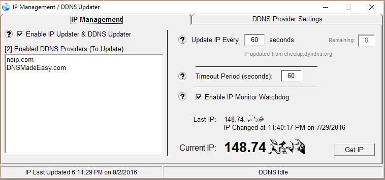

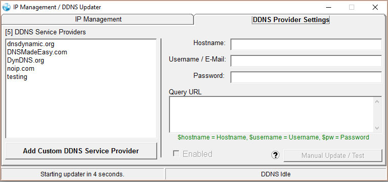

  • DDNS Updater & IP Management
    • Automatically update DDNS providers when your IP address changes
    • Integrated with IPCT DDNS. Our free DDNS solution.

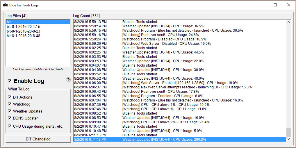

  • Log
    • Log all BIT related actions (BIT open / close, etc.)
    • Watchdog (Anytime the Watchdog is triggered - if BI is closed, etc.)
    • Weather Updates (anytime the weather is updated)
    • DDNS Updater (when your IP changes, etc.)
    • CPU Usage (log CPU usage during alerts, etc.)
    • Overlay IP address on camera

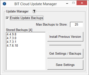

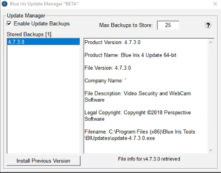

  • BI Update Manager
    • Keep previous versions of Blue Iris
    • Easily restore previous BI versions

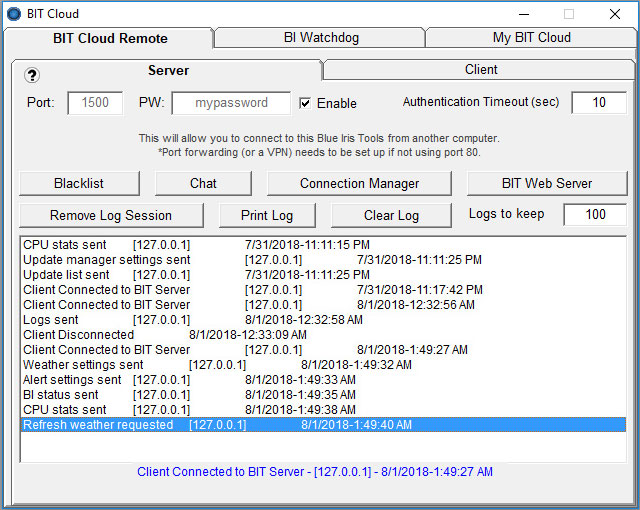

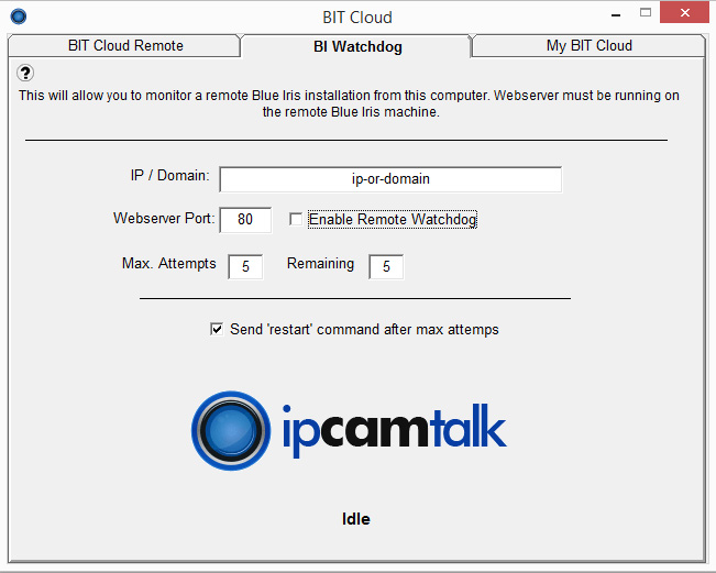

  • BIT Cloud

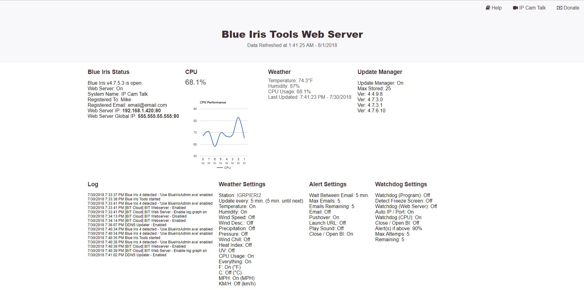

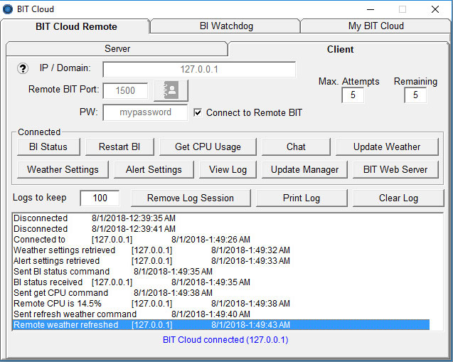

    • BIT Cloud Remote - Connect to BIT from another remote BIT to view / manage settings and control BIT / BI, etc.
    • BIT Cloud Web Server - A personal website for you to connect to from any browser on any device to check your BIT / BI, including stats, weather, log, cpu, settings, etc.
    • BIT Cloud Watchdog - Remotely monitor a BI or BIT install - with watchdog alerts.

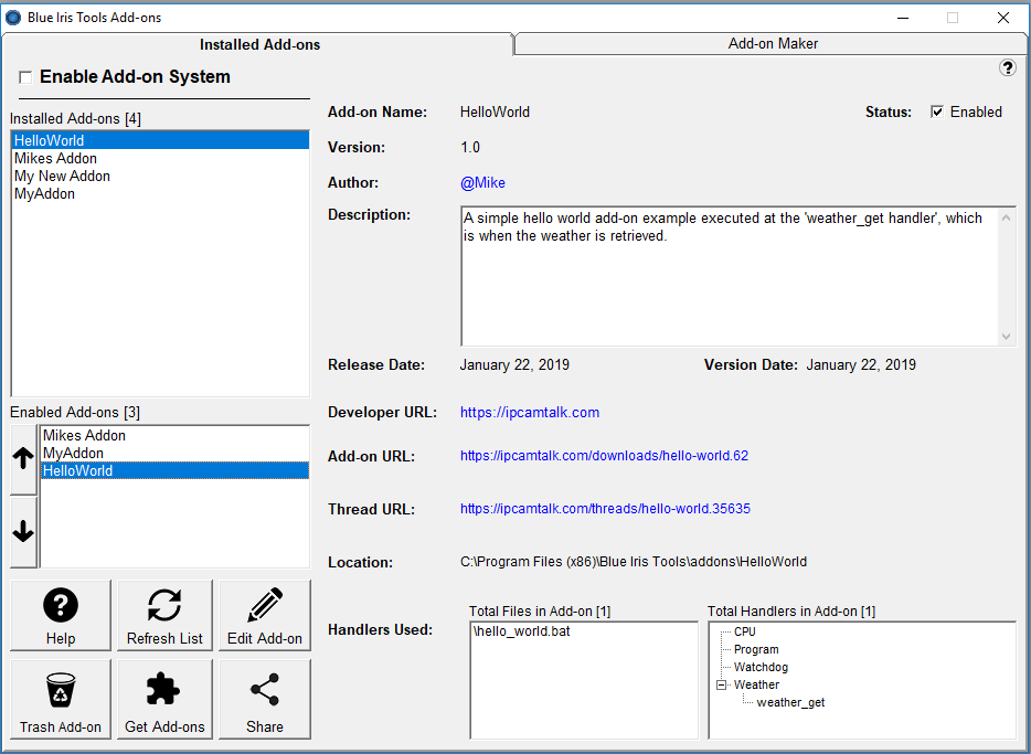

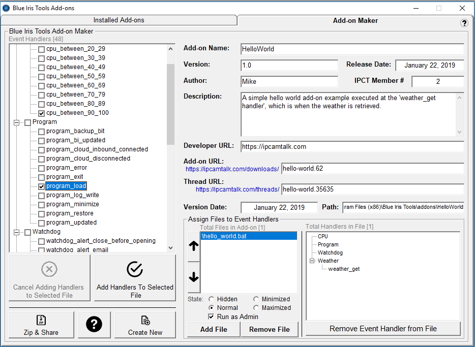

  • Add-ons
    • Create your own or install from the community for more control of BI and BIT
    • BIT Event Handlers installed for interaction with BIT & BI
    • View add-ons wiki here
  • Key Manager
    • Easily retrieve your license key from your machine
    • Store other license keys
  • Batch Config Tool (BI4)
    • Update multiple camera's settings at once
BI Tools uses WUnderground to gather the weather. You can find your nearest station here. I plan on adding more weather providers in the future.
Here are some screenshots of Blue Iris Tools.
View attachment 38291View attachment 38286View attachment 38303View attachment 38294View attachment 38290View attachment 38302View attachment 38304View attachment 38305View attachment 38348 View attachment 38350View attachment 38299View attachment 38298View attachment 38301View attachment 38285View attachment 38306View attachment 38295View attachment 38296View attachment 38297View attachment 38300View attachment 38292View attachment 38293

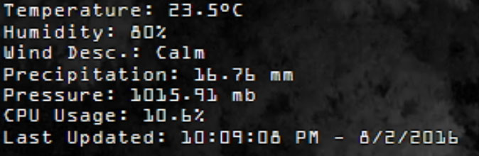

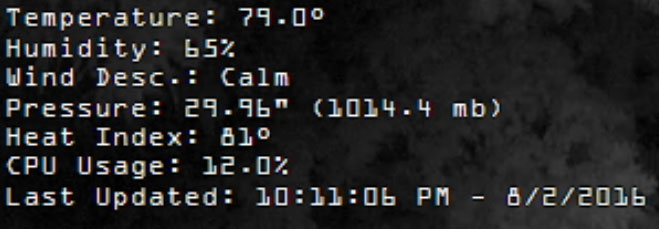

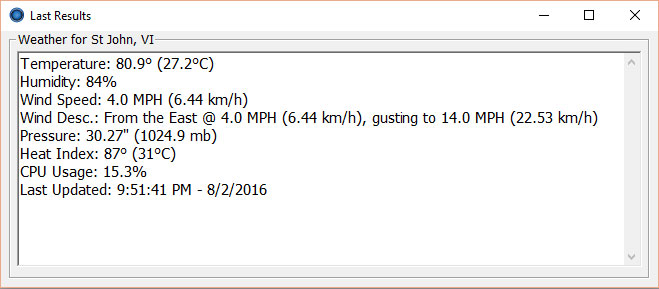

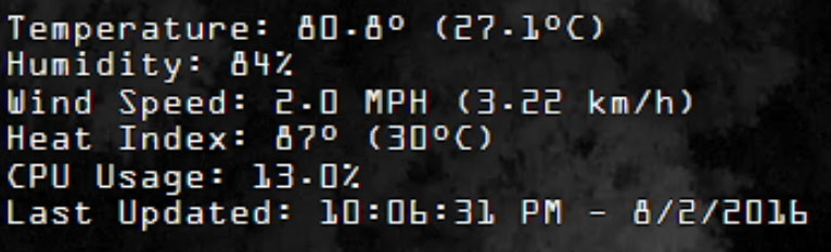

Here are a few examples of the weather on your video feeds. You can select which conditions to show, what units to display and more.
View attachment 38287 View attachment 38288 View attachment 38289

Why on Earth would anyone want to Insert Google Analytics into web server files into their web server files ???????
I am trying to get the weather overlay working and I have all the permissions and the correct weather station its just that you cannot leave the APIKey blank when trying to get it from api.weather.com it complains.
$UrlWU = ""
{"metadata":{"transaction_id":"##############"},"success":false,"errors":[{"error":{"code":"CDN-0001","message":"Invalid apiKey."}}]} is always returned if the APIKey is left blank or wrong.
You cannot get an APIKey now from Weather Undergound anymore. You get the message:
Your API Key​
No API key. You must own a Personal Weather Station in order to generate an API key.
If you click Learn more they want you to spend money to setup your own weather station which i presume gives you an API key. Is there no way to do this for free anymore?
Yikes. I am using KMNCOONR1 from another W underground user. I just tried another nearby station from a google search " weather station IDs Coon Rapids" seems to work.
I have no API key inserted into that box and it works fine.
Use somebody else’s?
You've got something else going on there. It doesn't need an API key. I have two different instances of Blue Iris Tools running on two different computers in two different parts of the country and I logged in and checked both just now, and neither has an API and both update fine. I even changed the weather station to a different one and checked it. It took the change, I forced an update, then verified that the update was correct/current. So keep trouble shooting it because it definitely doesn't need an API key. The only other thing I can think of to test it is to install BIT on another computer, ideally a laptop (that computer doesn't have to have Blue Iris on it) and see if it works. If it does, then it is some issue on your original computer like possibly a firewall setting. If it doesn't work, then if the different computer you installed BIT on has wifi, set your phone up as a hot spot and attach the computer to that and that will allow you to test it outside your network. If that works, then the problem is some setting in your router (which is why it is affecting both computers). I hope that helps.
Reactions: Flintstone61
I would expect that BITS uses port 80 so it can't be a firewall issue. However, if it does require another port, please let me know and I will open that port up to see if its the issue.
