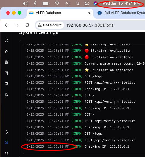

The log file doesn't show anything in regards to missing plates, but I have noticed an issue with the timestamp. It is off by 5 hours.

It definitely does look weird that it’s displayed as 12 hour format when it’s UTC, but I don’t think it’s that important. It’s kind of a complicated stream of things that factor into it. I’m gonna try to work on the rest of the remaining stuff and get things flushed out, with the goal being for people not to need to look at this page very often.
If someone wants to try setting the tz and see if it breaks stuff pls share.

I've tried to set TZ but it doesn't seem to have any effect on anything. The log is still UTC. Are you able to make it change using TZ?

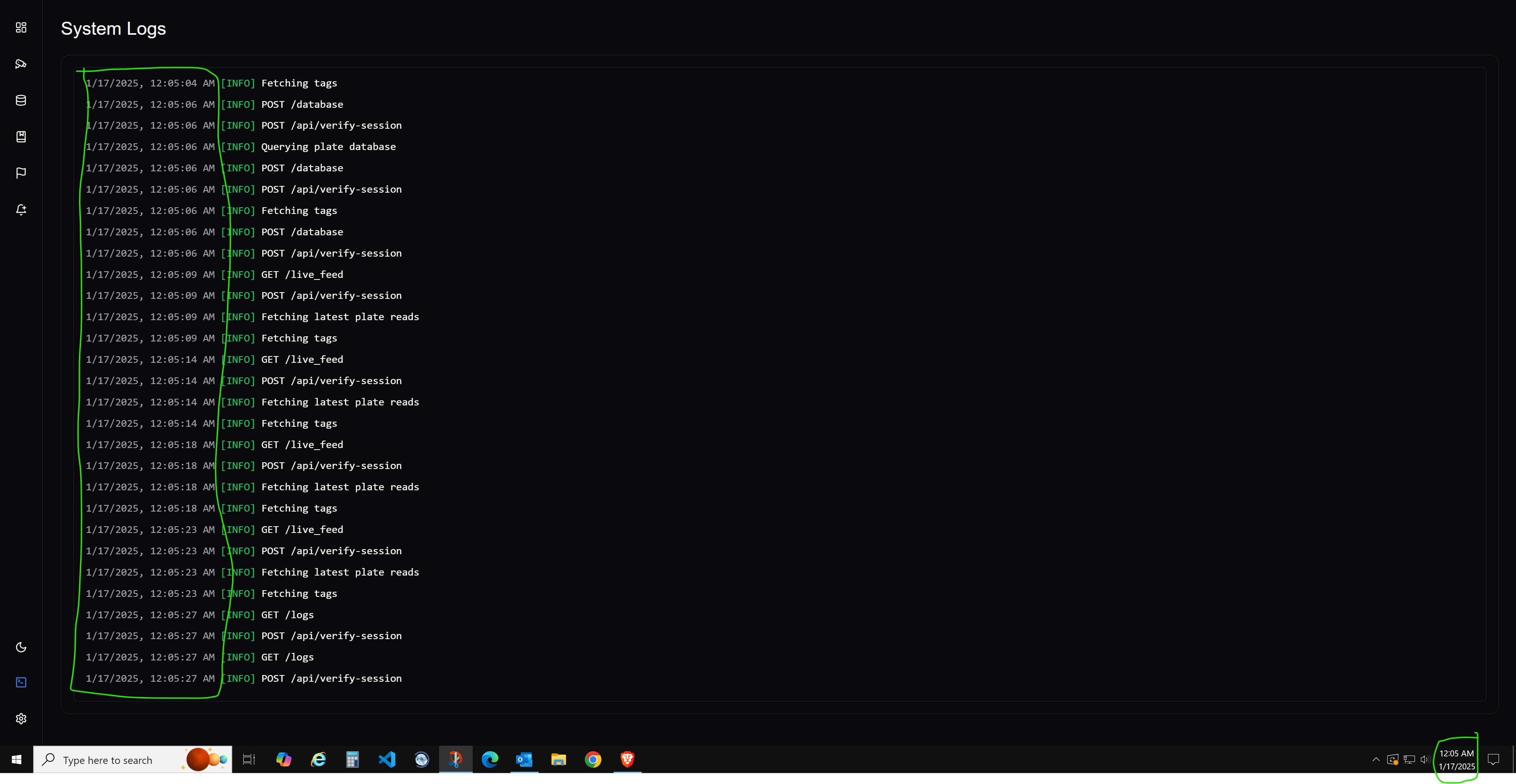

I made the below TZ adds and the time zone is correct in the log.

Is the same as what you guys had, @Vettester @VideoDad?
Did it break anything else?

I had only set the TZ in one section. Once I put it into both sections, then my log has local time. And as far as I can tell, the times elsewhere still seem to be correct without shifting. Thanks!
Completely doesn't make any sense to me how changing the database timezone would now make something that has nothing to do with it work properly. Must be some docker quirk with them being grouped together.
