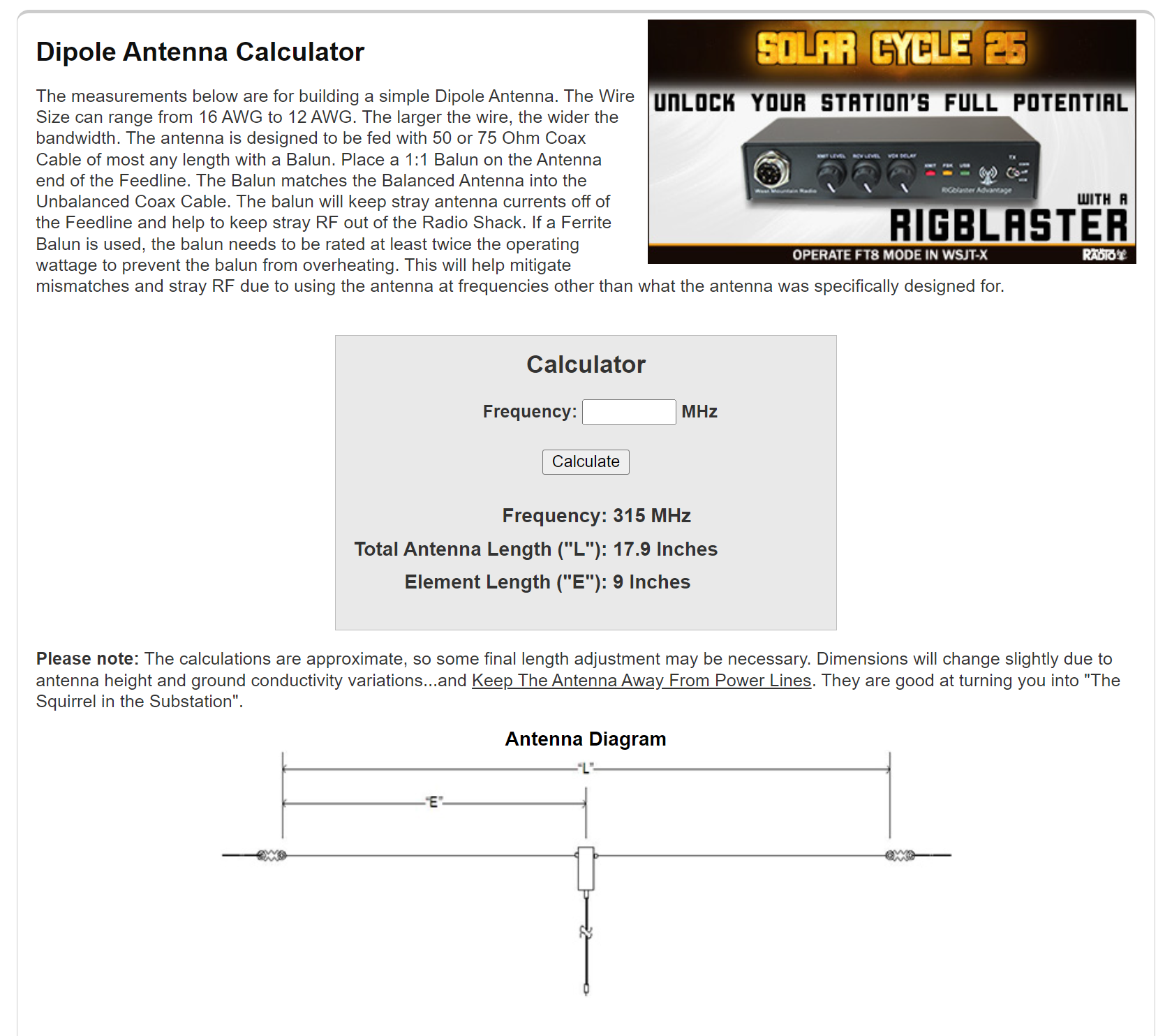

decided to make a half-wave 3' dipole antenna
I think 3' is to big for 315MHz, it should be 17.9"
You’re completely right. I forgot to half it the second time‍ :facepalm:
I’m horrendously inept when it comes to arithmetic and practical math. Calculator comes out for literally anything and often still ends up wrong as we see here. Online antenna calculator would have been a good call.
I’ll chop em down. Great catch and thank you for noticing. Looking at it now, and actually using my brain, I don’t know how I didn’t stop to question that. Just does not compute on its own…

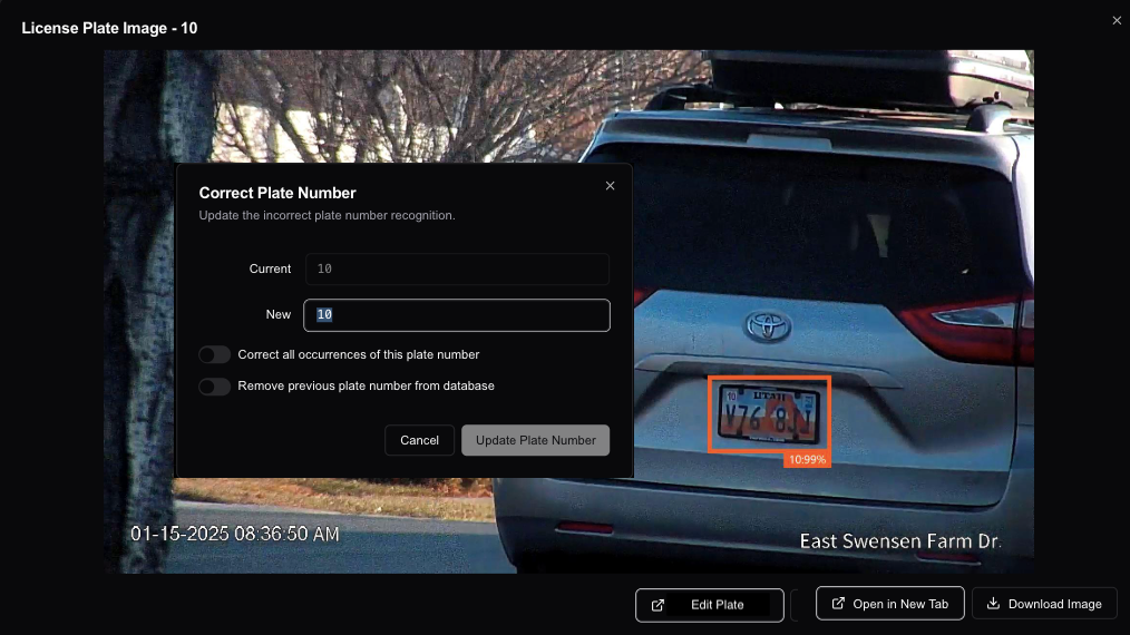

@algertc would it be possible to add an edit option to the license plate image? Something like the mockup below would make it a lot easier to edit a plate number.
