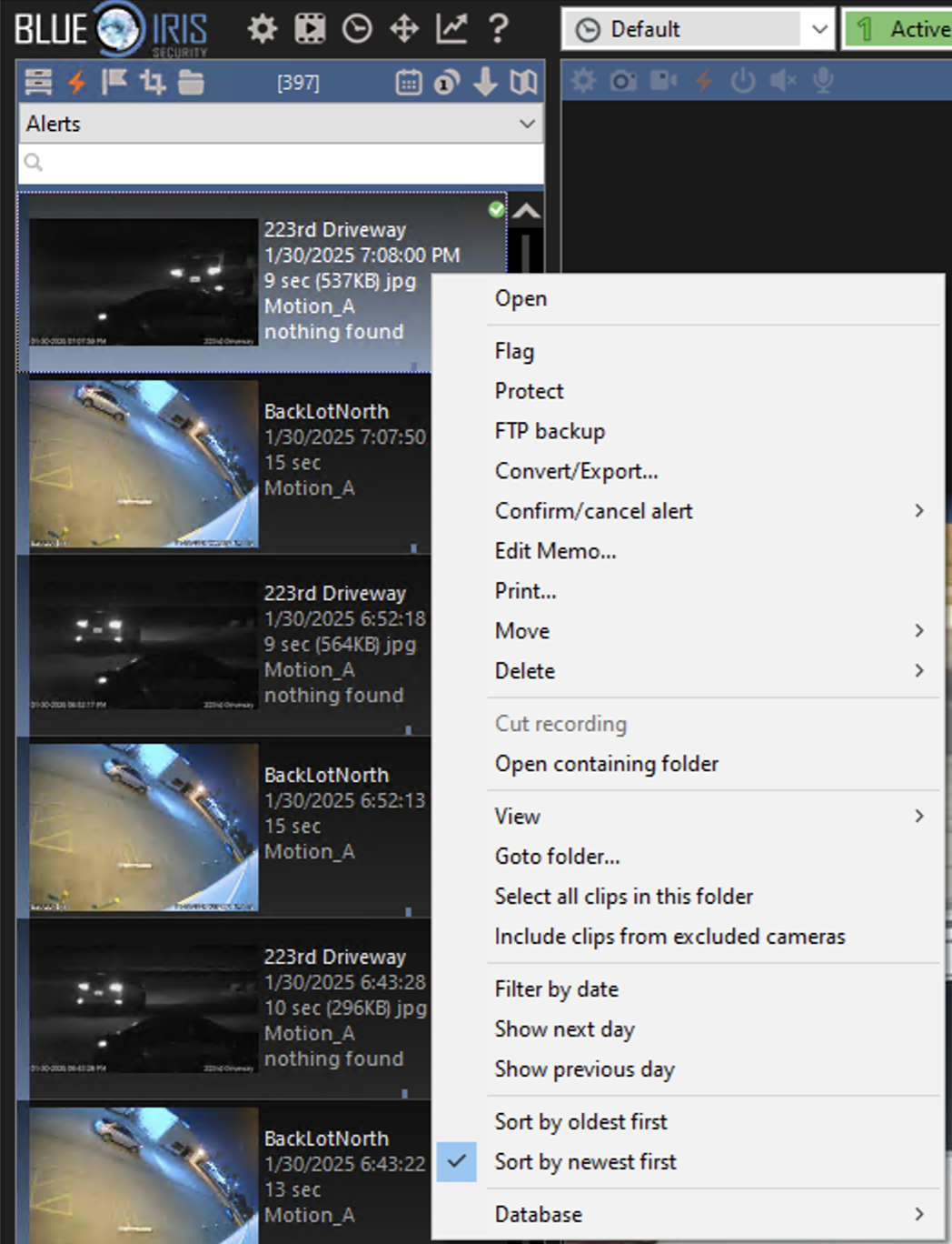

On BI, go to clips and select alerts. Find the one where it should have read the plate, and control-click on it. This will bring up the AI stats, you can see how the image was processed.

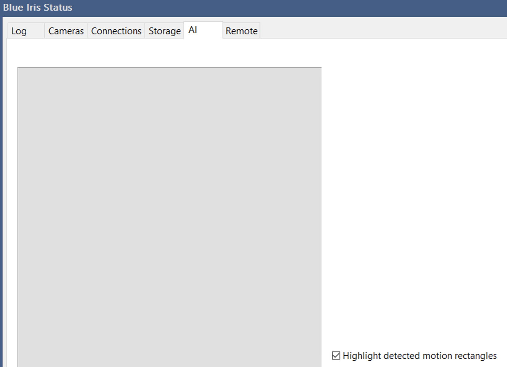

My AI stats pane is empty :(
Default location is c:\BlueIris\Alerts
Ah, there they are. I was looking in my V: drive, where I store everything else:
I see JPGs paired up with DAT files, which I'm assuming is good news, because it means something that done something with those JPGs. Except, curiously, I don't see a JPG for 7:08 PM last night, which is when I manually generated a snapshot of my plate, above.
edit: is this because the Alert generated a "Nothing Found"?
Did you control-left click on the clip?
If I ctrl-click on the Alert clip, I see all these options, but none appears to take me to the AI pane:

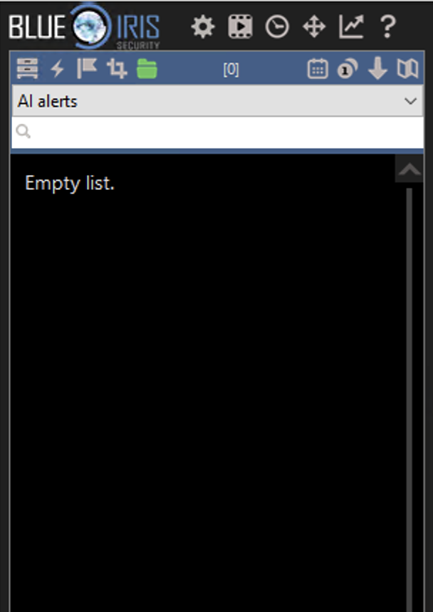

If I switch from Alerts to AI Alerts, I get nothing:

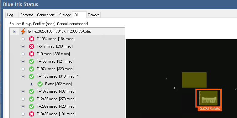

User error. :facepalm: I wasn't recording JPEGs. I am now:
For some reason I'd thought that, since it was examining the video feed, that it would use that for the analysis. Now that I've checked the JPEGs box, I'm getting plates. There are two cars parked in the FOV of one of my LPR cameras, so I did a manual trigger:
My CPAI log has a ton of entries from just this single event. Plate reads are correct:

Is this because I'm calling the Web Request for both the Trigger and for the Alert?
So now I'm partway there, but the ALPR database still isn't populating:
You should only call the Web Request for the Alert.
Thanks! I now have roughly half the traffic per trigger:

You need to ctrl + double right click
Ah, on my machine it's ctrl-double-left-click, but that may be because I'm RDPing in from a Mac. That took a long time to figure out! But now I have AI details:
That's my car! That's my plate! 98%!!
