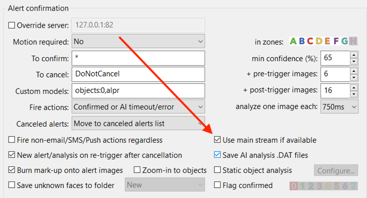

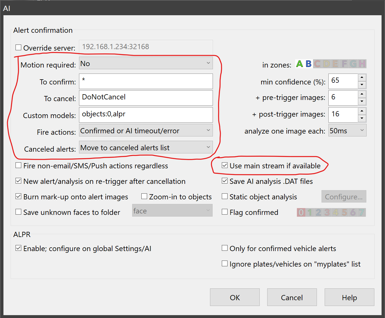

I’m gonna add this image that @MikeLud1 sent + one showing the recording tab with jpegs enabled since a few people have been tripped up there.
A common roadblocks / troubleshooting section would be good to have also detailing BI configuration stuff or AI issues.
I genuinely disagree with some of the settings being flagged as required:
  1. The To Cancel field can be left empty because, given how the custom model is configured (objects:0, alpr), this setting becomes redundant.
  2. Is using the main stream truly beneficial for you? In my experience, it only slows down CPAI without offering any accuracy improvements.
  3. I'm not saving JPEGs anywhere—neither in the record tab nor in the alerts list. While saving JPEGs can be required for other purposes or for personal taste, it is not necessary for ALPR.
Thank you for pointing that out. I thought you had to have the JPEG recording on for it to work? I ran into some sort of problem related to that early on, but maybe it was something else.

Generally main steam is not needed for AI. For the ALPR module it needs the full resolution image for the cropped license plate OCR
Hmm... I just double-checked, and I don't have the main stream enabled. However, I am using 720p as the sub-stream for my ALPR camera. Maybe that's why it works well for me then?
Is that what this checkbox does?
so we can leave the sub stream enabled for N-up and previews, etc., but pass the main stream to AI for processing?
Well the main stream is getting buffered in your memory already for whatever pre-trigger period you have set. That's the whole point of the sub stream.
Also, if you're not actively tweaking stuff or checking it, you might want to turn off the option to save the analysis details. Fills up storage and db very quickly.

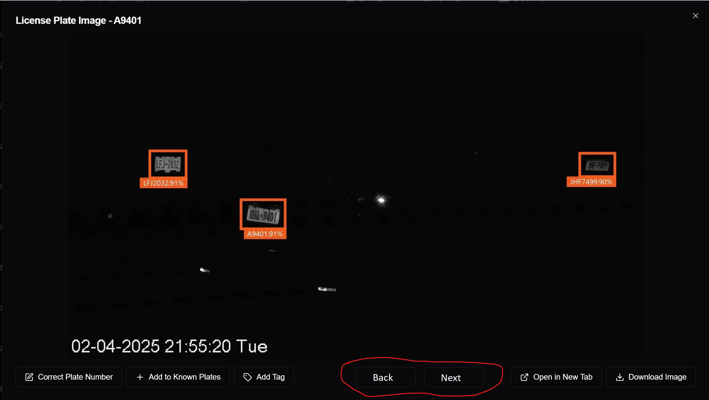

What about both left/right arrow keys and Next/Back
I was thinking about it for tablet reasons bc I’m sure there are some homeassistanters with a wall mount that might want that.
It’s getting a bit crowded down there though. I was thinking I might put the buttons outside of the edge as like half opacity circles or something. I was going to hide them on large screens though thinking they wouldn’t be needed, but I don’t have to.
Do u want it for touch screen reasons or just a mouse preference?
