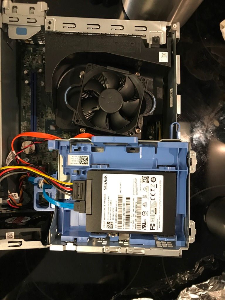

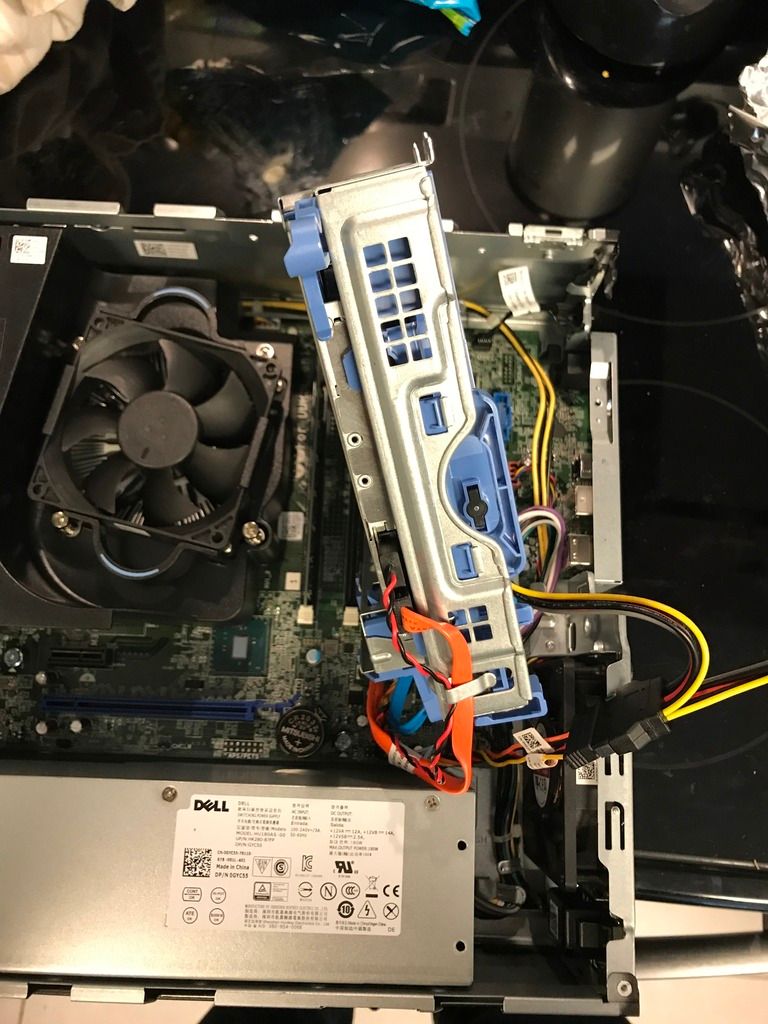

That's how I configured mine. I didn't care what is looked like, as it is hidden away. You can purchase a caddie that will replace the DVD drive and hold the SSD, if you wish.View attachment 18263 View attachment 18264 View attachment 18265 View attachment 18266
