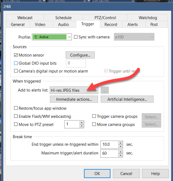

One step I missed that caused me all kinds of grief was turning on the high-resolution image (vs database) under trigger:
If you miss that step, you will be beating your head against a wall...

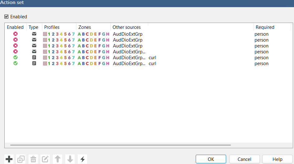

By labels. I mean the alerts area. I attached a photo. All I see for description is CURL. Id like to label it but not sure if im able to
