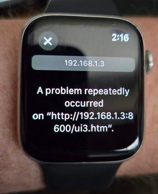

Try this...
  1. Email a URL to yourself.
  2. Open the email on your Watch.
  3. Touch the hyperlink.
Safari will take a moment to load, then hopefully run the web page.
EDIT: this link describes an alternate method using the Blue Iris SMS action.
UI3 URLs used to open just fine, but I just tried it and got this
Other URLs are working just fine.

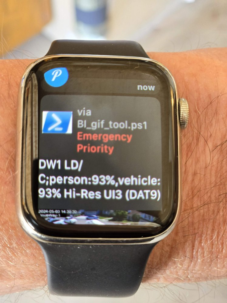

BTW, the iOS Pushover app supports the Apple Watch.
On your iPhone, open the Watch app. Add Pushover.
HOWEVER, when the Watch receives a Pushover notification, I'm noticing that the 'Hi-Res' and 'UI3' links are not active.
The URLs work just fine when tapped in the iPhone Pushover app.
