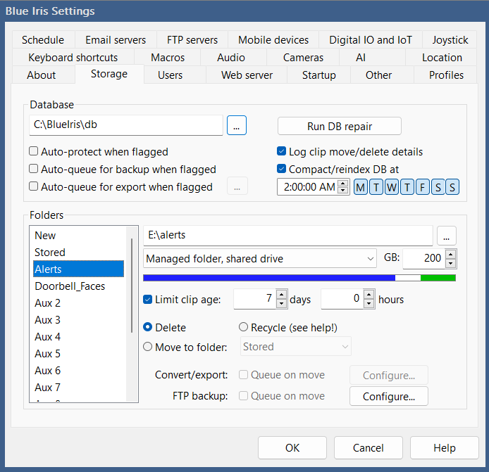

Hi All - thanks for the great write-up and discussion on how to get this to work. I set this up on my pushover account, and everything is working, except that I can't get the attachment to actually show in the pushover notification. The 2 links work (the link to the high res marked up jpg, as well as the link to UI3), but pushover doesn't show a thumbnail attachment in the notification itself. I'm not sure what I'm doing wrong, so here is my command:
Code:
https://api.pushover.net/1/messages.json -s --form-string "token=%996" --form-string "user=%997" --form-string "message=<b>&CAM</b> &MEMO <a href='&WAN/alerts/&ALERT_DB?fulljpeg'>Hi-Res</a> <a href='&WAN/ui3.htm?rec=&ALERT_DB'>UI3</a>" --form-string "html=1" --form-string "device="%998" -F "attachment=@E:\alerts\&ALERT_PATH"
I confirmed that the path for my alerts folder is correct (see below), so I'm not sure what I'm doing wrong. Any insight would be greatly appreciated. Thanks!

Let's try these two things first:
  1. What's the typical size of your camera's alert JPGs? If over 2.5MB, then they are rejected by the Pushover API. If this appears to be the issue, then the solution might be my pushover_resize script.
  2. If not #1, then try checking setting 'Wait for process to complete' on the 'Run a program' action in the 'On alert' action set.
Thanks for the quick reply!
Apologies, I forgot to mention that I did check the jpg sizes, and so far all have been under 2.5MB. For #2, I just checked that and will report back once my wife get's home and triggers the alert.
