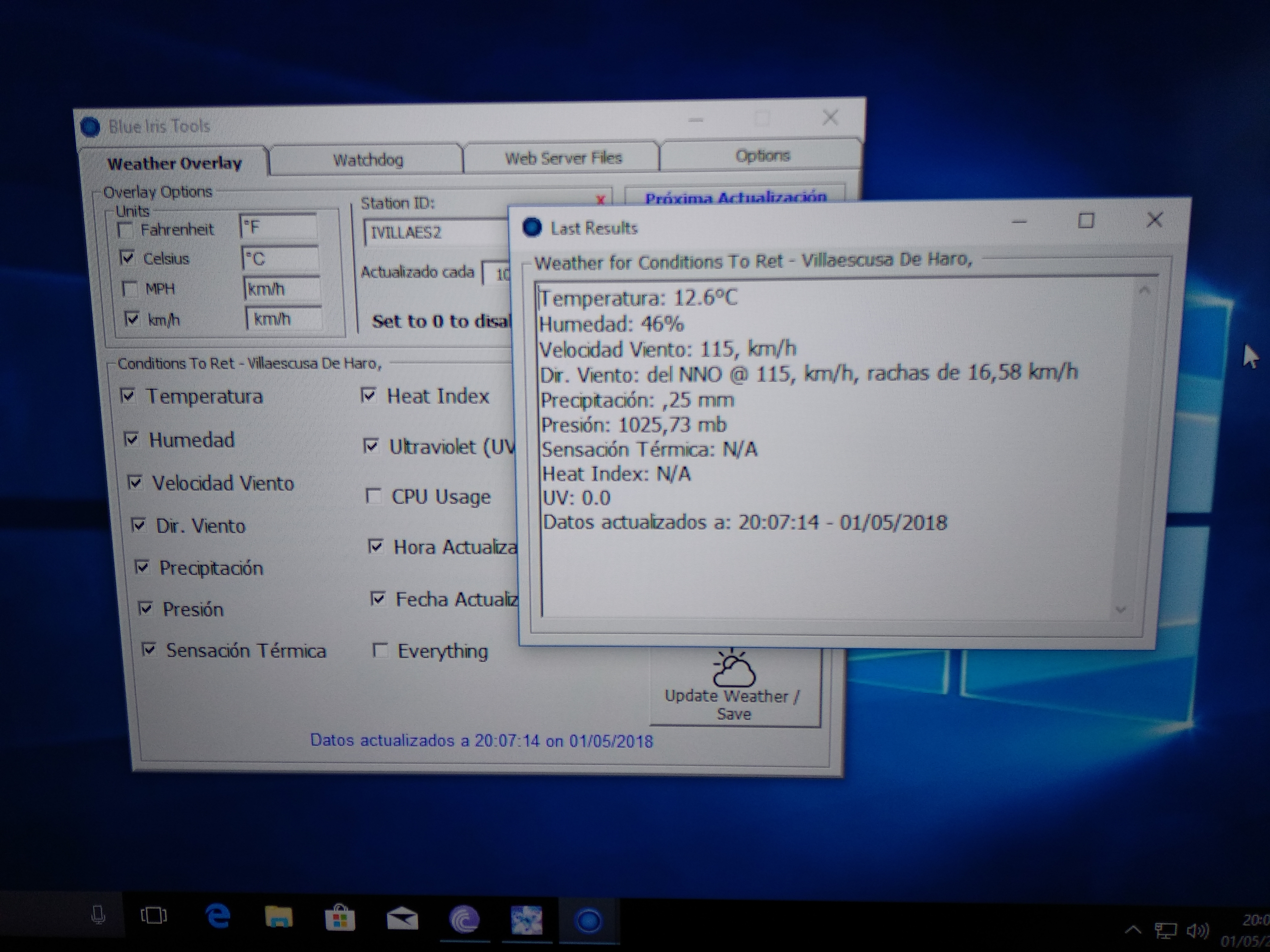

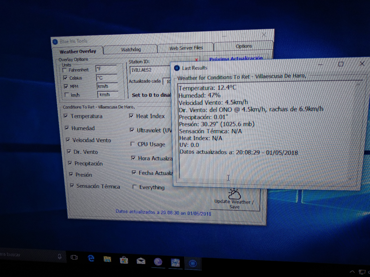

Hi Mike, thanks for your work.
I have installed the update and I still have the problem before:
- If in "units" I choose Celsius and km / h. the precipitation data appears in mm, but it lacks a 0 in the units. Also in wind speed, 115 km / h appear instead of 11.5 km / h.
- If in "units" I choose Celsius and MPH, the wind speed appears correctly, but the precipitation data appear in inches. :-( celsius_kmh.jpg celsius_mph.png
- If in "units" I choose Celsius and MPH, the wind speed appears correctly, but the precipitation data appear in inches. :-(View attachment 29105 View attachment 29106
I guess the conversion is wrong? Is this happening for anyone else? I will try to duplicate the error, or perhaps allow users to input their own calculation. In the meantime can you please share your language file with the community?
