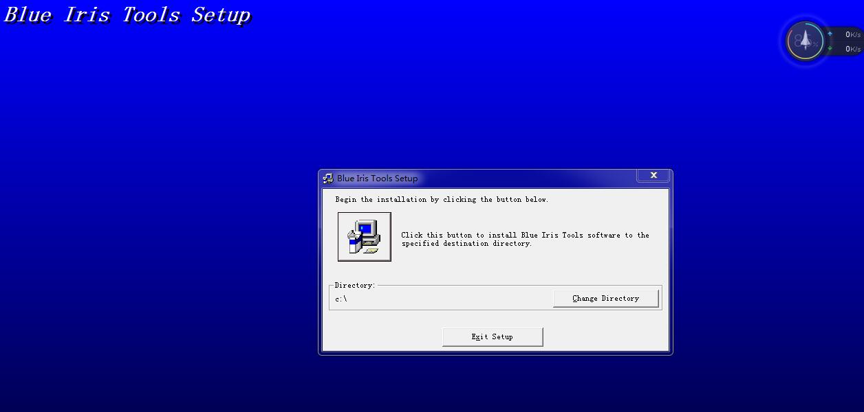

I can not install Blue Iris Tools can any one help me ?

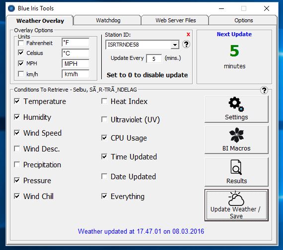

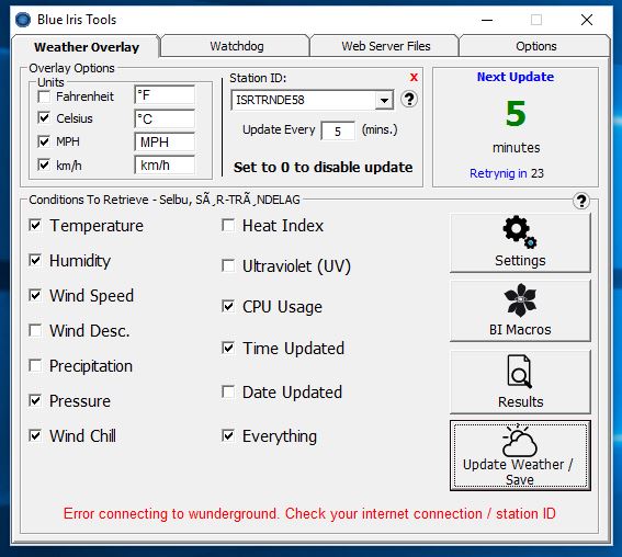

I have read all forum entries, I have updated BIT. In spite of this, I still publish rain data in inches instead of millimeters. I have not seen the option to change it either. Any ideas?.

Did you try to set it to Celsius and km/h?
Good morning Mike. I just got the station "offline", if I get it back on line, I'll explain.
Thank you.
