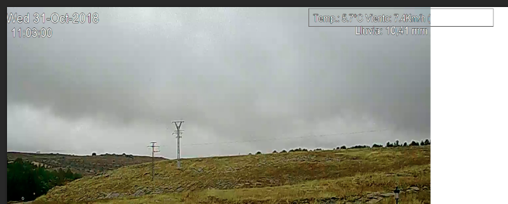

It is a small bug of the program: the wind speed appears in km / h but the gusts of wind appear with the figure of the decimals with error. What I have done at the moment is to place the wind figure on the right side so that only the wind speed appears and the speed of the gusts of wind are outside the image :-p
It is a small bug of the program: the wind speed appears in km / h but the gusts of wind appear with the figure of the decimals with error. What I have done at the moment is to place the wind figure on the right side so that only the wind speed appears and the speed of the gusts of wind are outside the image :pView attachment 34617
Thanks for reporting this.
