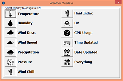

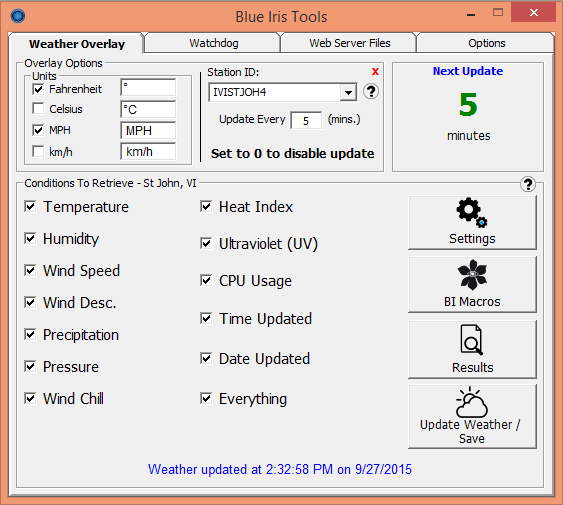

  • Weather Overlays
    • Easily add the local weather to your camera feeds,

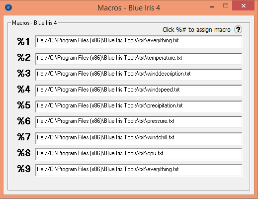

    • Easily create Macros for Blue Iris right from BI Tools,
    • Ability to assign all weather conditions to 1 Macro!

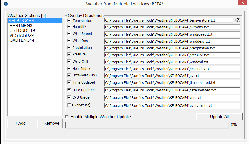

    • Retrieve & overlay weather from multiple locations

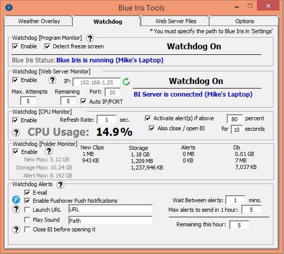

  • Watchdog
    • If Blue Iris crashes or closes, BI Tools will re-open it
    • Monitor Blue Iris (whether running 'normal' or as a service)
    • Monitor Blue Iris' web server. If BIT cannot connect, activate alerts
    • CPU monitor + CPU Overlay
    • BI folders monitor
    • IP Address monitor (notify if change)

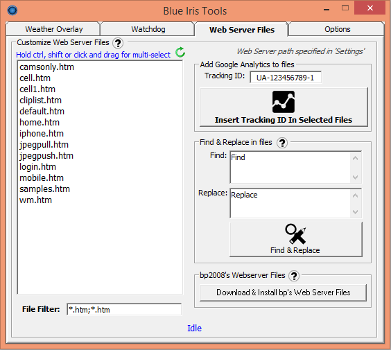

  • Web Server File Management
    • Insert Google Analytics into web server files easily,
    • Search & Replace in web server files - manually or automatically

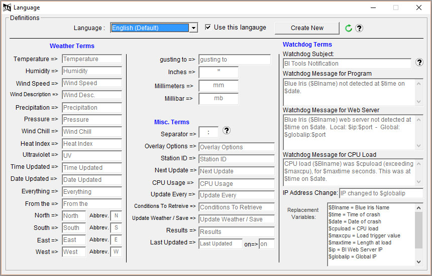

  • Language
    • Create and import custom language phrases and definitions. Language files are available in the 2nd post of this thread. If you created your own, please share it!

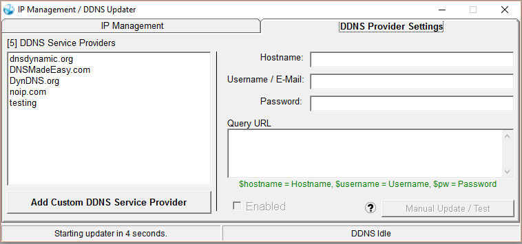

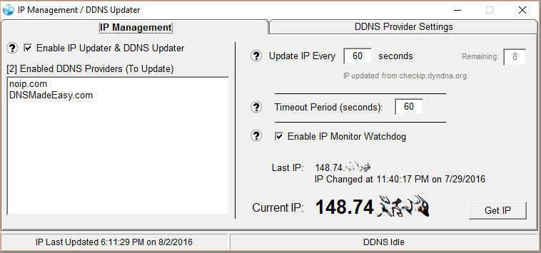

  • DDNS Updater & IP Management
    • Automatically update DDNS providers when your IP address changes

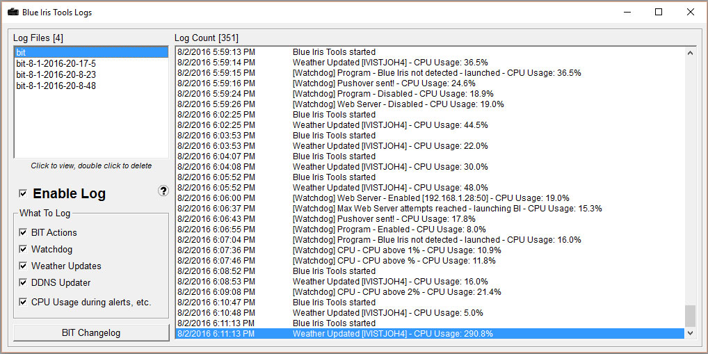

  • Log
    • Log all BIT related actions (BIT open / close, etc.)
    • Watchdog (Anytime the Watchdog is triggered - if BI is closed, etc.)
    • Weather Updates (anytime the weather is updated)
    • DDNS Updater (when your IP changes, etc.)
    • CPU Usage (log CPU usage during alerts, etc.)

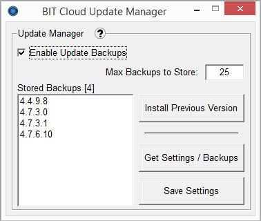

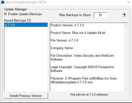

  • BI Update Manager
    • Keep previous versions of Blue Iris
    • Easily restore previous BI versions

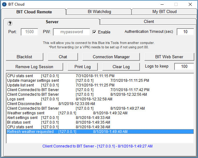

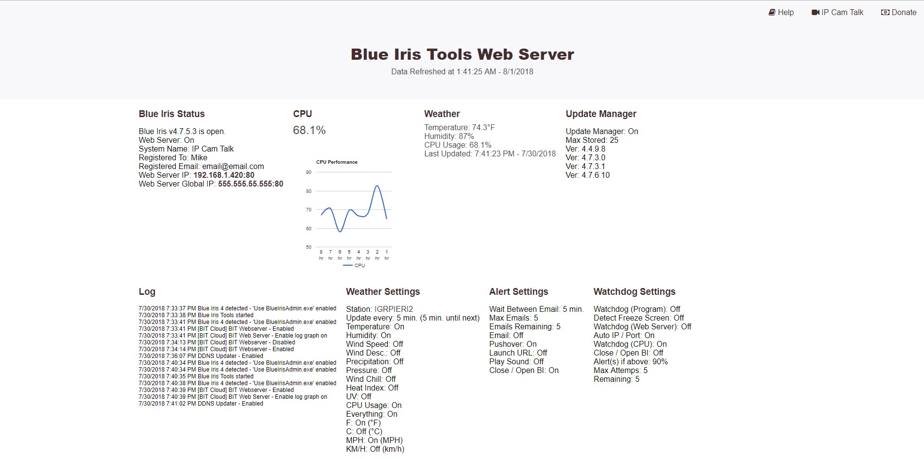

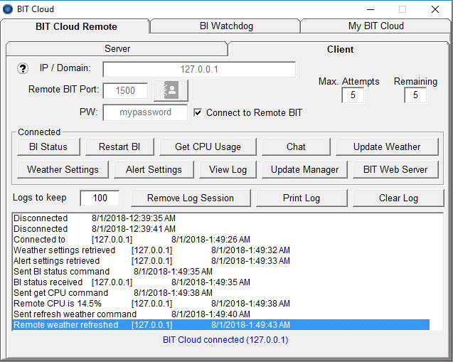

  • BIT Cloud (New in 1.2.x!)

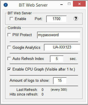

    • BIT Cloud Remote - Connect to BIT from another remote BIT to view / manage settings and control BIT / BI, etc.
    • BIT Cloud Web Server - A personal website for you to connect to from any browser on any device to check your BIT / BI, including stats, weather, log, cpu, settings, etc.

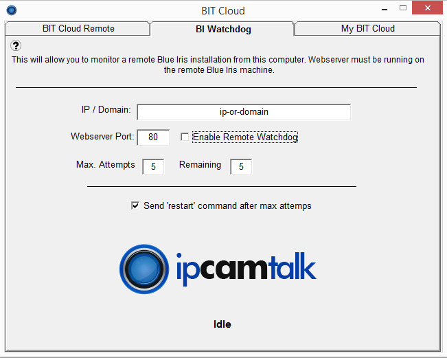

    • BIT Cloud Watchdog - Remotely monitor a BI or BIT install - with watchdog alerts.

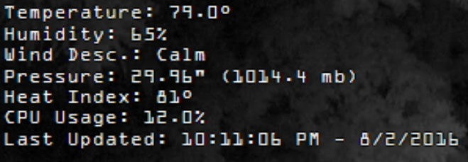

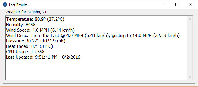

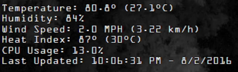

Here are a few examples of the weather on your video feeds. You can select which conditions to show, what units to display and more.
View attachment 10275 View attachment 10273 View attachment 10274

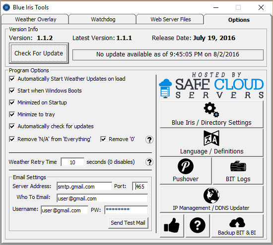

The BIT link I get is for 1.1.2, not the latest. I can't figure out ANY way to download the latest. If I download, 1.1.2 will it update to the latest??
Really frustrating.
I attached a screenshot.
Download it then update via the program.

Did you try BIT's "Help" as shown below? It will take you to the latest help online, here. Scroll down to "Options", "Check for Update."

Mike, thanks for the great functionality you created with BIT, I have been looking for this for awhile. No problems installing or configuring everything, you can see the overlays in action on my weather site, Observatory West Weather. My only request would be a way to create a text file with several selectable datapoints (like temp, pressure, wind) only, instead of either one datapoint or all. I can do it manually by creating several macros but having 1 do several things (but not everything) would be great. Keep up the great work!
That feature is built in, use the "Everything" option. That will save all of the values into a text file.
Thanks, I understand the everything option, I was actually talking about selecting several, but not all, sensors to be combined in 1 file.

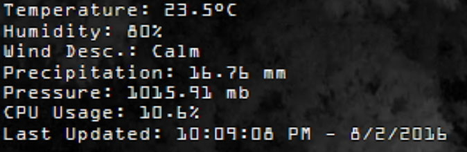

I posted this question in the "Chit Chat" area, couldn't find this thread for the life of me. Blame it on a senior moment.
Is there a way to edit the "wind description" to reduce the length of the displayed text or even break it into two separate lines of text? I checked the help file and didn't see anything there, but that could be another senior thing.
