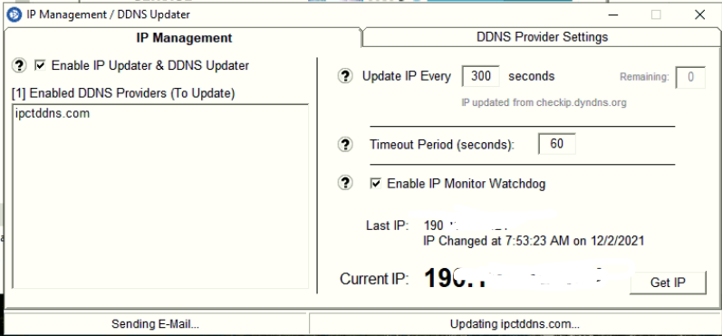

This is a great tool to supplement BI. I'm having an issue with the IP updater not running consistently though. My IP changes frequently. When I cannot connect to my IPCTDDNS.com address and have to log into the server, I see at the bottom of the IP Management / DDNS Updater screen: "Updating ipctddns.com..." and "Sending E-Mail..." The IP address shown is no longer current and needs to be refreshed manually. I disabled Watchdog notifications for the short term to see if that helps. Any other suggestions on how to get the IP address updater to work consistently?
Thanks!

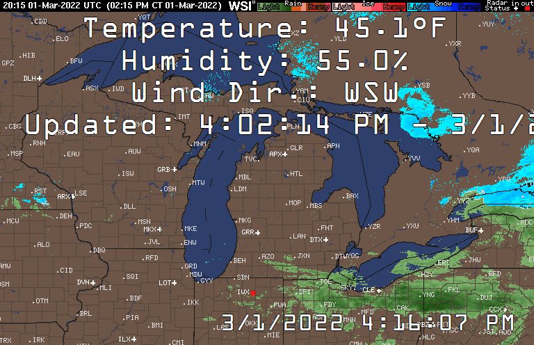

The current version works, you just get the popup about not being able to update. That's a minor issue but the current version works as is otherwise.

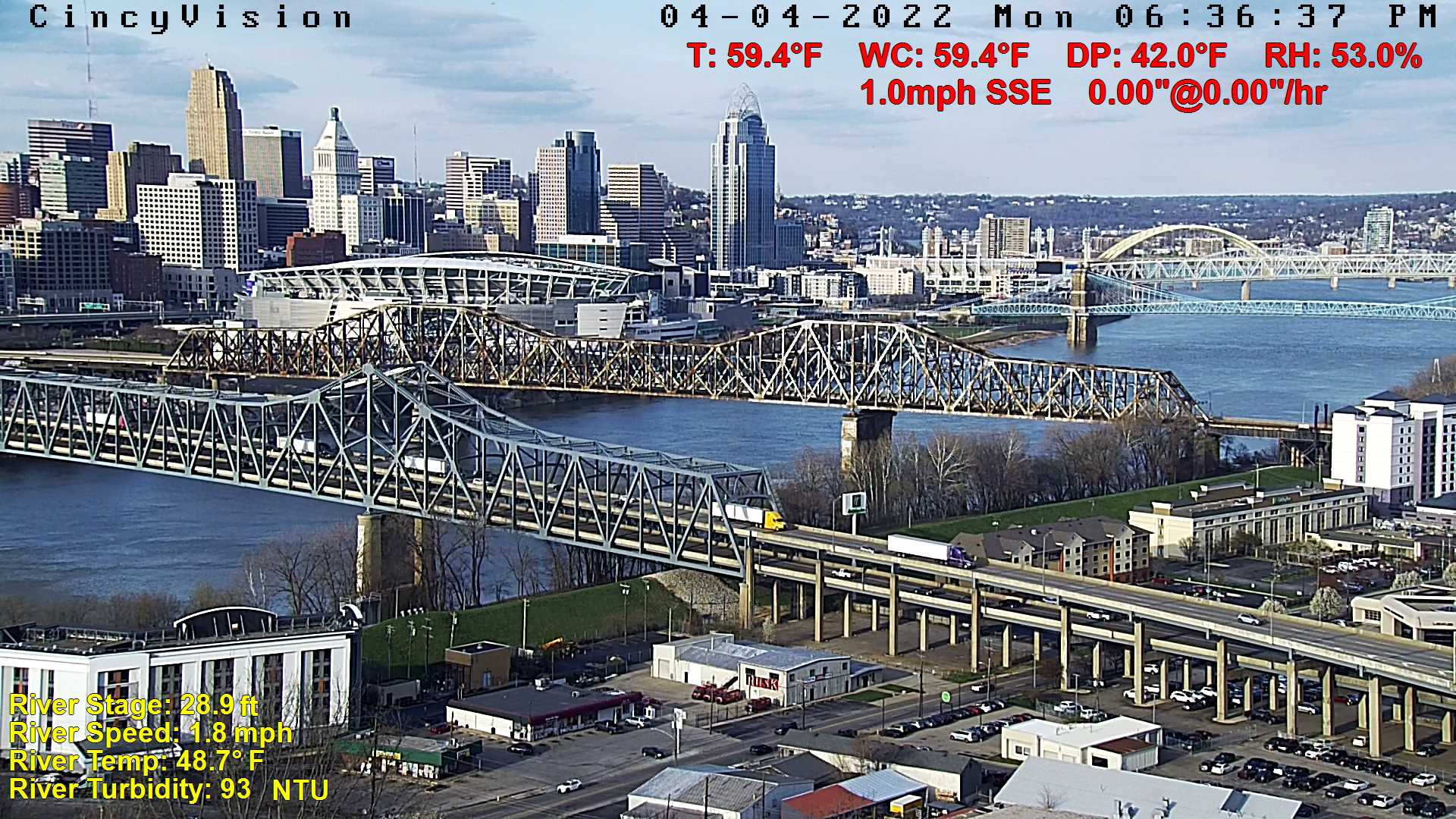

Only Wunderground is supported out of the box, and I've never heard of anyone tweaking it to make it work with another provider, but you can create add-ons. So it theoretically should be possible if you are able to write scripts to fetch data from a different provider (if it falls in line with their terms of service of course). I was able to create an add-on with a python script to grab data from a website to post it on my overlay with Blue Iris Tools. It's a pretty specific use case, I grab Ohio River stage / speed / temp / turbidity data, but you can see it below (lower left in yellow). Add-ons documentation is here: Blue Iris Tools Add-ons. I don't know anything about CumulusMX, but looks like there is an API Cumulus MX Local API - Cumulus Wiki that might be able to be leveraged.
