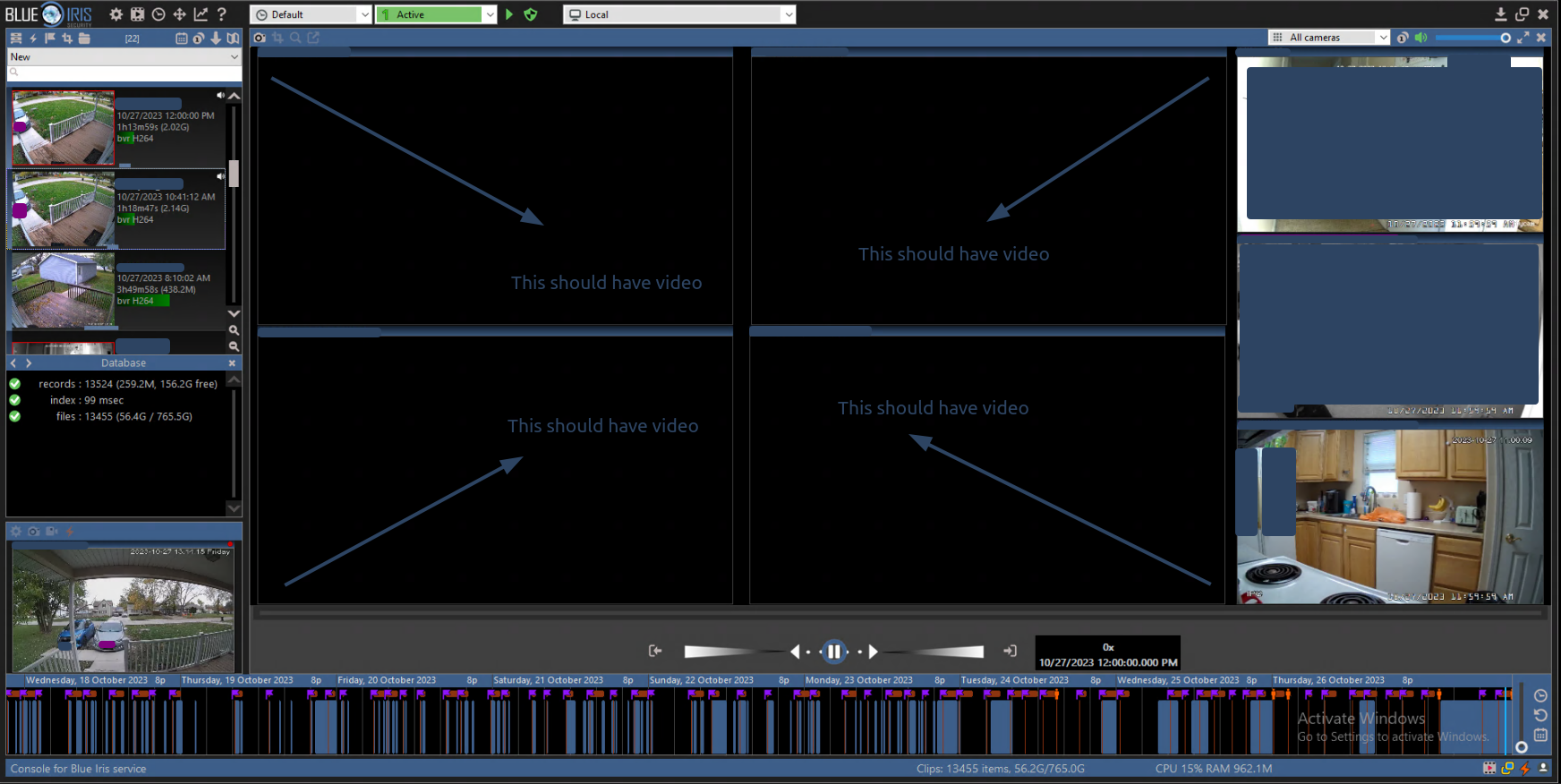

I am not sure exactly what is going on. I went to look at some footage from earlier today, and two cameras were giving "BVH Error" in the i3 web view. I went to look at the actual BI instance and saw huge gaps of missing stuff (should be recording all the time)
The timeline in the shot below seems like it got rid of any non-motion detected footage, but when I go to view, a lot of it is missing actual video and just giving black screens. In the timeline, it shows that there should be full footage, but 4 of the cameras have just black playback. and if I scrub, the black jumps around to different frames.
I have the webview open throughout the day on a dedicated phone, and there has been no actual loss of video feed.
direct
I was on 5.0.8 I believe earlier today, but saw there were updates, so I did them a few hours ago, up to 5.0.10 (which was when I noticed this issue), but just saw 5.0.11 came out not long ago, so I had installed that now about 10-15 minutes ago.
