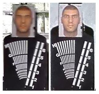

However, if you can adjust the shutter the speed then yes faster the shutter speed, the more text in each still is readable as there's less travel by the object during the exposure.
CCTV Camera Settings: Here's How to get the Best Picture Possible
Ok, so you have enough ‘pixels on target’ for identification, but what if your target is moving? People often walk. Using one of the UK Home Office CCTV test faces we can see how sufficient detail can still get destroyed (see below right).
The left-hand image has a camera shutter of 1/30s, which is probably true of every camera that’s fitted and left on factory default camera settings. The right-hand image has the shutter deliberately shortened to 1/125s. See the advantage?
The factory default CCTV camera settings give us motion blur at walking speed which destroys the identification details that all those pixels were meant to give us. You need to set a sufficiently fast shutter to freeze the motion.
Now when dealing with cars, which travel at more than walking pace (!), the average distance travelled during the exposure period is higher, so this requires a higher shutter speed to freeze the motion and ensure the text of the number plate is readable. Blur is the result of the object moving during exposure and the faster the shutter speed, the less movement in the exposure period and the less blur.
