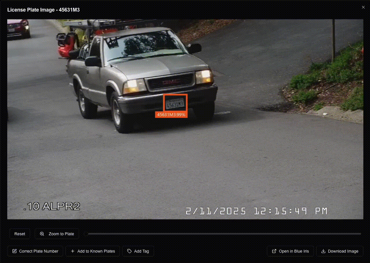

First part of ALPR training integration is done! Just need to set up the export processing and sharing now. Also adds the ability to do this which is cool (only laggy in the gif):
Sets the focal point as close as possible to the center of the plate for quick zoom in.

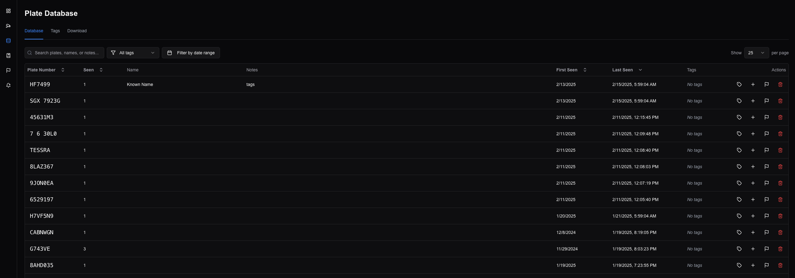

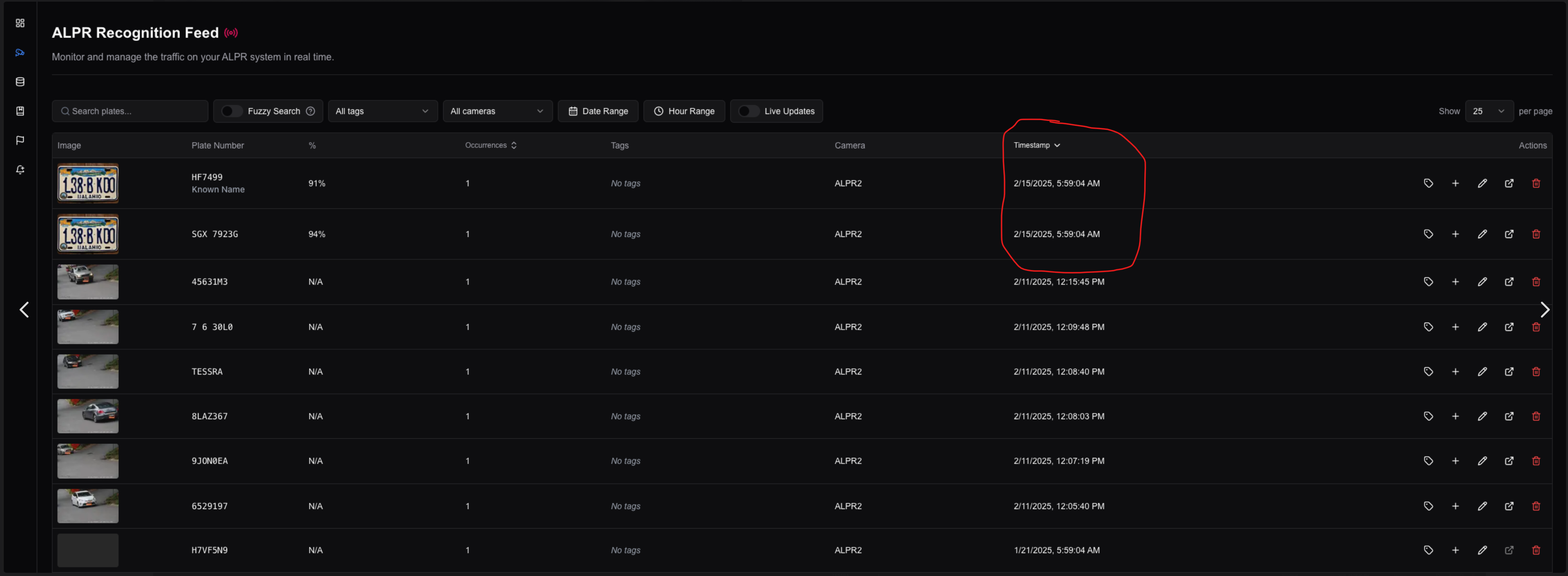

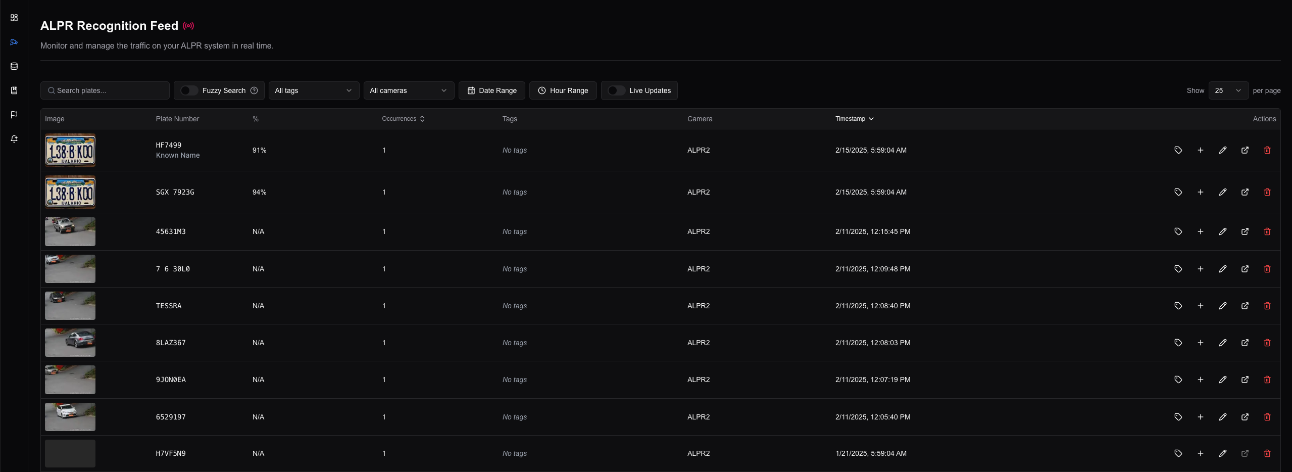

I'm also playing with some better use of layers in the UI:
View attachment 214483View attachment 214485
