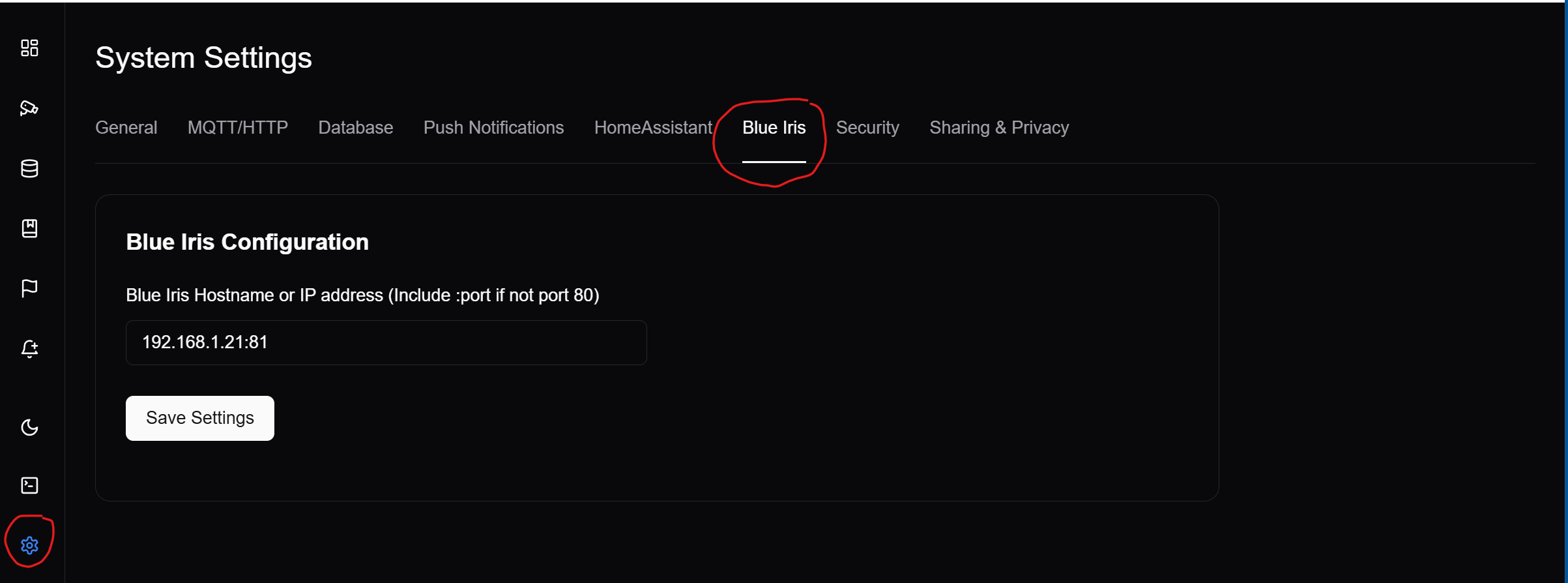

Working open in blue iris button that takes you straight to the associated alert:

You will need to add "ALERT_PATH": "&ALERT_PATH", "ALERT_CLIP": "&ALERT_CLIP" to your blue iris action. The button only shows up if the data is available.
I've just added, but the button is not showing up.
{ "plate_number":"&PLATE", "Image":"&ALERT_JPEG", "camera":"&CAM", "timestamp":"&ALERT_TIME", "ALERT_PATH": "&ALERT_PATH", "ALERT_CLIP": "&ALERT_CLIP" }
Have you had a new plate read since updating BI? I think this will only enable it for plates that are read going forward.
