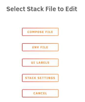

Docker Compose Plugin for Unraid worked. Thanks
Can you share what you used in the Unraid Docker Compose Plugin --> Edit Stack --> Compose File and any other things you edited? I am having issues with the Postgres portion =/

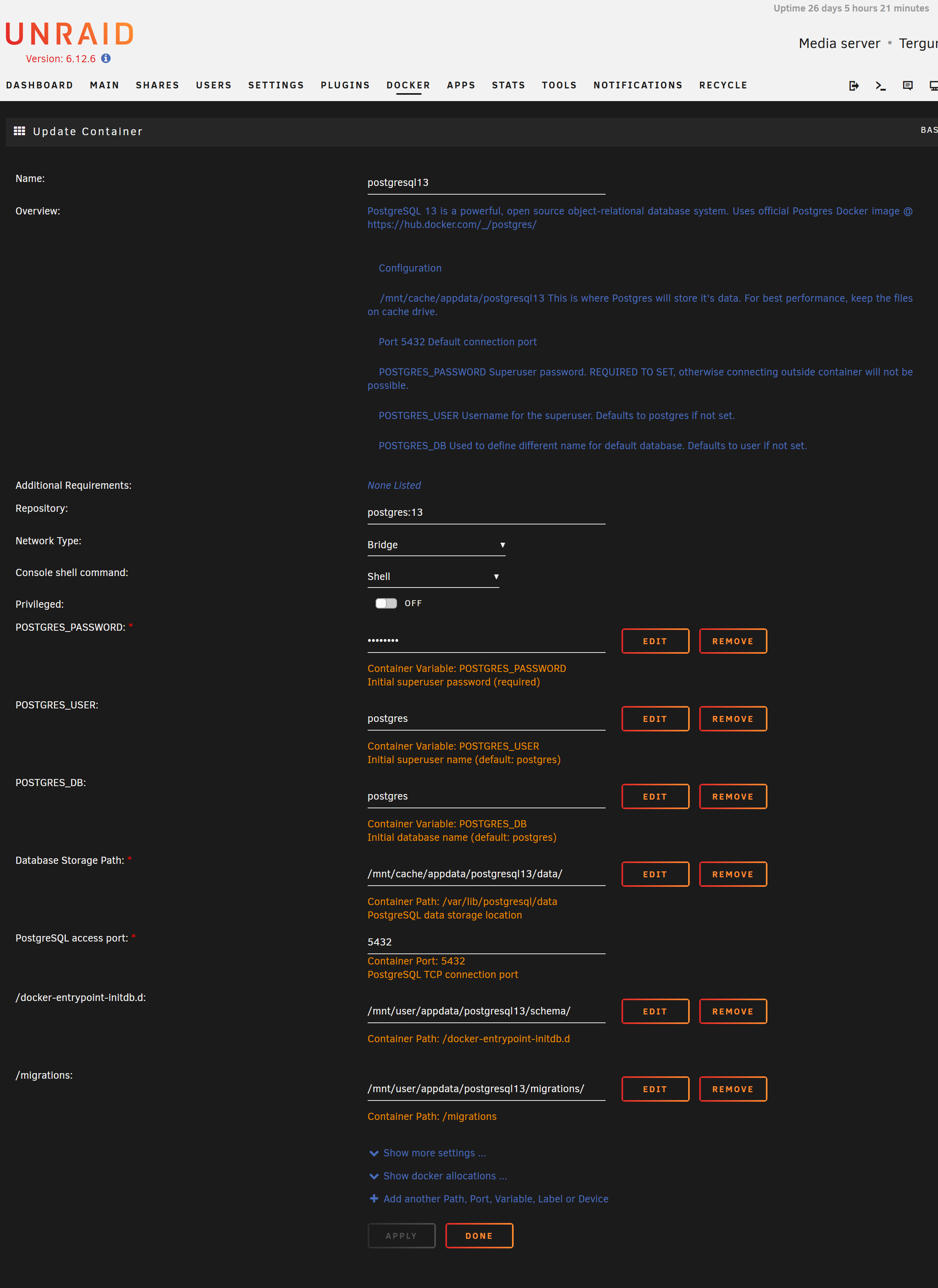

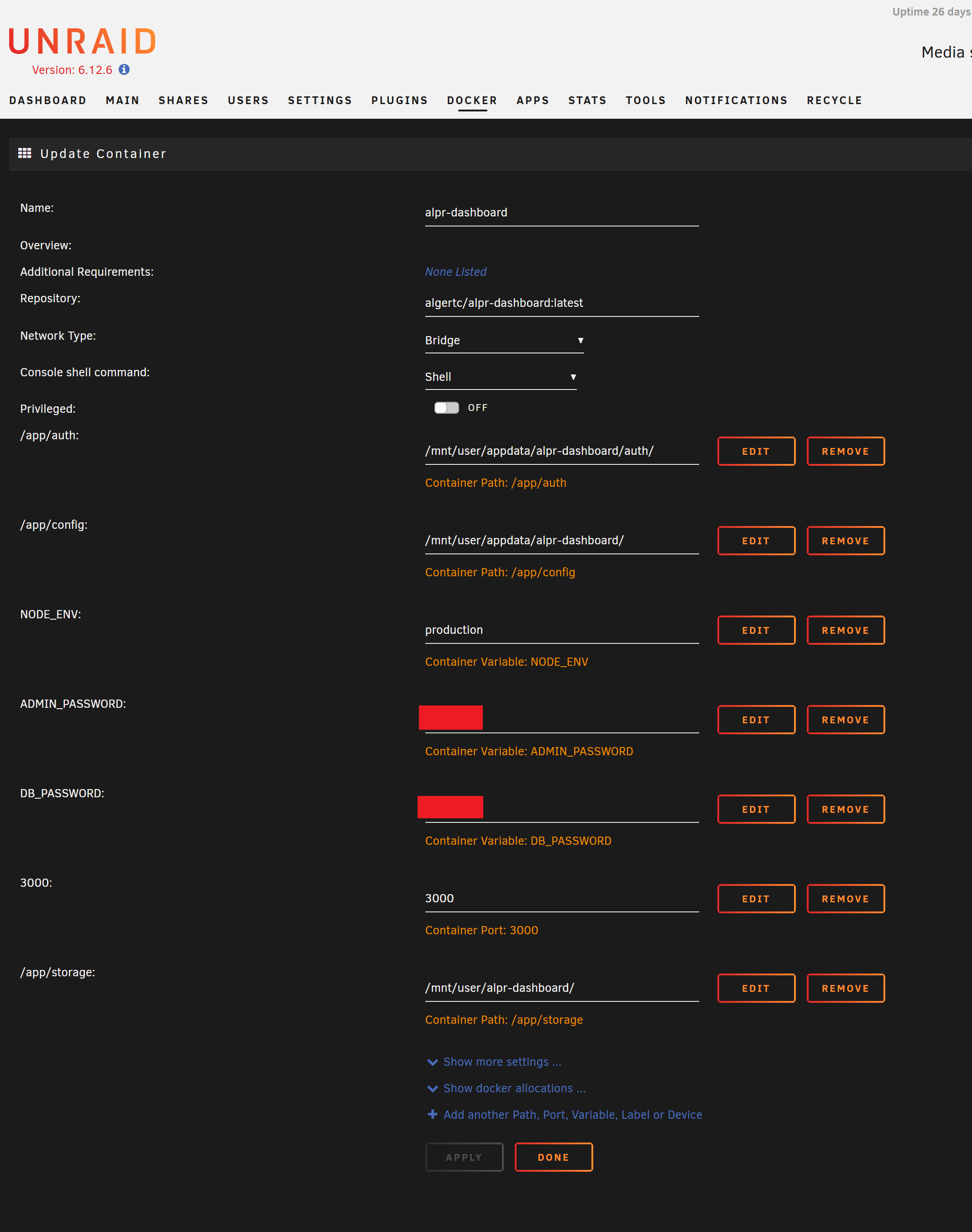

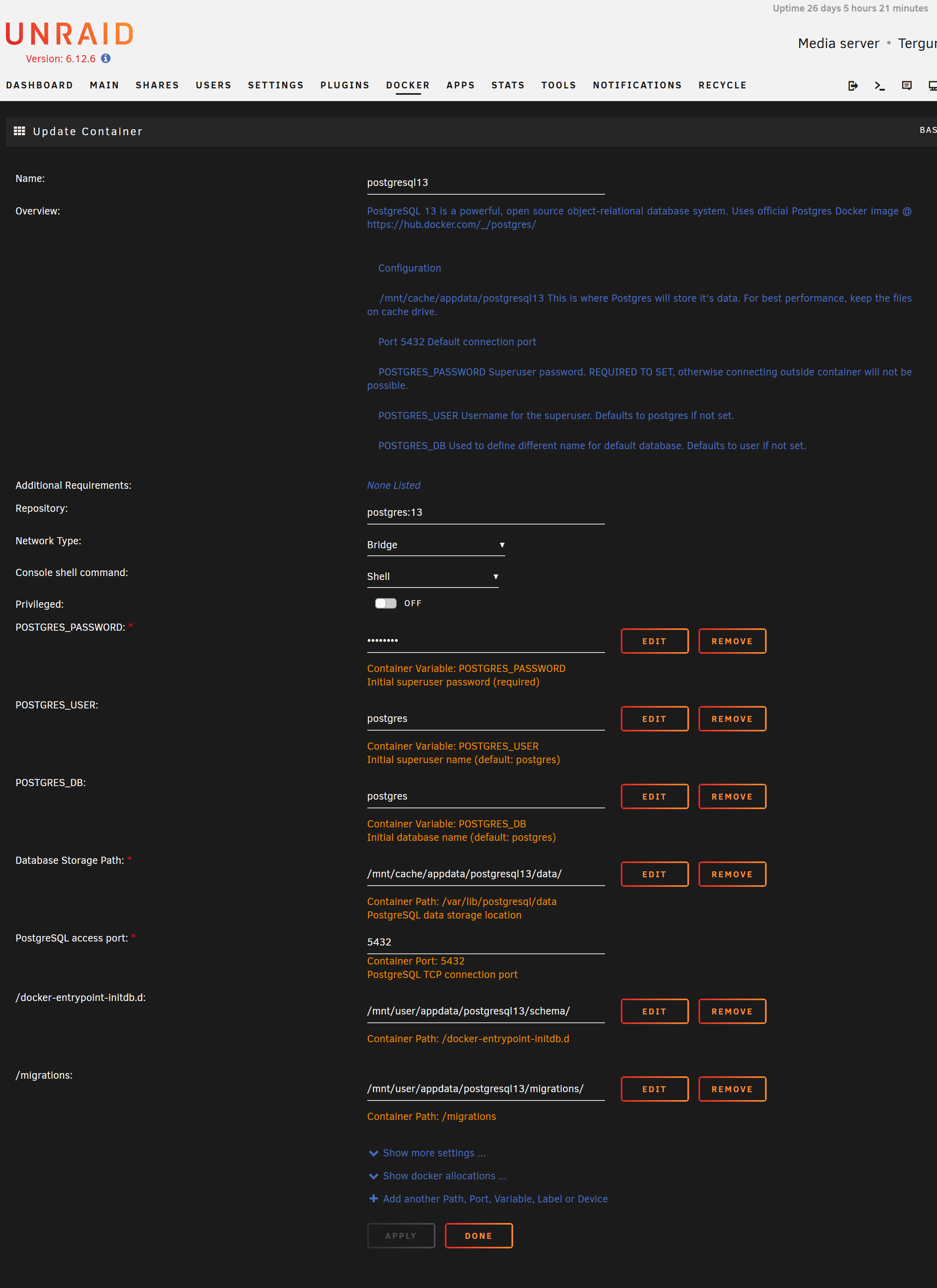

Thanks for the lead. It looks like I got it working in unraid now:
Here are my container configs for reference:
I was getting some errors in the logs. Once I ran the migrations per Olympia in the github discussion everything was working. Based upon MY postgresql config settings here is what I ran in the postgres console:
Code:
psql -U postgres -d postgres -f /migrations/migrations.sql
Code:

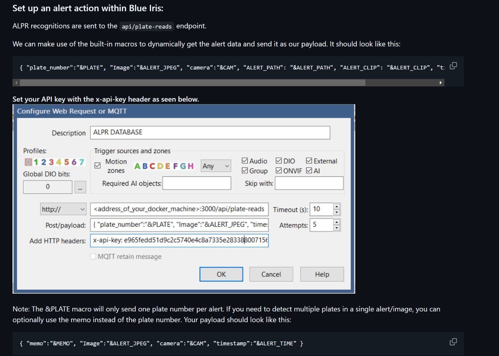

cant find this part log into the application. what application? i'm using windows. installed Docker Desktop and Git Bash. i'm lost.​
Get Your API Key​
To start sending data, log in to the application and navigate to settings -> security in the bottom left hand corner. At the bottom of the page you should see an API key. Click the eye to reveal the key and copy it down for use in Blue Iris.
Get Your API Key​
