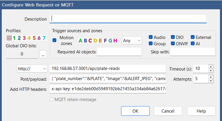

You fixed the missing x-api-key issue, but did you fix the missing "/api/plate-reads" in your ip address?
Good spot. @Vettester is right. I would use localhost instead of your hostname too if it’s the same machine just to prevent any issues.

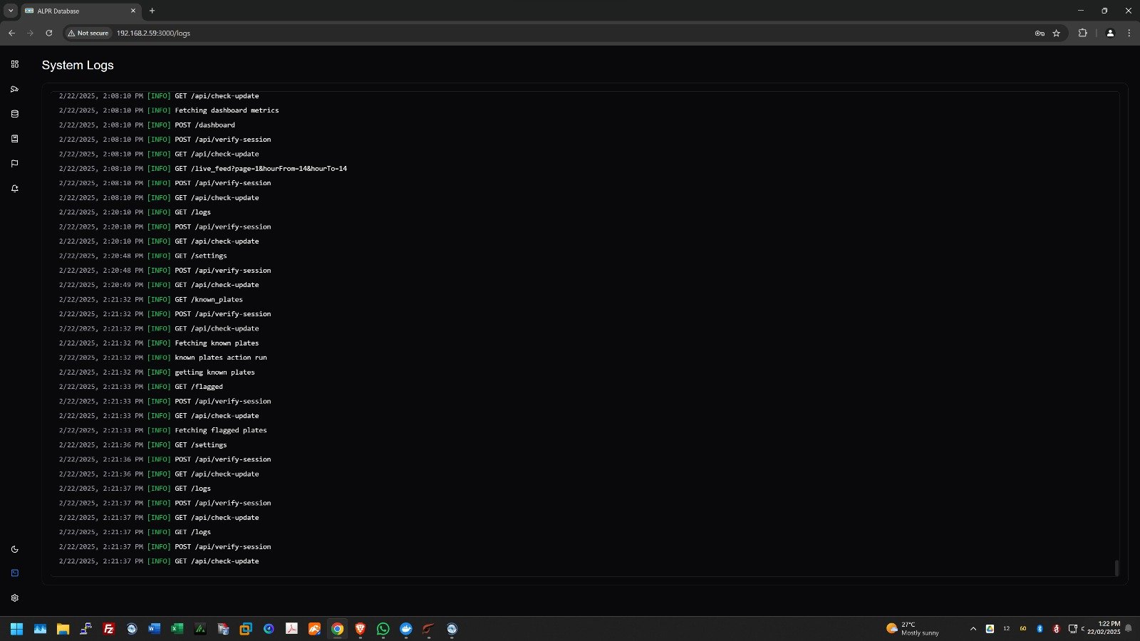

Did you use the install script or did you create the directories and copy the files manually? Please check the logs tab at the bottom left of the app also and see if there are any other errors there. @sunny0101786
You fixed the missing x-api-key issue, but did you fix the missing "/api/plate-reads" in your ip address? It should be MY-PC:3000/api/plate-reads
i get this error

Where did /dashboard/ come from? It should look exactly as it does in the example.

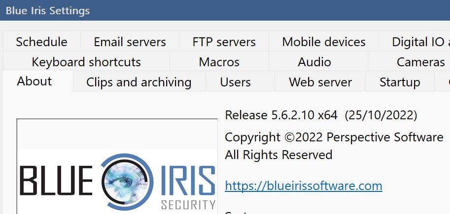

I’m running version 5.6.2.10. Do you think it has something to do with this? I’m still in the process of upgrading, but I’m having a bit of an issue I haven’t received any new keys from the BI team yet.

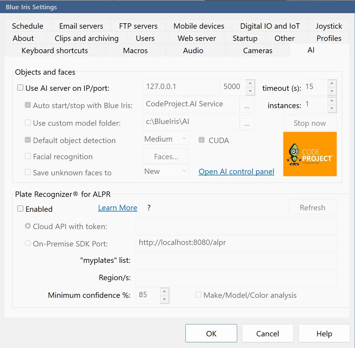

Do I need to change any settings in the AI menu?

logs
It looks like your AI is disabled? Unless you have the server override set in the camera you should have the top box ticked.
Can you clarify if you ever had ALPR working? That has been asked a couple times, but I couldn't find your response.
I believe you need custom models enabled for ALPR in the older releases.
If you aren't already getting plates in the memo of your blue iris alerts, I would encourage you to please consult the ALPR threads or a youtube video and get that working first then come back here. As I said, this does not do any ALPR. Your issue is well before anything here in the pipeline.
