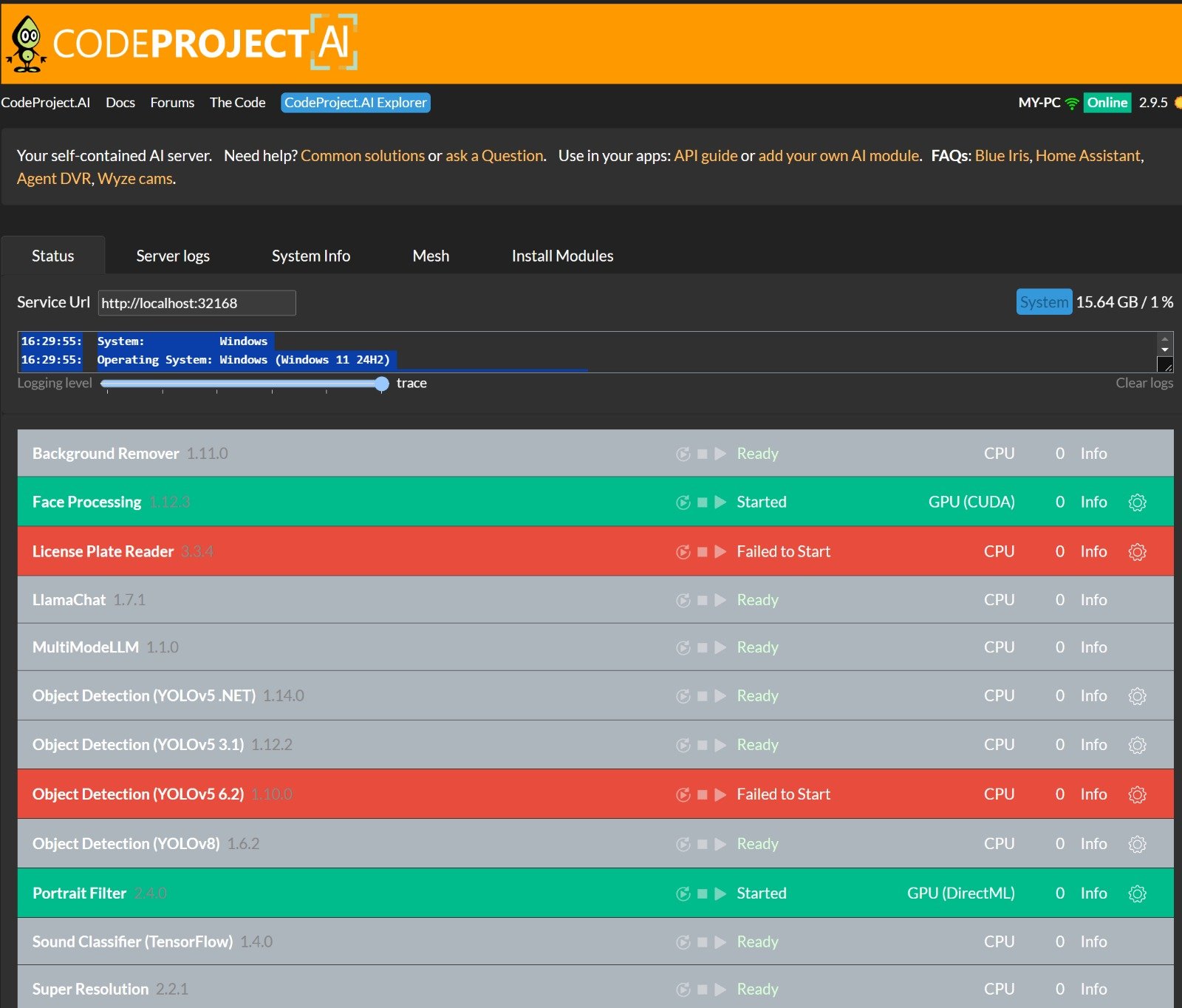

16:29:55:System: Windows
16:29:55:Operating System: Windows (Windows 11 24H2)
16:29:55:CPUs: AMD Ryzen 9 5950X 16-Core Processor (AMD)
16:29:55: 1 CPU x 16 cores. 32 logical processors (x64)
16:29:55:GPU (Primary): (NVIDIA), CUDA: 11.2 (up to: 11.2), Compute: , cuDNN:
16:29:55:System RAM: 128 GiB
16:29:55:Platform: Windows
16:29:55:BuildConfig: Release
16:29:55:Execution Env: Native
16:29:55:Runtime Env: Production
16:29:55:Runtimes installed:
16:29:55: .NET runtime: 9.0.2
16:29:55: .NET SDK: 9.0.200
16:29:55: Default Python: Not found
16:29:55: Go: Not found
16:29:55: NodeJS: Not found
16:29:55: Rust: Not found
16:29:55:App DataDir: C:\ProgramData\CodeProject\AI
16:29:55:Video adapter info:
16:29:55: NVIDIA GeForce GT 710:
16:29:55: Driver Version 27.21.14.6296
16:29:55: Video Processor GeForce GT 710
16:29:55:STARTING CODEPROJECT.AI SERVER
16:29:55:RUNTIMES_PATH = C:\Program Files\CodeProject\AI\runtimes
16:29:55:PREINSTALLED_MODULES_PATH = C:\Program Files\CodeProject\AI\preinstalled-modules
16:29:55:DEMO_MODULES_PATH = C:\Program Files\CodeProject\AI\src\demos\modules
16:29:55:EXTERNAL_MODULES_PATH = C:\Program Files\CodeProject\CodeProject.AI-Modules
16:29:55:MODULES_PATH = C:\Program Files\CodeProject\AI\modules
16:29:55:PYTHON_PATH = \bin\windows\%PYTHON_NAME%\venv\Scripts\python
16:29:55:Data Dir = C:\ProgramData\CodeProject\AI
16:29:56:Server version: 2.9.5
16:29:56:ModuleRunner Start
16:29:56:Starting Background AI Modules

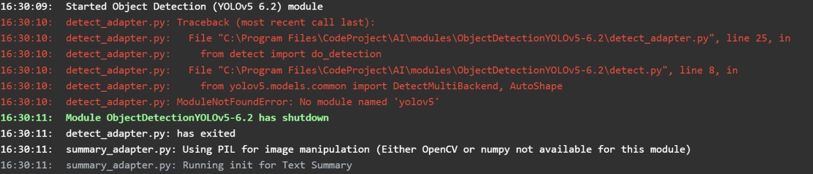

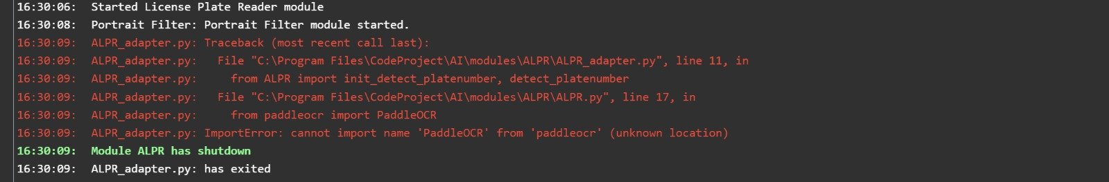

16:30:09:ALPR_adapter.py: Traceback (most recent call last):
16:30:09:ALPR_adapter.py: File "C:\Program Files\CodeProject\AI\modules\ALPR\ALPR_adapter.py", line 11, in
16:30:09:ALPR_adapter.py: from ALPR import init_detect_platenumber, detect_platenumber
16:30:09:ALPR_adapter.py: File "C:\Program Files\CodeProject\AI\modules\ALPR\ALPR.py", line 17, in
16:30:09:ALPR_adapter.py: from paddleocr import PaddleOCR
16:30:09:ALPR_adapter.py: ImportError: cannot import name 'PaddleOCR' from 'paddleocr' (unknown location)
16:30:09:Module ALPR has shutdown
16:30:09:ALPR_adapter.py: has exited

16:30:10:detect_adapter.py: Traceback (most recent call last):
16:30:10:detect_adapter.py: File "C:\Program Files\CodeProject\AI\modules\ObjectDetectionYOLOv5-6.2\detect_adapter.py", line 25, in
16:30:10:detect_adapter.py: from detect import do_detection
16:30:10:detect_adapter.py: File "C:\Program Files\CodeProject\AI\modules\ObjectDetectionYOLOv5-6.2\detect.py", line 8, in
16:30:10:detect_adapter.py: from yolov5.models.common import DetectMultiBackend, AutoShape

16:30:06:Started License Plate Reader module
16:30:08:Portrait Filter: Portrait Filter module started.
16:30:10:detect_adapter.py: ModuleNotFoundError: No module named 'yolov5'
16:30:11:Module ObjectDetectionYOLOv5-6.2 has shutdown
16:30:11:detect_adapter.py: has exited
