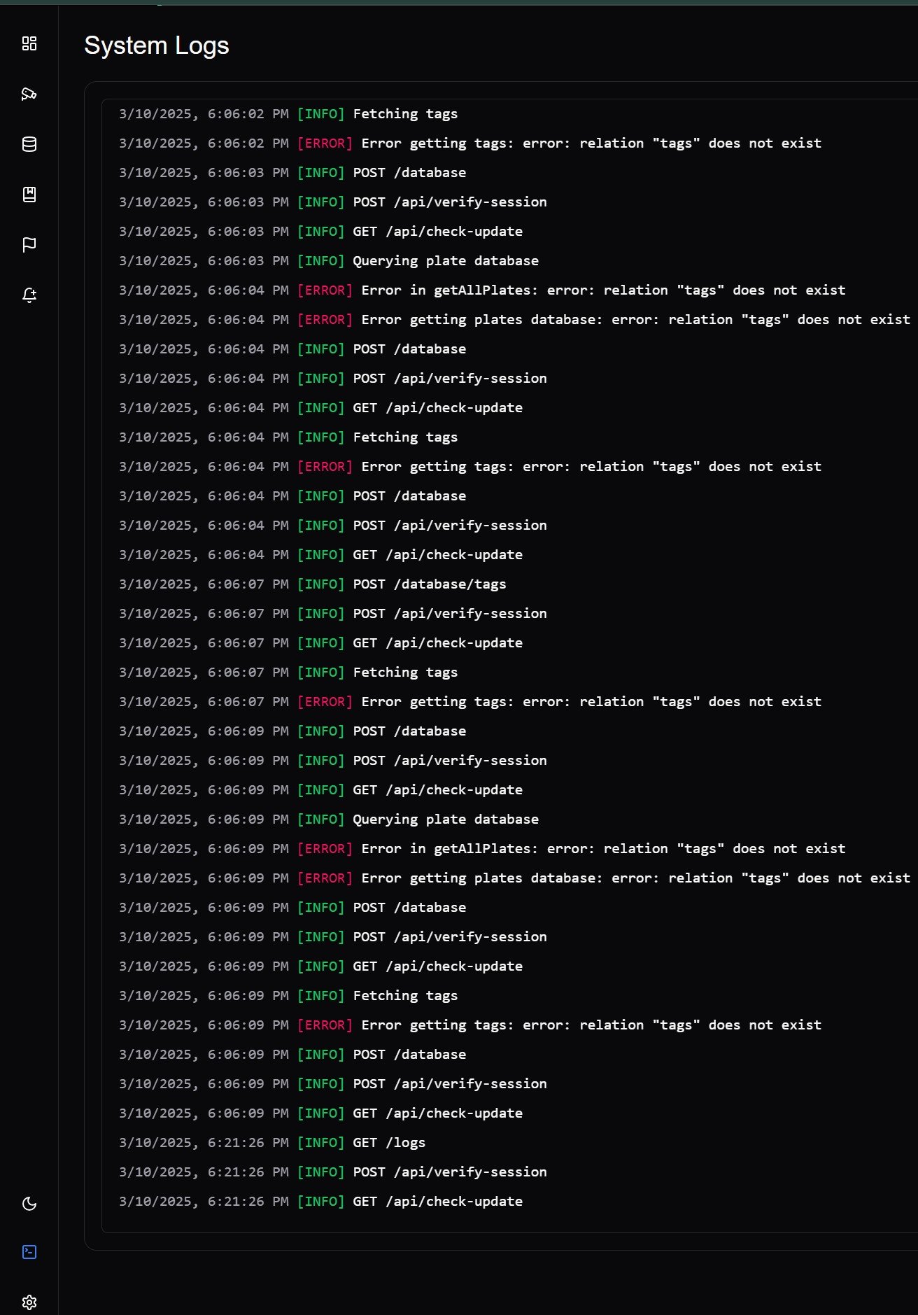

I re-copied the key and that should be good. Here's a screen shot of the data base I think you're refering to. Doesn't look good.
1) How about the ALPR Sytem Logs?
2) Also where/how is the db being hosted?
BI, CodeProject, ALPR are all on the same machine. Found the log, here's what it looks like:
You may need to run the migration first to get it running like I did based upon some of the error messages. I'm just guessing here.

It looks like you don't have the latest database schema. Can you try running the update.ps1 Powershell script and following the prompts?
Not sure how to do that. Do I open up the Powershell command prompt and simply type "update.ps1" and hit enter?

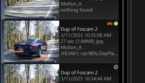

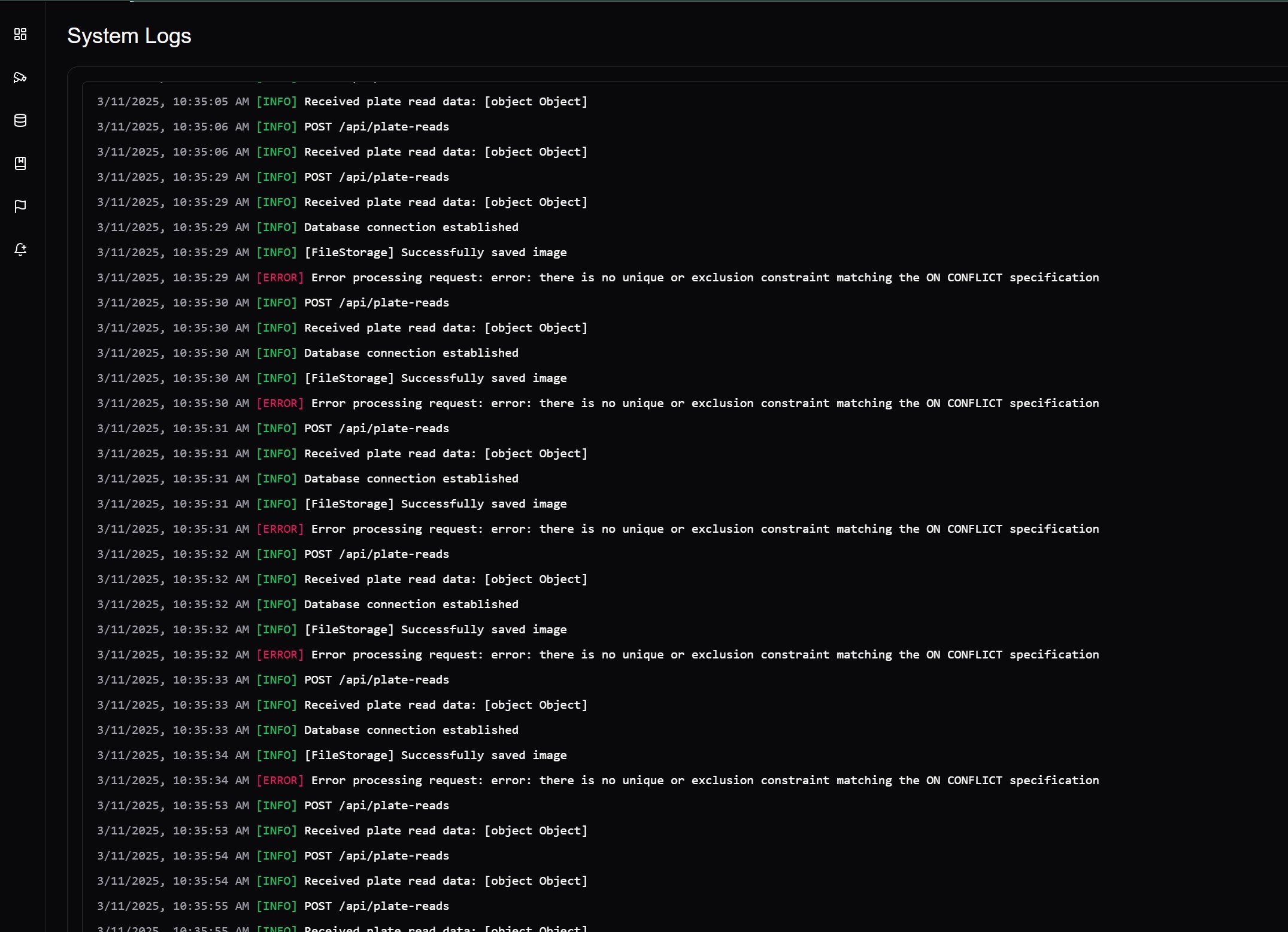

OK, so I methodically reinstalled Dockers Desktop for windows and ALPR Database per Algertc's installation procedure this morning. Here are two captures to review. One is of CodeProject capturing the plate and the other is of the log entry just as ALPR Database was trying to process it. Does this offer any clues?

The log indicates that you are successfully calling the DB API when BI alerts on a plate. And it looks like the image is saved successfully, but then the rest of the plate read data doesn't save correctly. Can you post the complete text of your post/payload from the "On Alert" that makes the http/API call?
