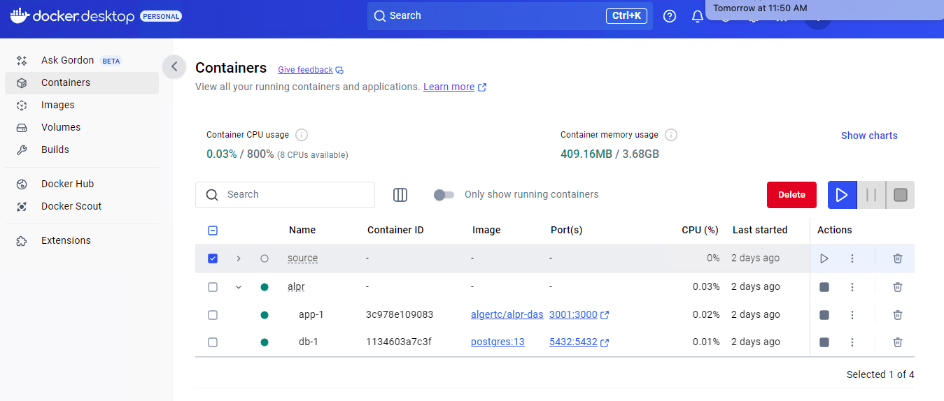

Looks like this-
Hmmm.... it looks like your containers are running. If you click on where it says app-1 and db-1 it should open up a window with six diagnostic tabs. I would look through the logs and stats tabs to see if there is anything that stands out and gives you an indication of what could be wrong.
