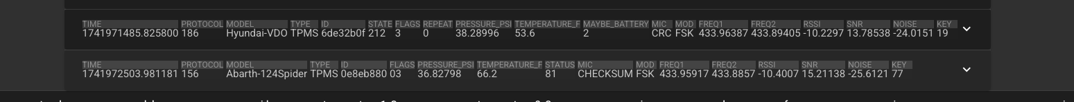

Ok- last night I was telling my wife how a bunch of nerds on this forum were trying to read tire pressure data off of the cars on the street in addition to the plates. We had a good laugh making fun of you all....
Now, I just installed rtl_433 on my SDR raspberry Pi and I am now reading some Hyundai TPMS on my street. My neighbor has one but I don't even see it in their driveway.

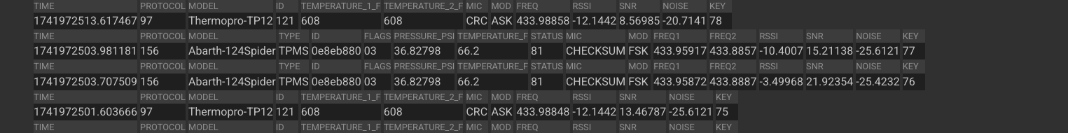

Apparently, one of my neighbors has a ThermoPro meat thermometer as well!

No.. I managed to see two cars at one point... I see just my neighbors thermopro TP12 meat temperature monitor. I switched to the 915 MHz and I see my weather stations....

I am about 80 feet from that park of the house with the antenna high up in the attic. The Hyundai that was showing up-- I have to imagine that was parked somewhere. I live in a town with 2 acre zoning so it isn't like we are on top of each other.
What's the transmission frequency from TPMS while the vehicle is in motion? From the screenshot, looks like once every 5-10 sec?
It had to be around 433 Mhz.... Are you talking about the transmission period? I am not sure.
I am not capturing every car-- that is for sure. I have not see our car.
