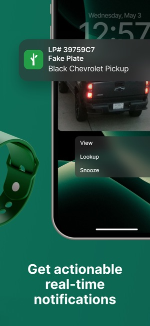

An HOA near me has a $5,000/yr subscription to a company called Flock Safety for 2 ALPR cameras on their little private road. I was looking at the Flock app (which actually looks very cool. Might take some inspiration from it) and it seems like they figured out some way to do it:
Marketing content, so I'm not sure how accurate their fake plate detection actually is, but interesting nonetheless to see it advertised.
On the topic of detecting fake plates:

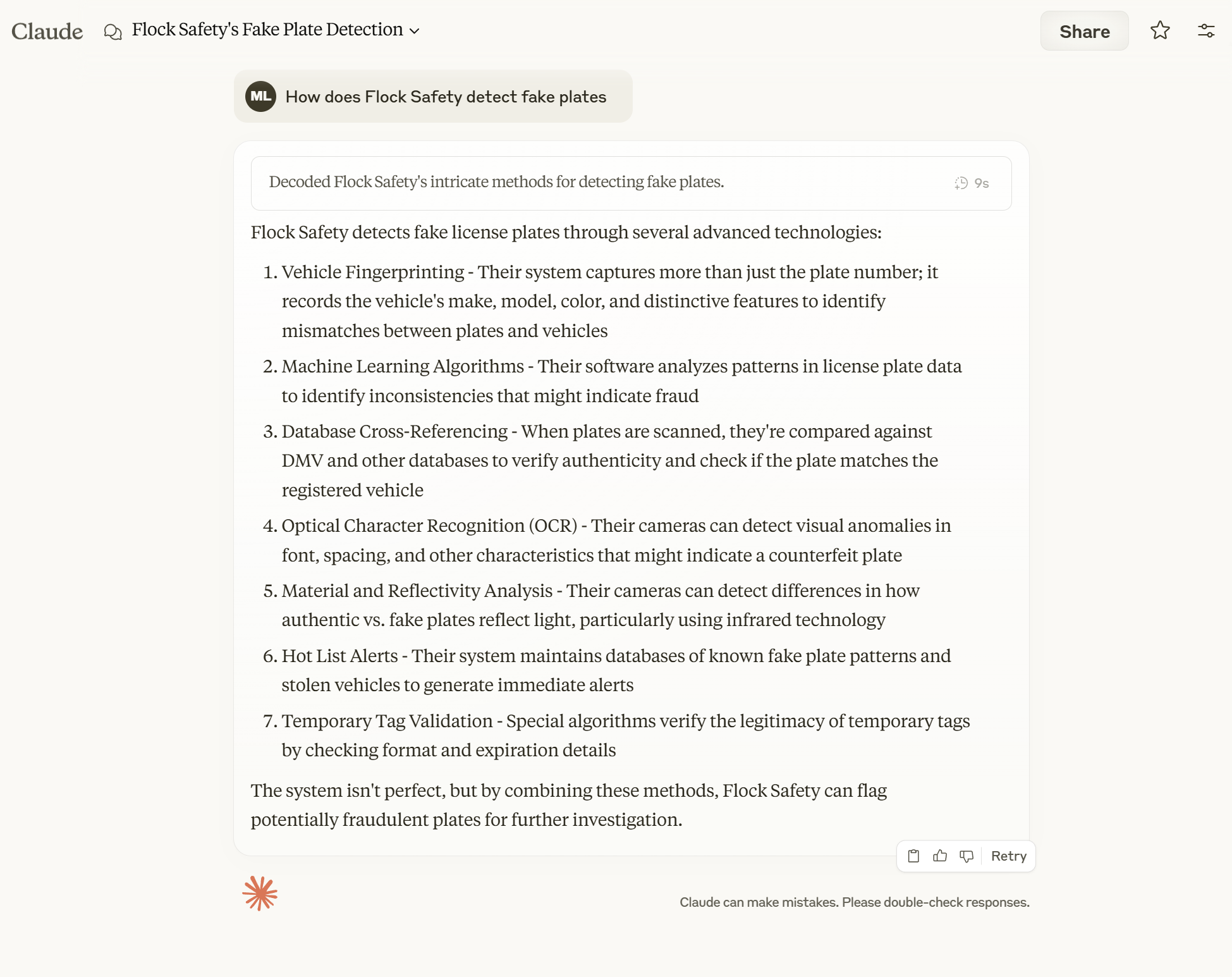

Yeah we have talked about Flock before here - pricey LOL. I would think they are running VINs based on plates and if the vehicle doesn't match, the Fake Plate comes up.

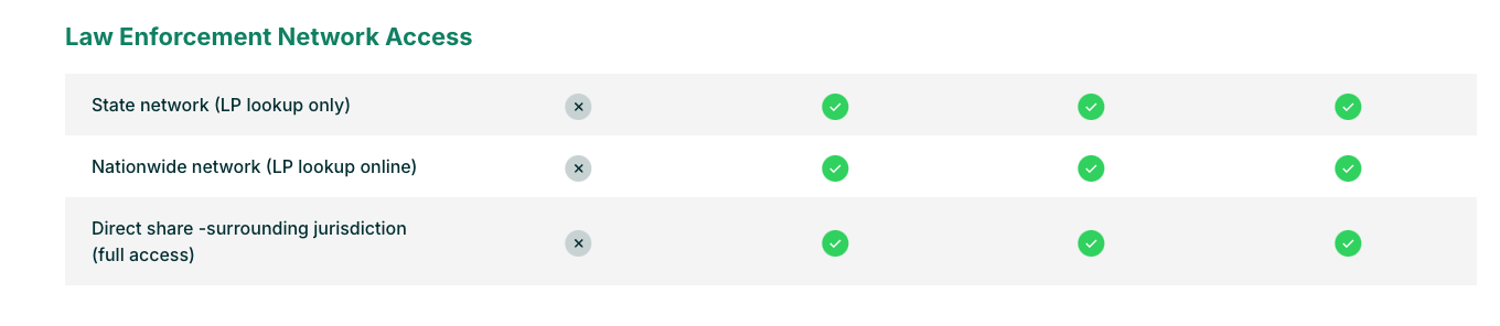

Ahhh, you're totally right. I just saw the below on their website which suggests that they're offering DMV lookup access to private businesses???? Do you know if that's true?
I might try to add amber alert integration if it's not too hard.
I have looked into this before and only government and insurance companies can gain that access. I would be shocked if Flock allows a private business access to the owner information.
