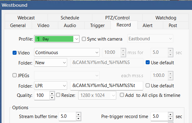

Not sure what 'No Stream' indicates - maybe that's my issue? I'm thinking this means the web request (which I don't see in my BI logs) is not working, even though images are being sent to ALPR. The docs mention this:
So I reduced to 50% quality and size to 640 x 480, but still getting the same message.
Same error message in ALPR:
Fresh install on different OS/physical machine:
You don't need to use this option unless you want to save a jpeg file to your PC. Here's what I'm using...
Just doing that for now so I can drop them in the AI tool to see what it see's. I found it interesting that only the trigger zone part of the image is sent to AI. As a tuning later, I was wondering if it can be setup with two zones, one for detection and a larger area that gets sent to the AI. I'll try unchecking it for now to see if it makes any difference
No stream typically means there's a network issue.
That was my first thought, but it all looks okay and is using the same switch as other cameras. But I don't think it's related to this issue since the no stream appears exactly after each attempt to send data to ALPR.
