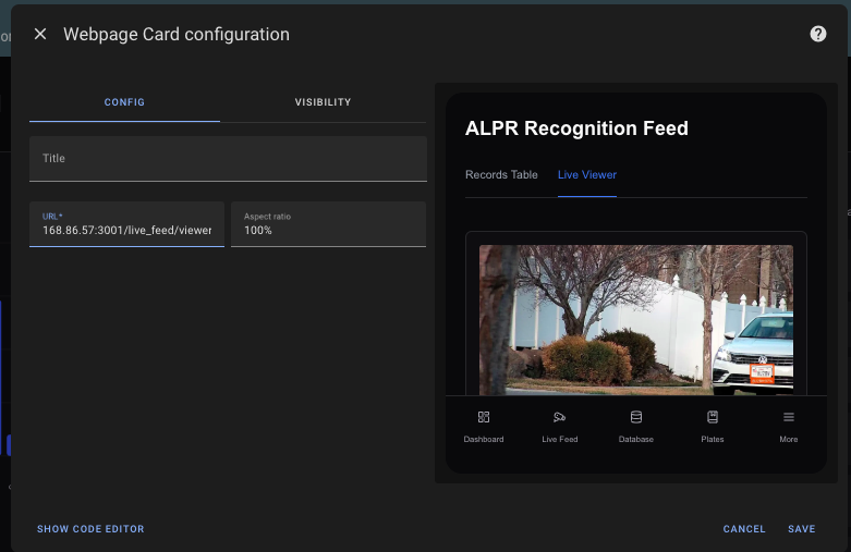

However, it looks like bypass authentication via iframe/ Home Assistant doesn't work any more.
Am I the only one experiencing this issue with allowing access via iframe from Home Assistant?

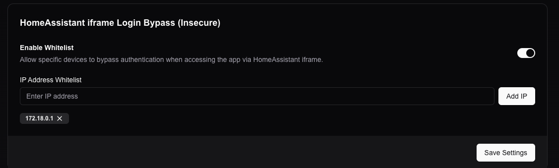

Add the ip address of your docker container to the whitelist in the ALPR Database app and it will allow iframe access in home assistant.

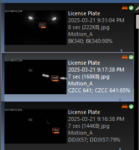

Anyone getting any plate reads below confidence threshold? My threshold is around 70%, but once in a while, I am seeing these show up with v0.18, which I wasn't getting before:
And a little more weirdness:
The reading of 8XBZ466 has the image of the vehicle above (9MOA506).
Here is another one:
On the BI side, which correctly marks it as a no read because the confidence is below threshold:
I am seeing this on multiple version of BI, both 5.9.9.24 and 5.9.9.29, .24 pre-dates the AI hardening code.
Yep, it works both as a dashboard or a web page card.
I figured it out! It’s not the IP address of the HA Docker that needs to be added to the whitelist, but the IP of the device you're accessing HA from. The reason it suddenly stopped working for me (which I initially thought was due to the 0.1.8 update) was actually a coincidence with the update: my device's dynamic IP had changed.

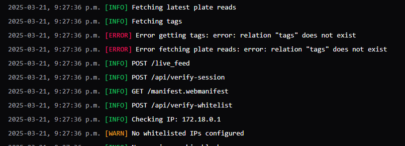

I also see this odd reference to 172.18.0.1 IP address and reference that relation 'tags' does not exist:

2025-03-21 17:33:11 Error getting tags: error: relation "tags" does not exist

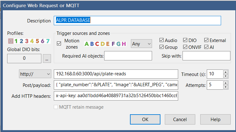

Alert Macro:
Post string: { "plate_number":"&PLATE", "Image":"&ALERT_JPEG", "camera":"&CAM", "ALERT_PATH": "&ALERT_PATH", "ALERT_CLIP": "&ALERT_CLIP", "timestamp":"&ALERT_TIME" }

Check your settings on the dashboard under Home Assistant for the whitelisted IP, maybe you have that enabled.

Sounds like a DB schema issue again. Try the solution presented in post 660
Thoughts where I've gone wrong?
Your Post/payload string is wrong. It should be: { "ai_dump":&JSON, "Image":"&ALERT_JPEG", "camera":"&CAM", "ALERT_PATH": "&ALERT_PATH", "ALERT_CLIP": "&ALERT_CLIP", "timestamp":"&ALERT_TIME" }

Did you do the rest of the steps including the docker compose statements at the end of that post?
ok - I had used the one on the GitHub instructions. I've changed it to the one above, the log messages looks about the same other than I don't see the plate details in it. I'm assuming it's in the ai_dump. Still, the results are the same.
