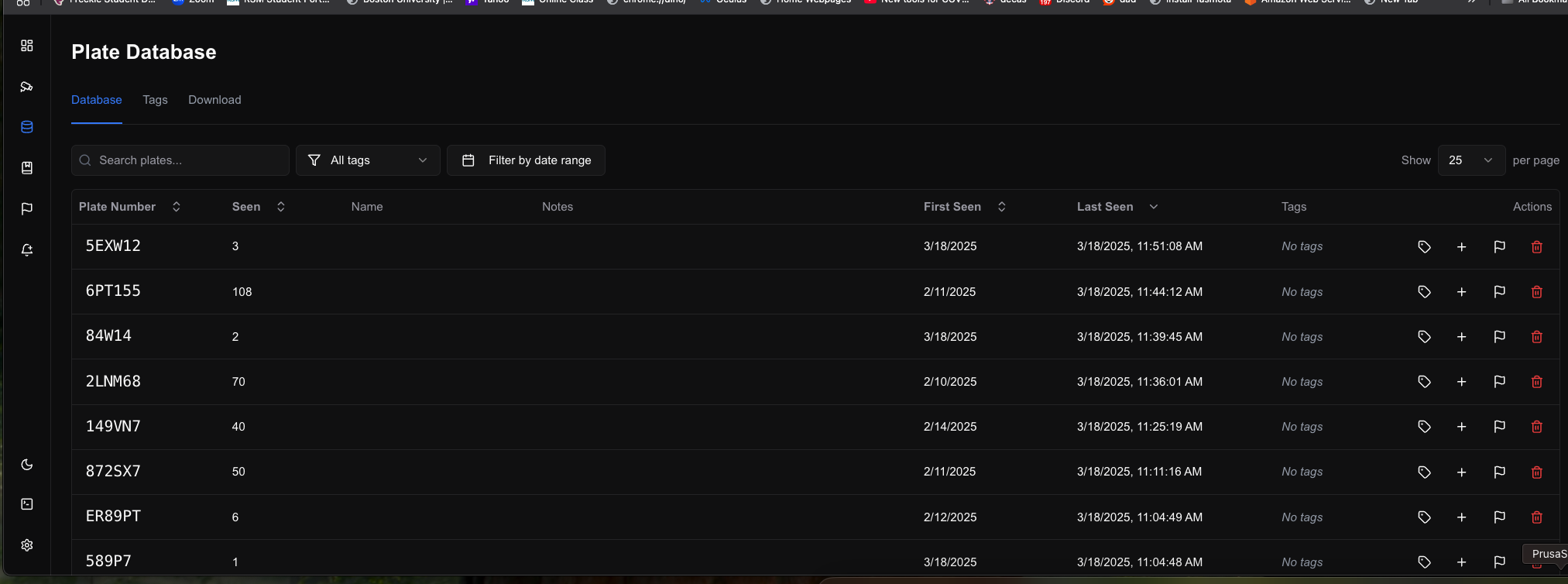

Yes it checks periodically and then if there are at least 500 plates with the necessary annotation data, it will build and send a training set. I’ll post a pic of what it looks like.

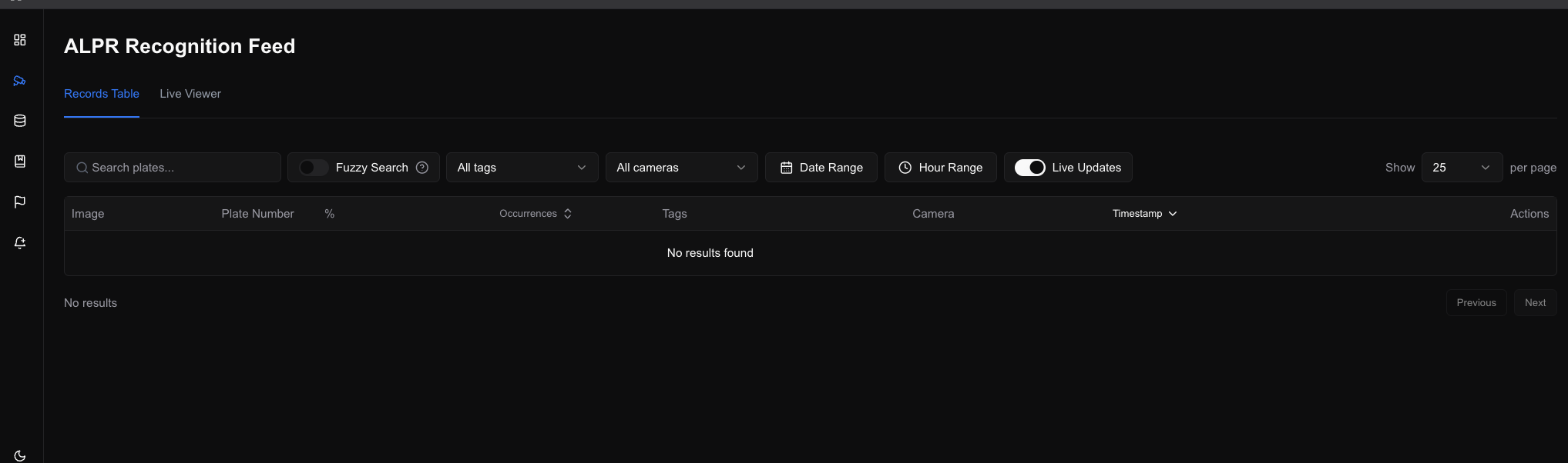

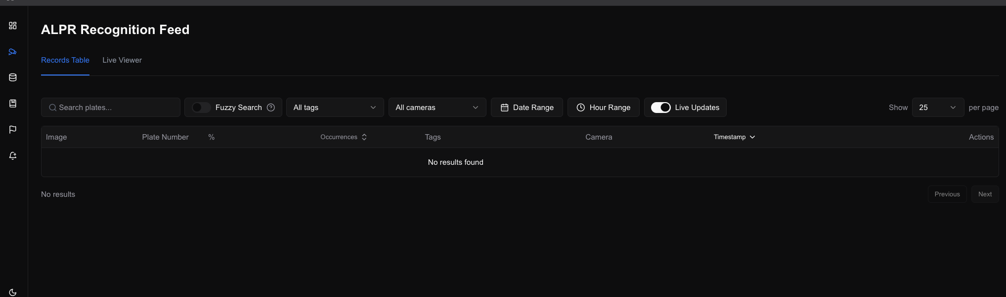

I see the old plates.. Do I need to to get a new SQL file?

3/18/2025, 6:15:10 PM [ERROR] Error fetching plate reads: error: column pr.crop_coordinates does not exist

3/18/2025, 6:15:12 PM [ERROR] Error processing request: error: column "confidence" of relation "plate_reads" does not exist

Working great..... I have two Blue Iris instances of my LPR camera. Each with slightly different triggers. On it just a motion-- and another is a zone crossing in order to capture direction. Both are reporting as on occasion one or the other seems to miss..
