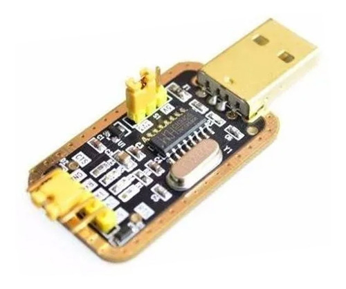

Hello.
You will need open the camera e use the UART port to flash the firmware directaly to the chip
The chip in your camera (same mine) is this (look the P5 port):
Many informations here
You will need something like this to insert the firmware on the chip
about TFTP, maybe this is usefull
In the TTL-RS232-USB not conect the VCC pin. Is necessary only the TX, RX and GND (The VCC will be provided by the camera when you turn on it)
Something like this (look the gadget on USB - this image shows other board - do not look the board on this image)
This site has many informations usefull (use google translator)
You will need read a lot of foruns until feel safety to try this procedure.
If you have any question, i can try help you when a have a free time
