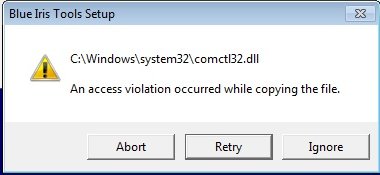

@Mike I installed and registered BI5 on a Win 7 Home 64bit that had BI4 but I removed BI4 first via the Control Panel.
BI5 running great, no issues, errors, etc. upon install or run.
However, attempting to install BIT v1.5.0 yielded the following error:
EDIT: BIT v1.3.2 did the same.
Reactions: Mike
@TonyR you don't happen to have Homeseer running or another program using that file ? Seen this with Homeseer....close it and then install BIT.
That's a negative, but thanks any way....:(
Just click ignore.

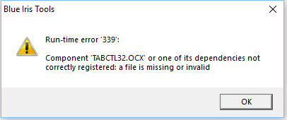

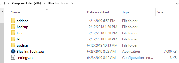

I wasn't sure if I needed to uninstall BIT first or not, I ended up uninstalling BIT, however the below files were still on my computer. I tried saving the Blue Iris Tools.exe file to that folder and still get the same error.
I tried installing the older version again but it gives me different errors when I try that.
If you uninstalled then you need to reinstall BIT. I will push an update soon so you make sure auto-update is on in BIT and you'll be set.
You need to put Blue Iris Tools.exe in your BIT folder, overwriting your current BIT. I forgot to mention this above.
I deleted all of the folders from the directory above and was able to get BIT v1.1.2 to install and then replaced the Blue Iris Tools.exe file, then restarted the computer and I still get the Error#0 popup.
Shoot me a PM with UltraViewer (ultraviewer.net) credentials so I can remote in and check it out.
Edit: Helped @The Profit out remotely...It was permission errors on the PC. Basically just launched BIT as an Admin and it fixed the issue.
Just click ignore.

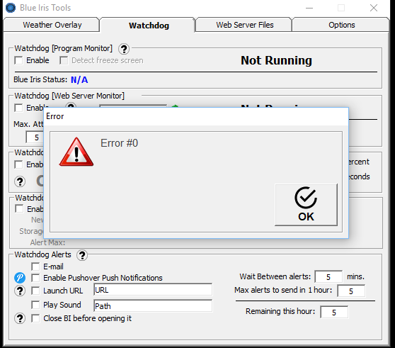

Is anyone still having issues with Error #0 when BIT watchdog detects BI5 is not running? I've read from page 34 and tried to manually point to files via settings. If BI running when I select Watchdog in BIT then I get Error#0 shortly after. Tried fresh installs of BIT, manually downloading V1.32 and moving BIT 1.5 exe into the folder but still no joy. Currently on BIT 1.5 from 24/6/19 with no update available and BI 5.0.0.64. Anyone got any other potential solutions.
yess i have te same problem
