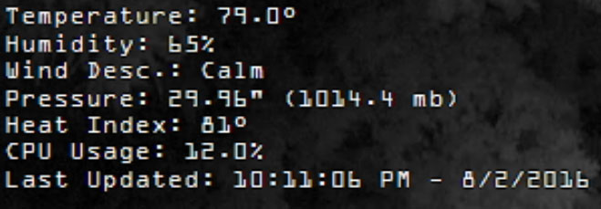

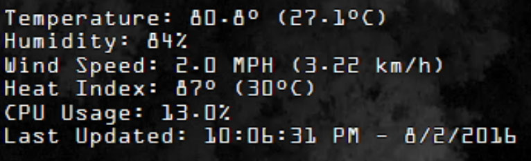

Here are a few examples of the weather on your video feeds. You can select which conditions to show, what units to display and more.
View attachment 38287 View attachment 38288 View attachment 38289

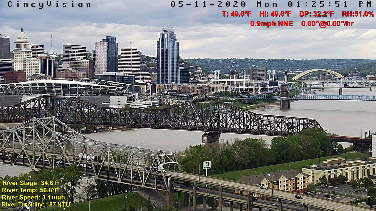

Thanks so much for the tip! Now that I know that, I was able to create as many macros as I needed! I did it directly in the registry.
I put together a Python script that grabs Ohio River conditions data from a website and writes them to text files. I then created a Blue Iris Tools add-on that runs that script every time Blue Iris Tools retrieves the weather. So now I can have all the weather and river conditions info on my IP camera overlay.
You're welcome.
I do something similar with PHP scripts. Example below.
Great view of the river! Long shot, but any chance you have video from the flyover for the Reds Opening Day last year on 3/28?
Thanks! Just so happens I do: Too hard to use the PTZ to follow flyovers, so that's recorded from my phone.
Here's another one that was better from a Bengal's game in 2015
I have lots of river time lapses, flyovers, river incidents, accidents on the Brent Spence bridge on my YouTube channel Aaron Preslin if you are from or have ties to Cincy Aaron Preslin I usually Tweet them out too Aaron Preslin (@apreslin) | Twitter when I upload them.
This forum messes around with the links you post, so sorry about the weirdness in the way the links are formattted that I posted. Can't seem to stop it from doing that.
