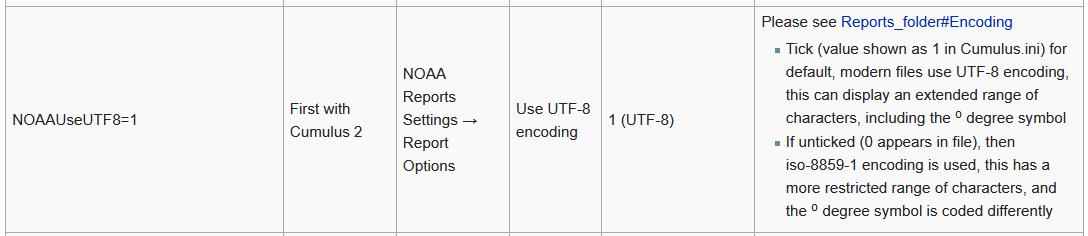

It really sounds like it has something to do with that from Cumulus.ini - Cumulus Wiki

Might also be worth a read: NOAA Reports °C not displaying correctly - Cumulus Support

I checked my Cumulus.ini file and the NOAAUseUTF8=1 option was already set to 1 (the default), which means it is using UTF-8 encoding. I also read the Cumulus wiki and tried using the "Convert to UTF-8" tool as mentioned in that thread but it didn't change the diamonds back to the degree symbol. I'm guessing that this issue is baked into the way Cumulus (or CumulusMX) processes the template files and replaces the tag with the actual weather data. Not being a programmer, I wouldn't know how to write anything that would be able to automatically post-process my text files. If it helps, I've attached both a template file and the text file that CumulusMX outputs from that template file.
