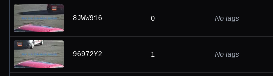

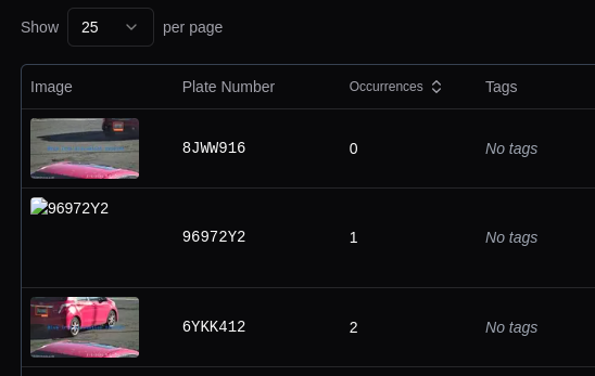

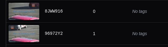

Anyone know what causes thumbnails to randomly disappear--it was there 20 mins ago. The full-size image is there, and browser refresh doesn't help.
Thanks
