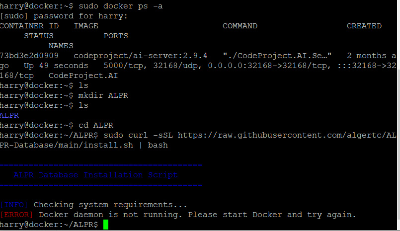

Same issue, docker daemon not detected.
I deleted my first reply because I thought you were using WSL at first.
If you're using sudo to run docker you need to give the sudo to the bash command at the end like this:
Code:
curl -sSL https://raw.githubusercontent.com/algertc/ALPR-Database/main/install.sh | sudo bash
I will update the readme and separate out the linux section to indicate that.
Code:

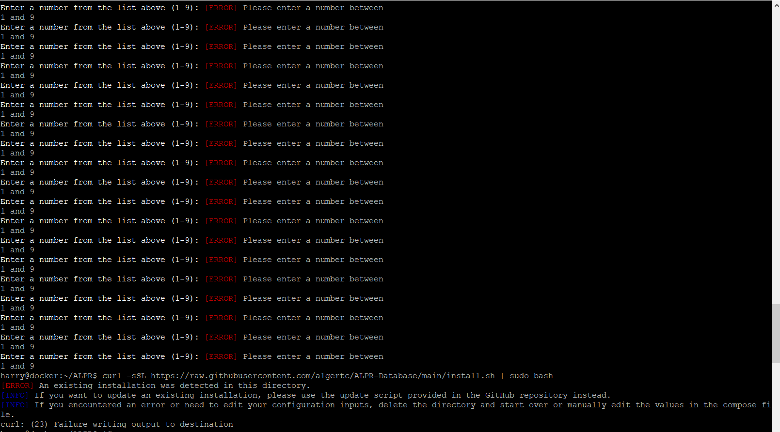

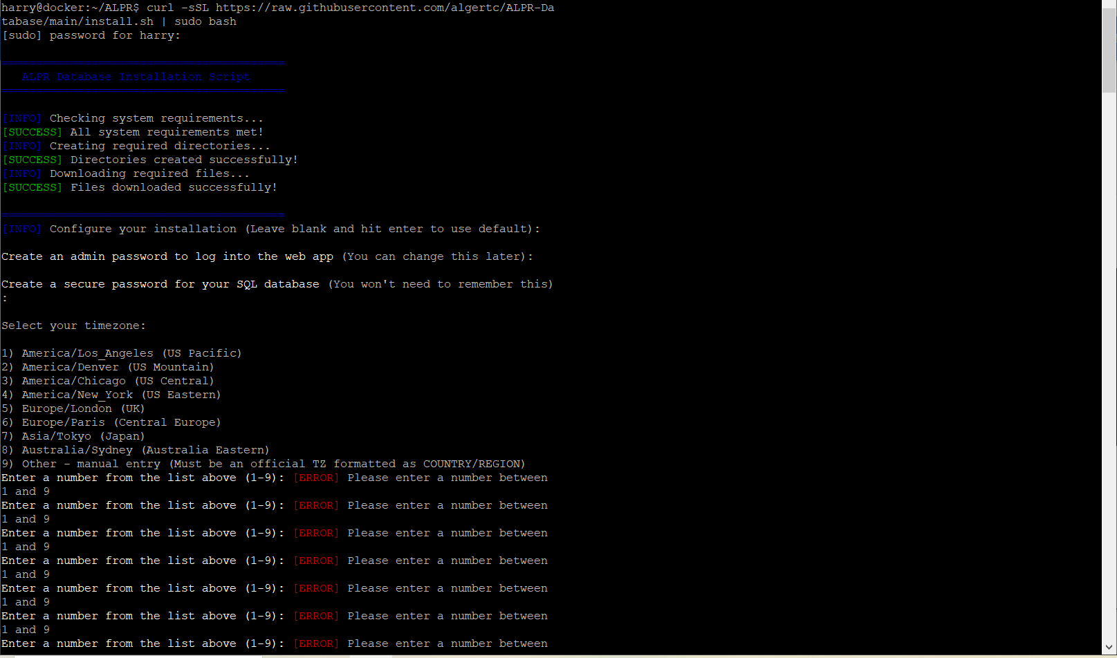

That part work, however, now I'm stuck. It asked for time zone immediately but it didn't let me answer even if I press they key continuously.
I restored from my backup, waiting for your next step.

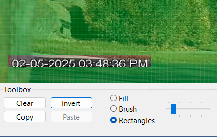

In BI under Camera settings | Trigger | Motion sensor (Configure) | Use zones and hot spot (Edit...). This only masks the area so triggers will not occur in the masked area. Your timestamp will still be included in images/video.
I thought that only controlled when BI gets triggered, and not the image(s) that BI sends to CPAI. Or does it mask the images that get sent to CPAI?
It only controls when BI gets triggered but, from your example, a snapshot is being triggered from the "PM" in your timestamp.

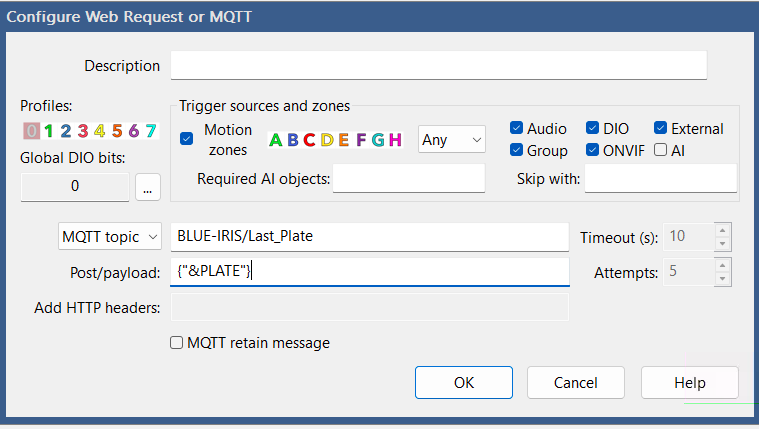

I would suggest using MQTT. If all you want to capture is a single plate you could setup a simple MQTT alert in BI using a payload of {"&PLATE"}.

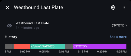

Then create a sensor in your config.yaml file
Code:
mqtt:
   sensor:
      - name: "Westbound Last Plate"
        state_topic: "BLUE-IRIS/Last_Plate"
The sensor will then display the last plate captured.
I would suggest using MQTT. If all you want to capture is a single plate you could setup an a simple MQTT alert in BI using a payload of {"&PLATE"}.
Code:
mqtt:
   sensor:
