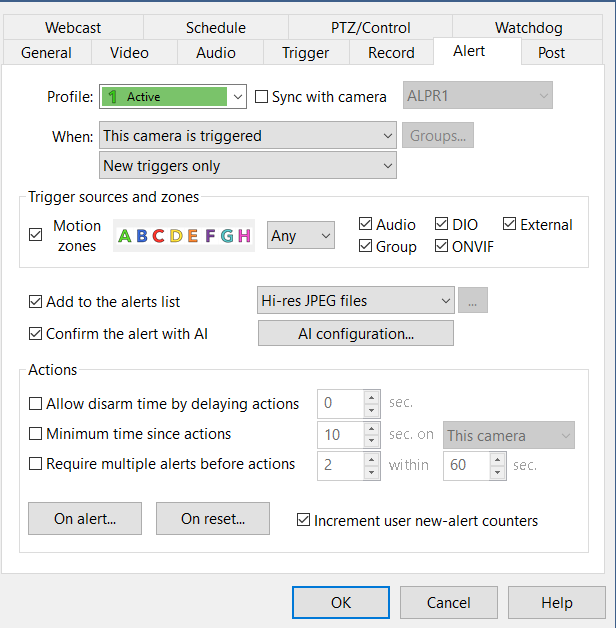

I had something like a 5 second pre-record set in BI and changes it to 2 seconds and it appears to be much better.
I am trying to iron out some issues in BI with regards to detecting the direction of the car. I cloned the camera and just set up a simple motion detect and am sending that to the ALPR database. That seems far better....
I normally set up a couple of zones and that tells me if the cars are coming or going.

I have mine at 15 seconds with no issues, so that suggests that it is caused by the zone configuration if that is the only difference. I have my motion detect looking at the whole image with no zones and using the simple algorithm.
Apologies if any of that is obvious. I'm def not a BI expert. I just leave what I have as it is and it works well enough for me.

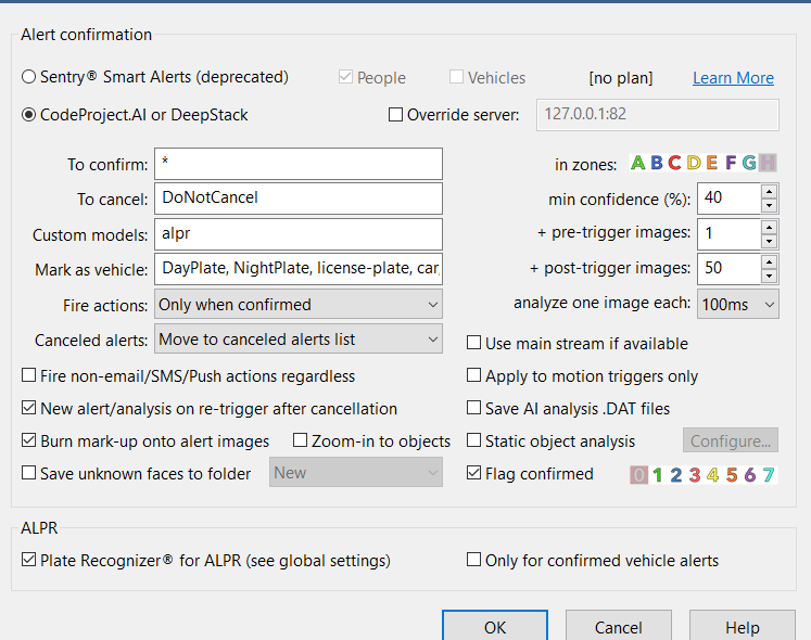

I’m noticing the same thing, and I believe it's because BI saves the trigger image rather than the AI-confirmed image in the database. As a result, the motion trigger image is what BI sends to the app when using "&ALERT_JPEG."
I’ll reach out to Ken @BI to clarify whether this is intentional, a bug, or a potential feature request.

My &ALERT_JPEGs are the correct plate image with this setup:
View attachment 214231View attachment 214232
You're probably just not noticing it because it depends on the motion detection setup, lighting conditions, and the camera's field of view.
At first glance, it seems to work correctly in 90-95% of cases for me as well. However, I mostly encounter issues at night when car headlights are triggering motion before the actual car would be in the field of view of the LPR camera, causing BI to start sending images to CPAI for license plate recognition.
So in dark, the initial images often only capture the headlights, so to mitigate this, I had to increase the number of post-trigger images in the AI configuration. This ensures that enough images are generated and sent to CPAI until the car fully enters the camera's field of view. The required time and number of images depend on the vehicle's speed (how long it takes to arrive after the headlights have already triggered motion detection).
However, the problem with BI is that instead of sending the confirmed image from CPAI, it sends the initial motion-triggering image with &ALERT_JPEG, which only shows the headlights.
You can easily check/ compare with your setup if the AI confirmed image is the same or not then the image what is sent via &ALERT_JPEG. Most probably there will be differences, but in daytime the difference is so small that it's not noticeable and doesn't matter.
