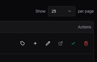

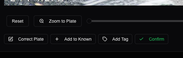

But as far as I understand, all recognitions (both correct and incorrect) are currently uploaded automatically immediately after injection.
Added manual confirmation also. Correcting a plate will also set confirmed to true.
The resulting training data will be organized into two categories: validated, unvalidated. That should be more accurate.
