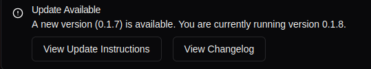

Alright that's in the latest image now and I modified the data preparation and verified it's correct in the cloud. It's gonna show the update message because the versions don't match, but you can just close the alert. I'll make the release soon.
I updated again to get the confirmation feature, looks like that confused the update script.
Reactions: wpiman
Does this latest version show the version info somewhere? I'm not finding it
I never got to displaying the version, but as Pete’s post shows, if it’s anything other than whenever is newest on GitHub, it will tell you. I haven’t created the release for 1.8 yet, but the current newest container is ready and has the version number 1.8 inside of it. It’s just not like official yet if that makes sense.

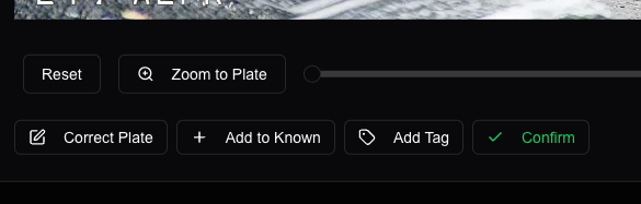

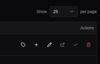

Added manual confirmation also. Correcting a plate will also set confirmed to true.
The resulting training data will be organized into two categories: validated, unvalidated. That should be more accurate.
View attachment 216982View attachment 216983
It worked the first time, but the next plate that gets corrected does not flip the confirm bit. I can flip it manually, tho.
Awesome! Thank you Charlie!
Two questions:
1) When the training sets get uploaded? Is it like the the non-confirmed sets are uploaded immediately after injections and the confirmed ones when they get confirmed?
2) Correcting a plate doesn't set confirmation flag true for me. Is this only me?
On the correct it happens in the background, so it won't illuminate immediately. If you refresh the page it should show it. I'll try to make it instant. it should still be changing it though.
Two questions:
1) Checked every 500 plates. it is all uploaded. They're just separated into two folders.
2) See #794
2) See #794
1) I’m not sure what you mean by this. Are you saying it waits until there are 500 unuploaded recognitions before uploading them all at once?
2) The flag doesn’t light up for me, even after refreshing the page.
What happens if you try the correct button in the viewer when you click on the image? It seems to work for me but I’ll have a look later.
Yes it checks periodically and then if there are at least 500 plates with the necessary annotation data, it will build and send a training set. I’ll post a pic of what it looks like.
