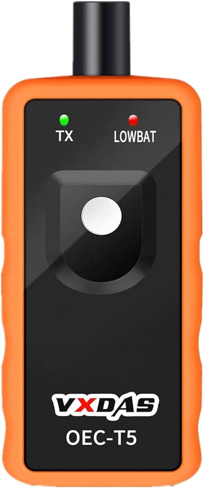

Devices like below can "wake up" a sensor by transmitting something very close to the sensor. That means that it's possible to do it from farther away with more power. This might be worth exploring if it could narrow down the zone we expect vehicles to be in when we receive the data.
