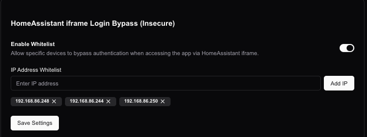

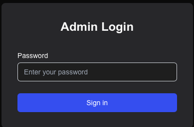

Thanks for the update! Unfortunately, this still doesn’t work inside of Home Assistant. Maybe I’m doing something wrong but I added the IP addresses of the devices to the whitelist and it is still asking for login credentials.
UGH. iframe hell. Really thought that was going to do it.
Do you access your HA through a reverse proxy or something? That's the only thing I can think of. I tested it with multiple devices in a bunch of different configurations, and it worked on my network. I'm guessing you already tested those other devices, but please do if you haven't. If not reverse proxy, I'll have to PM you some logs to add for debugging because I honestly have no idea otherwise.
I’m not using a reverse proxy and I have tried this on multiple devices (MacBook, iPhone, iPad). In your test environment how did you install HA?

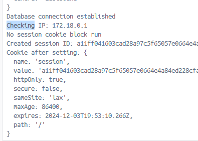

What does it say in the server logs in the container if you navigate to your HA dashboard and reload the page? It should print something like "checking IP: <IP>". If something is wrong, it should print a warning on another line near that explaining what's wrong.
I just used the HA docker image and clicked "add webpage" then put in the URL. I was able to access the ALPR database as an iframe on the dashboard without logging in on my phone, my laptop, and desktop.
The way the images are stored right now is pretty terrible. They are just dumped directly into the database as base64 text which was a lazy solution that I used originally to get things going and have not changed, but definitely need to. How many records do you have in your live feed (plate_reads) table? It shouldn't be too slow even with minimal hardware. I have 3000 currently, and it's fairly speedy. The pagination should handle this pretty effectively. If it's unusably slow, check the size of the images you are sending. I have mine set to a pretty low resolution at 50% quality. Reworking this will be next up.
Is this what you’re looking for? I assume 172.18.0.1 is a proxy connection test.

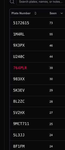

How many records do you have in your live feed (plate_reads) table? It shouldn't be too slow even with minimal hardware. I have 3000 currently, and it's fairly speedy.one
Not sure on the total number, but I have over 4350 unique plates with the top one seen 73 times.

Is this what you’re looking for? I assume 172.18.01 is a proxy connection test.
The IP comes from the x forwarded for header which should be the IP of the device you are browsing from. That seems like a docker IP, which is confusing. Does that 172 address look familiar at all?
Can you confirm: the iframe setup (what address you have it connecting to), the address that you use to hit your HA dashboard, and how your HA is deployed?
This suggests there's an extra hop somewhere along the way.

I’m running HAOS on a baremetal BMAX x86 mini-pc. Everything on my network is 192.168.86.0/24 so I’m not sure where the 172.18.0.1 is coming from.

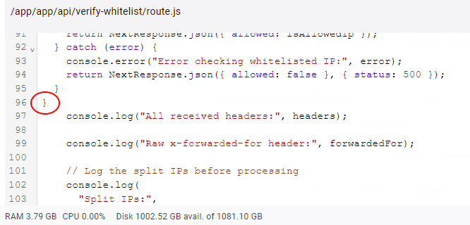

I created a branch called iframe in the repo and added some extra logs on lines 91-99 of file:/app/api/verify-whitelist/route.js. If you are able, please see if you can edit the file directly in the docker container to add those lines.
Link: File on Iframe branch
