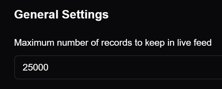

Thanks for this update! With over 11,000 records in my database this version loads almost instantaneously.
I top you with almost 25k of records.

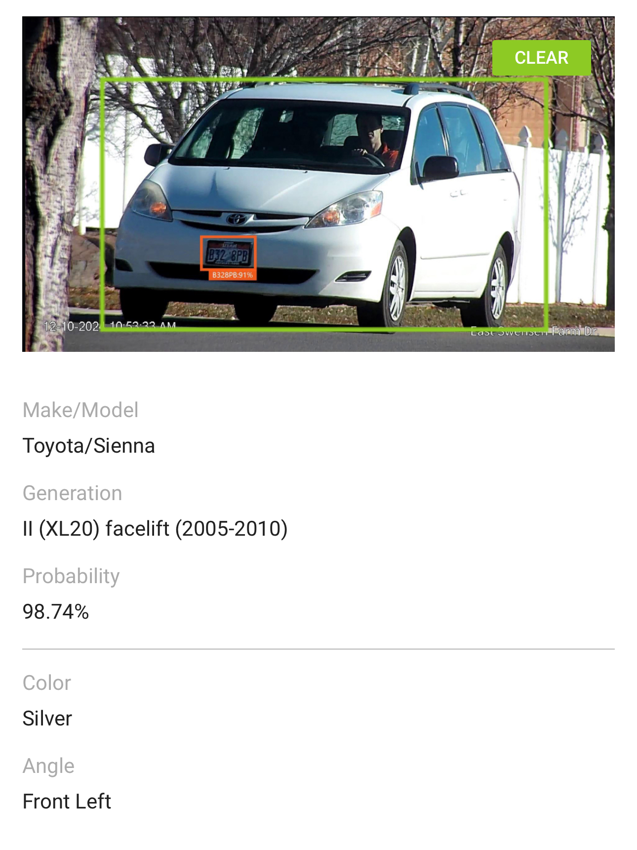

Using generative AI to capture the make/model/color during daylight hours would also be an awesome addition. Something like this:

Interesting ok that would be really nice to have if it worked well.
It would be nice to incorporate something like this into your app as an option. You could add an analyze with AI option button on your image page.
What I’d really like to do is have it come from codeproject with everything else or be automated in some other fashion for people who may want to use a paid service. The paid option I’d be open to adding an application side integration since CP isn’t really an option.

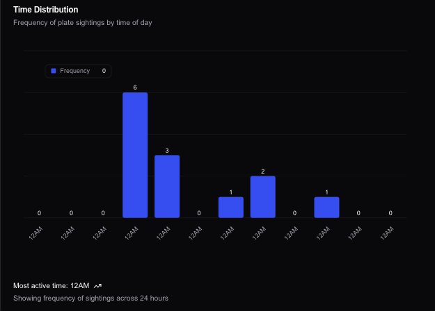

@algertc, I just noticed that your last update seems to have broken the time distribution chart. All columns are listed as 12am.
