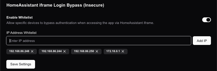

Hmmm… I applied Hikky_b’s fix and added the http: code to my config.yaml file in HA and it still didn’t work. However, I found a simple fix. I added my docker IP (172.18.0.1) to the whitelist. It now works like a charm.
I think that’s going to allow no login for every device regardless of iframe. Not 100% sure. Could you try and let me know?
Glad it’s working at least though . That didn’t even cross my mind.
Yep, no login required which is fine with me. Not sure why this needs to be secured anyway.
There are still plenty of threat vectors to the rest of your network opened by having a service completely without auth, even on your LAN with good security. There’s also the fact that there will be secrets stored for integration with other services. The pushover keys might be kind of worthless but anything for HA could be dangerous. I don’t know what else might plug in in the future, so I’m just trying to be principled and forward thinking. Like I said before, I don’t want to be the reason anyone has a problem.
I don’t have any issue with there being the functionality to manually allow all like you did. That actually turns out to be a pretty happy accident imo. Doesn’t endorse or suggest it as an option, but still gives users who understand the implications the ability to do so.
